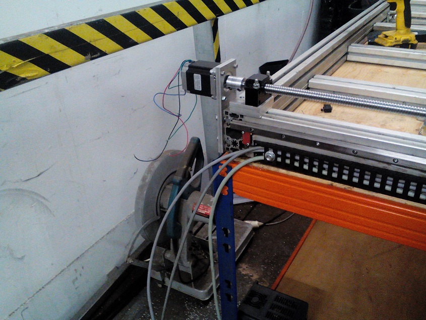

    I never tapped the extrusion I used an impact driver to force the M12 bolts into the extrusion, I used corners and T nuts to keep the extrusion straight (My frame is 9045) but the gantry I recessed the aluminium into the aluminium plates by 5mm each side (20mm thick plates) which kept the gantry straight whilst I bolted it on.

    I got the Hiwin recess wrong so I ended chopping 1.5cm off the Hiwin's which when I checked the Cad model was obviously wrong lol I must have been having a moment.
    Hiwin's are rated for 95%+ of their loading capacity when mounted sideways on this is why on my machine I mounted the Hiwin's where the ballscrew is on yours and the ballscrew when you have the hiwins.

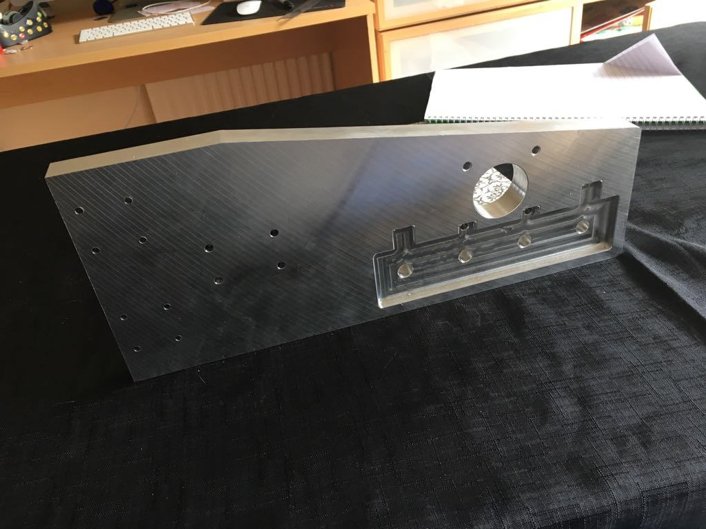

    That decision also cemented the plan for making the side plates out of 20mm aluminium plate - and I think they look reasonable. The other factor is that the milling machine is currently in storage a couple of hundred miles away, and at least I can work aluminium in my garage :D This means I'm also planning on going down the epoxy route for levelling the x-axis, and my belief is that the y axis on the ali-profile should be reasonable out of the box (?). That also allowed me to further copy Joe (thanks bud!) and start designing my motor mount locations etc.

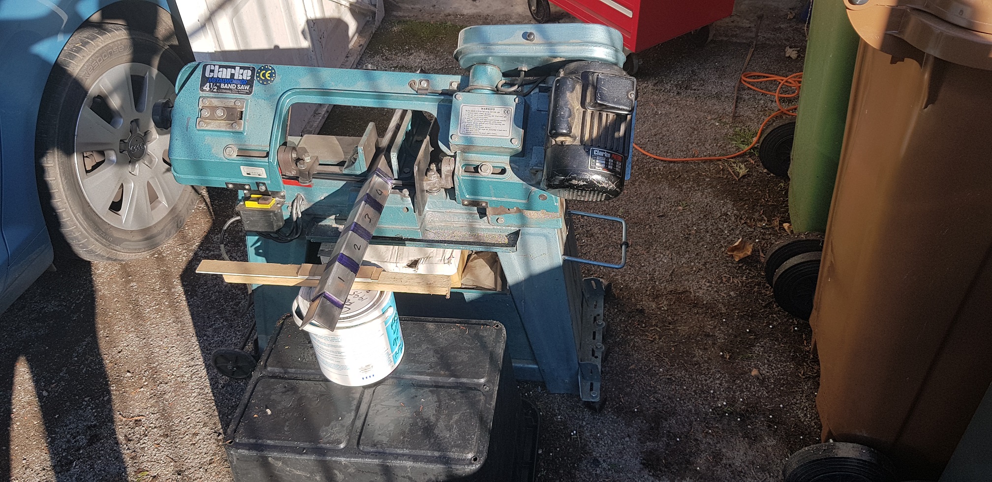

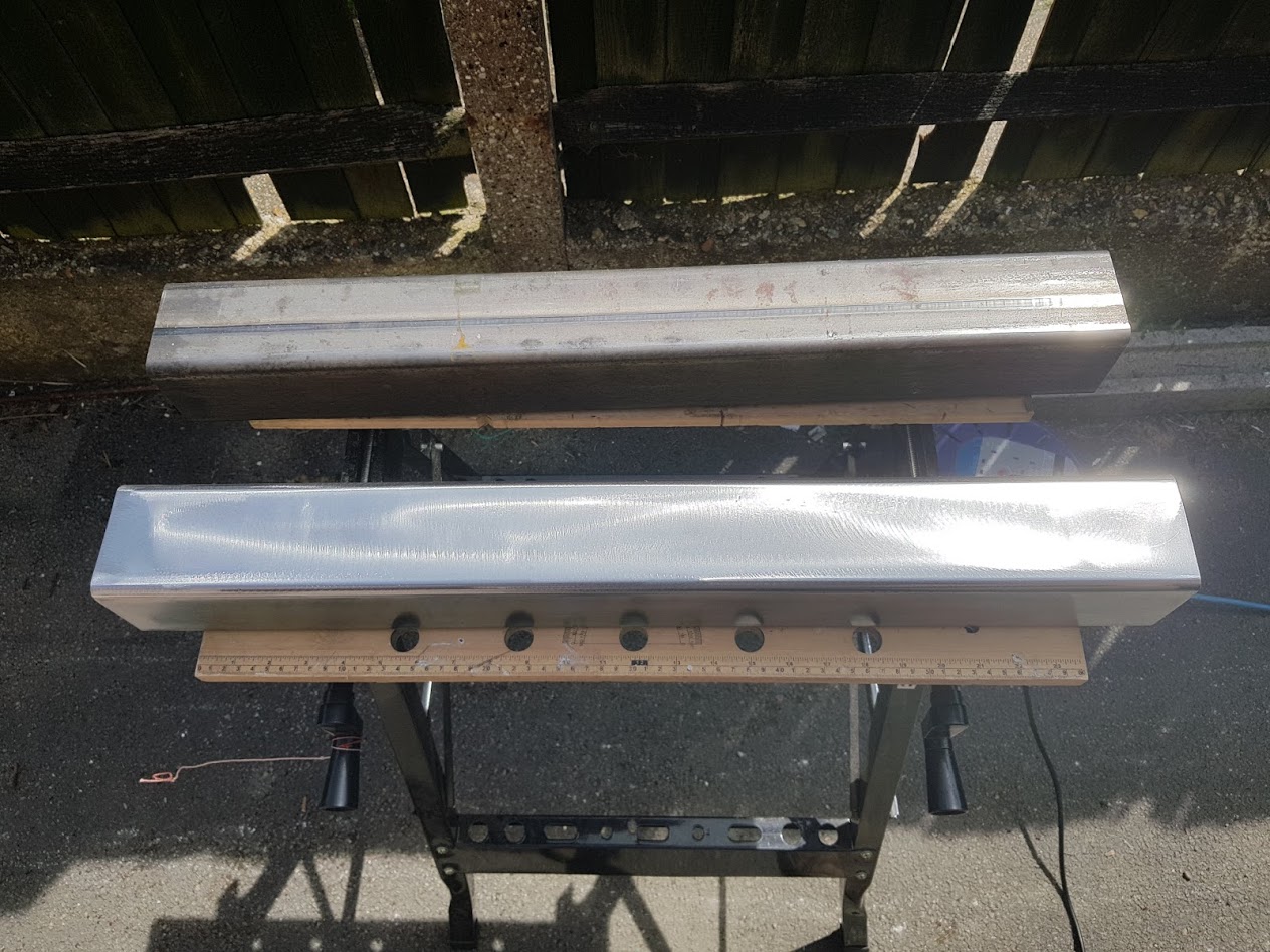

    Large steel delivery (about three hundred quid for the base frame and adjustable bed + some sizable offcuts). Lots of cutting... then lots of cleaning up the pieces to make them nice and shiny and easy to weld. At this point, also, you know, learnt to weld a bit :)

    Marking up - discovering what marking up fluid is, and then having to find my own tub! At this point I couldn't wait to layout the steel in approximate locations to give me a better idea of size (wife redacted!)

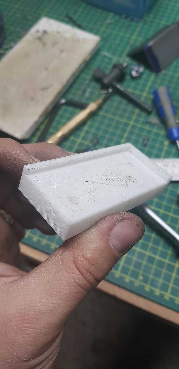

    Marking them was a bit of an onerous task, so as my wife had recently taken up 3D printing as a hobby, printed out a jig to prevent me needing to measure! Worked surprisingly well, as our off-the-shelf middle-of-the-range printer is astonishingly accurate on its dimensions. . . . . . . .
    Like that thinking! What make and model 3D printer are you using?

    Thanks Andy :) We're using a Creality CR10-S. Was printing accurately with PLA within an hour of opening the box - very pleased with it so far.

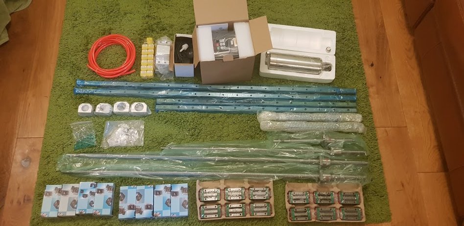

    Very exciting package just arrived!
    Still working my way through it, but all looks spot on so far. Very pleased and impressed by Fred.
    For those of you who are trying to price up your builds in the future, I think this set me back approx £1150. It includes everything you see above - all my rails, ballscrews (+bearings and mounts), and spindle, inclusive of delivery, VAT and Customs. I think it would have cost ~£2000 from a UK (re-)seller.
