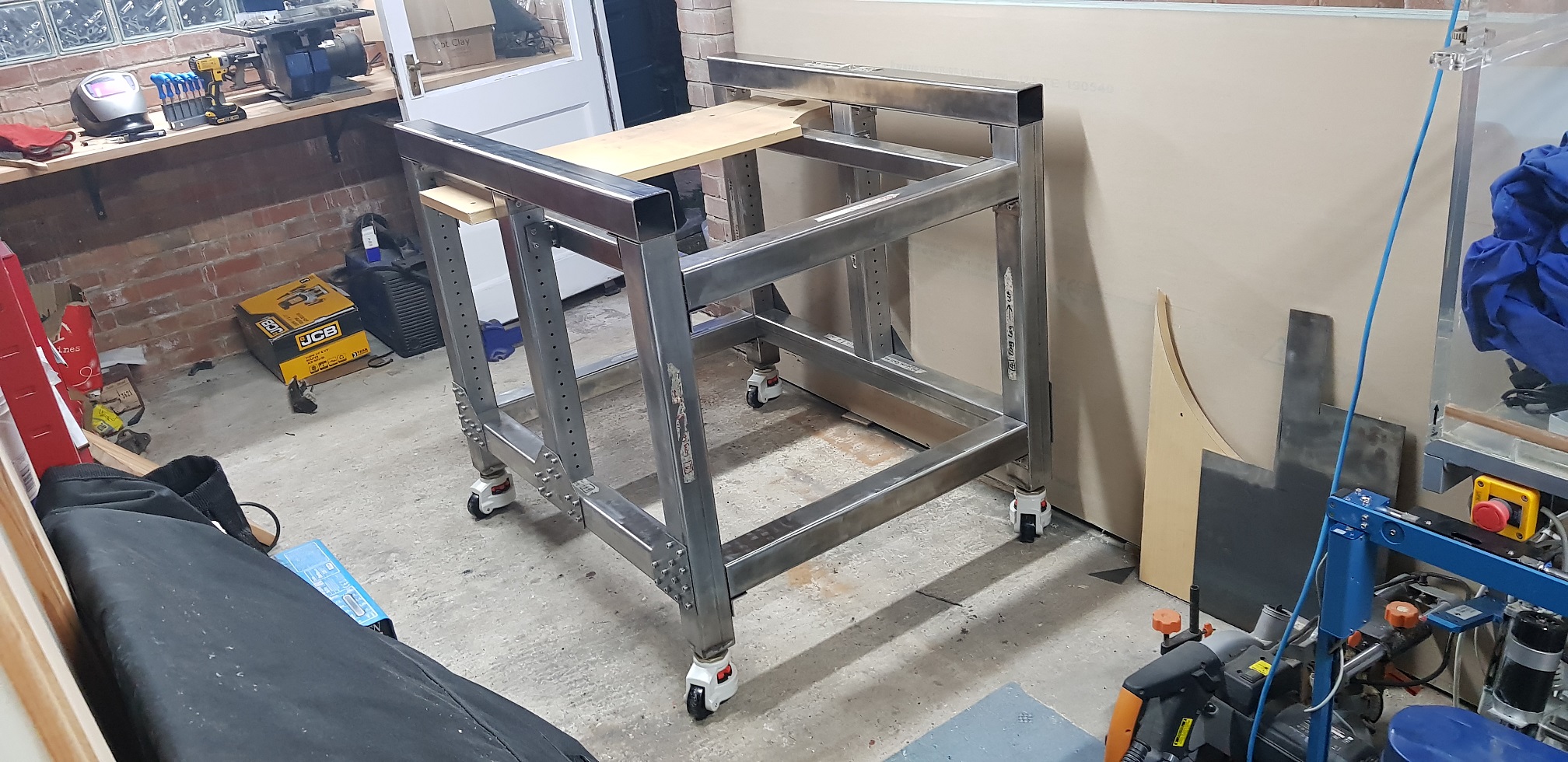

    Looking back over the photos in my thread, I can see why you thought it was just bolted. As it was my first time welding, I wasn't at all happy with how the process was going - I thought the welds were coming out pretty ugly and I had a number of "retries" grinding out bits that felt crappy and weak and doing them over again. As a result, I just didn't take many photos of the build during this stage, I was quite disheartened with it. It wasn't until I had something I was happy with (after lots of grinding, welding, regrinding, smoothing with some filler, sanding, then finally painting that I started taking photos of the frame again.
    Lets start back here - October 2018, all the frame steels (bar one!) were cleaned up, tapped, bolted together into an assembly I was happy with.

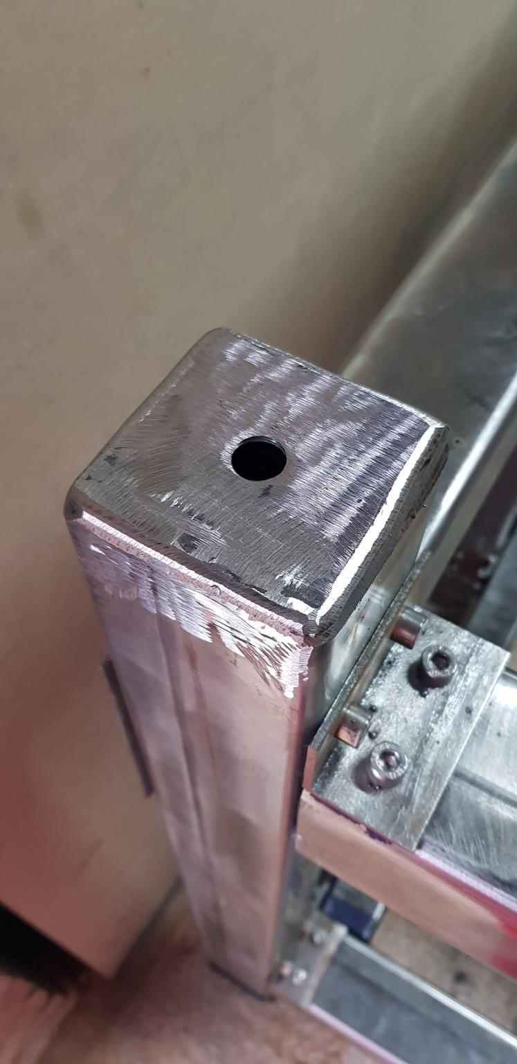

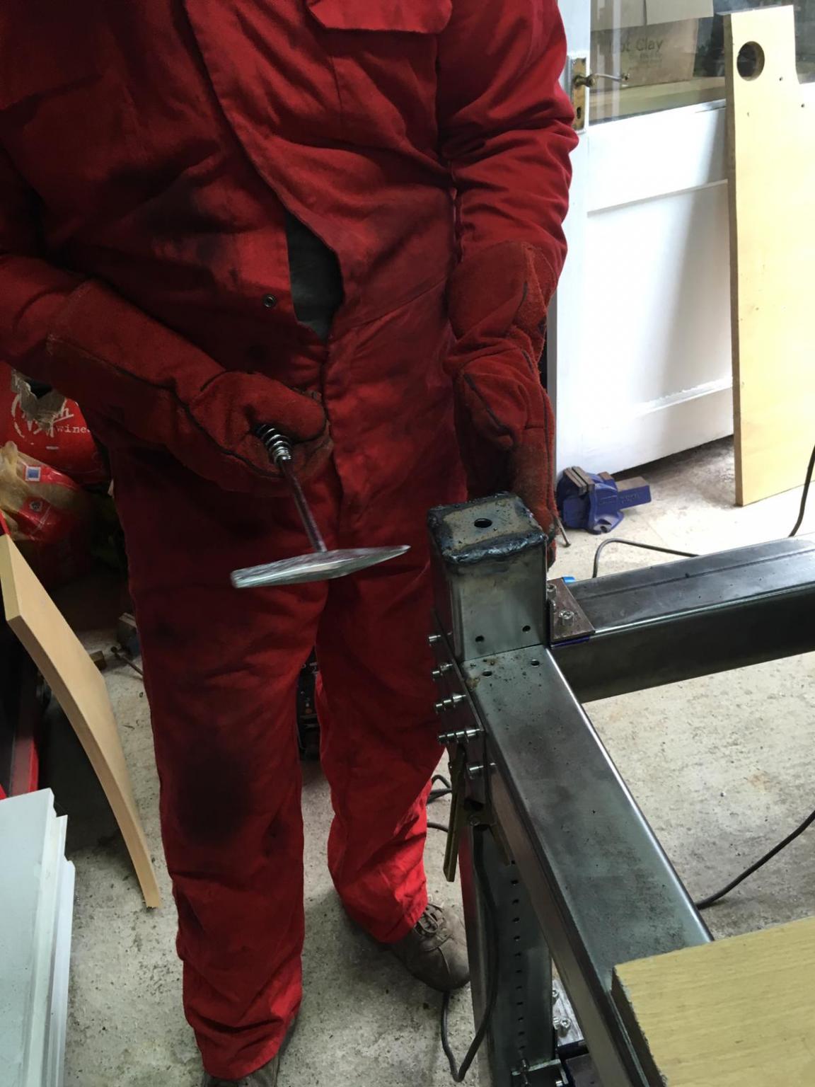

    I then turned the frame over, and started welding the caps on the bottom of the square tubing for the feet. I'd drilled and tapped these prior - but in hindsight I'd have welded a nut on the inside first to give more thickness to the thread. It was at this point I set my crotch on fire. ;)

    Then I started to tack weld the joints together all the way around, being sure to do one tack, then move around the machine to try and reduce distortion. Once that was done, I came back to each one in turn and gave it a full bead. Rinse and repeat.
    I was so unhappy with it I literally don't have a picture of the frame until it was painted.... and even then I wasn't happy with the brush marks in the first coat, so that took a while to sort out!
