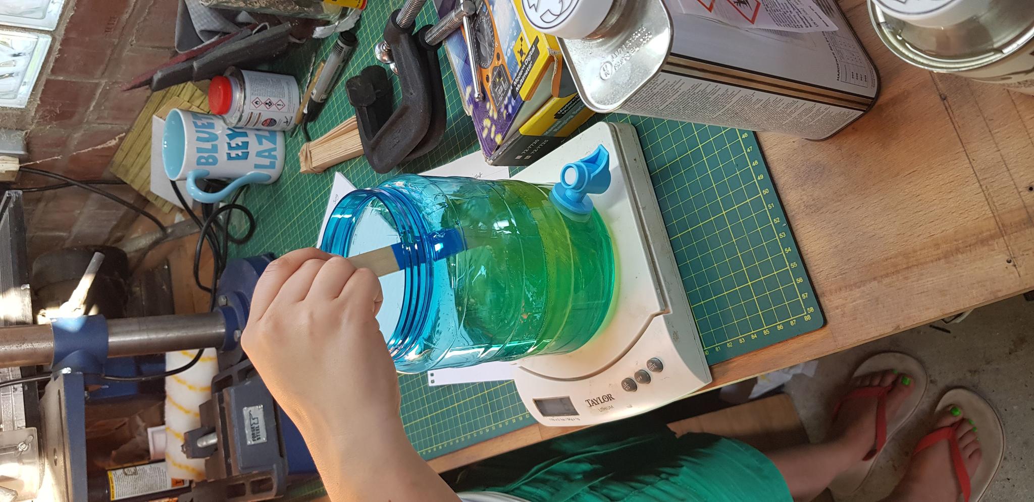

    After letting all that silicone set, and a bloody-good chineese takeaway, we set about the epoxying. We measured out and mixed the 1.3L in six equal sets by weight, taking a minute to thoroughly stir after each set. Naturally I got the wife to do this, as she is an expert stirrer.... When we got to the end, we did a two minute stir, then thought it would be a really good idea to let it sit for 10mins to let the bubbles rise out. It was going really really well - the bubbles were rising to the surface nicely, away from our little tap....

    Cue minute eight. The tub starts to look a little strange. Cries of "Oh Shit! The pots melting!!" come from the other side of the garage as the tub starts imploding and the epoxy level rapidly rises towards the rim of the bottle. Thankfully, we already had our gloves on and at the ready, so taking the very hot bottle, I swing it over to the frame and start the first pour by hammering on the tap's release button....
    Of course, the damn thing had already jammed shut. At this point, theres nothing for it but to up-end the bottle and start pouring from the top. Bubbles are being created everywhere, and there are a lot of fumes being released into my unsuspecting garage. I think they were mostly melting plastic fumes... but they could also have been fumes from the rapidly curing quatermass.
    Somehow, we managed to get the epoxy poured (taking shifts on who could hold their breath in the toxic air for the longest, the other running outside for some palatable air). I managed to go round 3/4 of the frame with a scribe and poke a few of the biggest bubbles before it became too gelled to continue, but most of them have left small craters. I'm quite sure the last 10cm or so hasn't been able to level before gelling.
