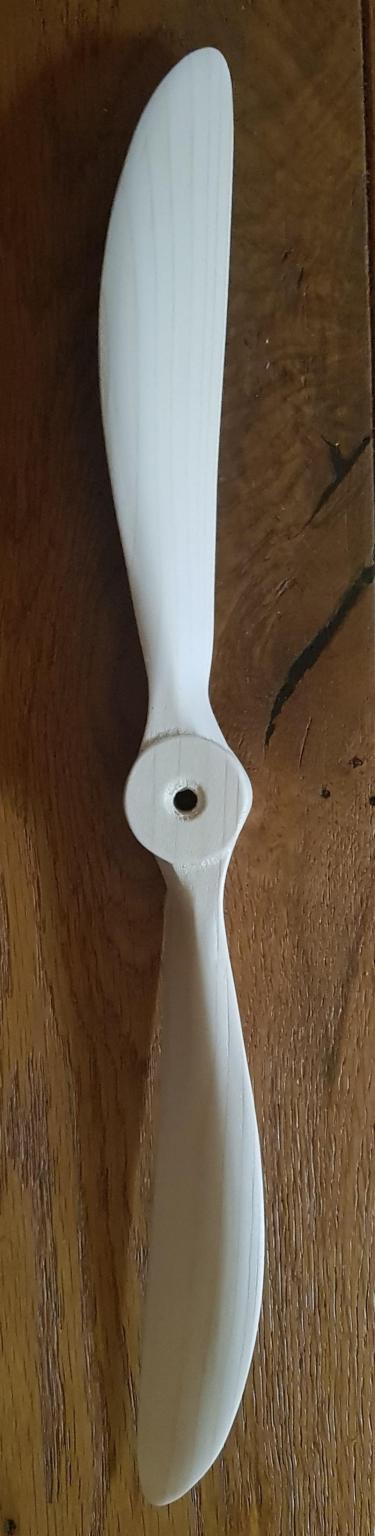

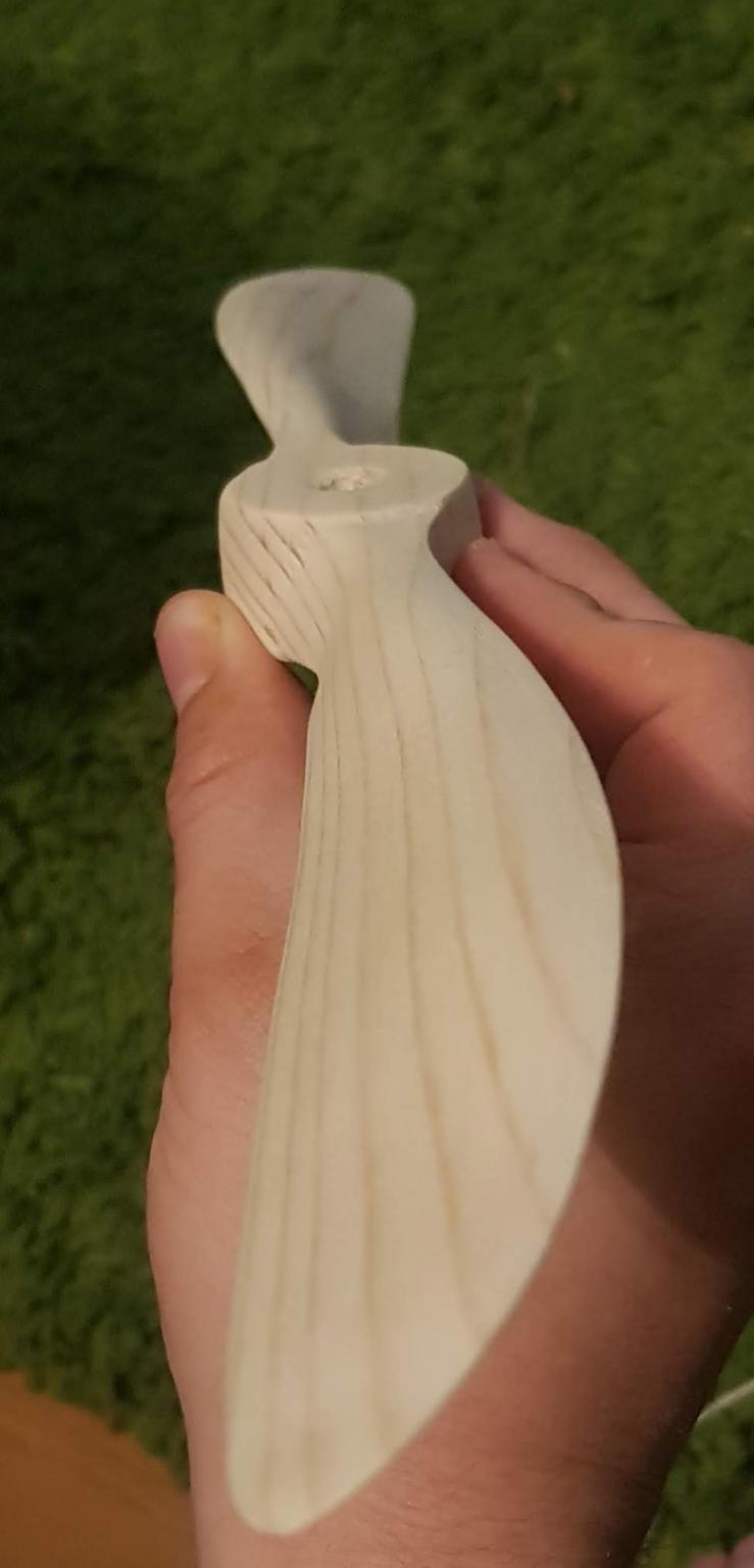

Also spent some time trying to improve my 3D CAD skills - mocked up a Sopwith Camel prop, and tried a 3D carve. The router did an amazing job (its about 600mm wide) - I really love how smooth and flowing the contour is after a single finishing pass with a 6mm ballnose. The only issue I had was that I messed up the CAM and only got half the model (oops). Before this cut I was slightly worried about if my Z axis was okay - one of the earlier 3D carves had some suspected lost steps - but it handled this one perfectly. Cooling is definitely a need-to-fix item on my agenda though - that little pump just can't cope with the length of cooling loop I've got, and after about an hour the lower section of the spindle was hot (still comfortable to touch, but I'm guessing it shouldn't build up heat if the cooling is working well).
