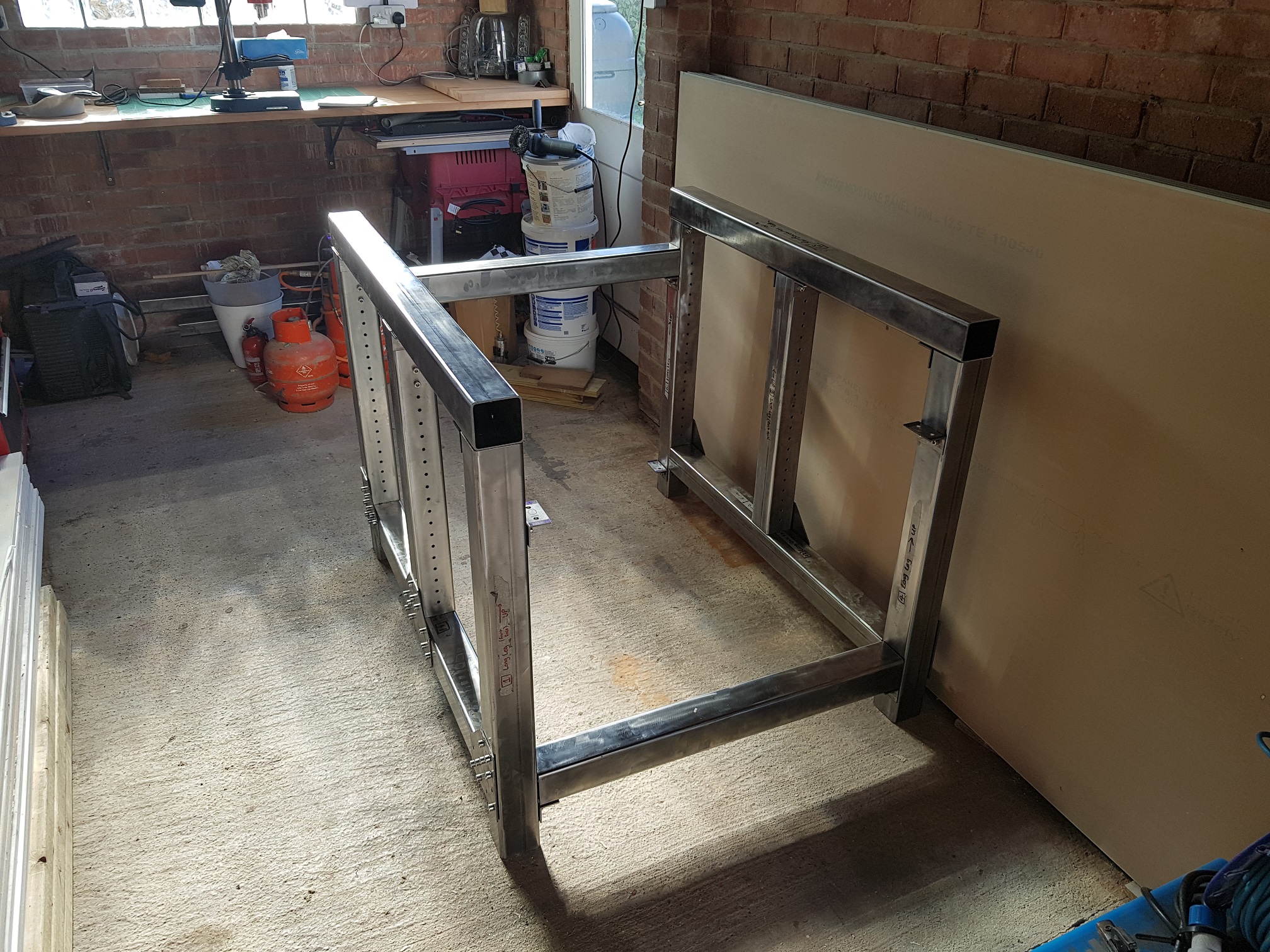

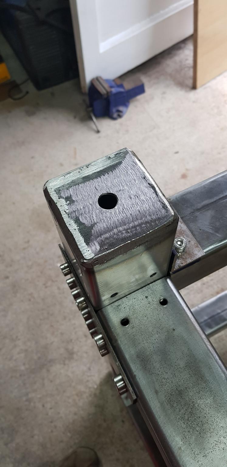

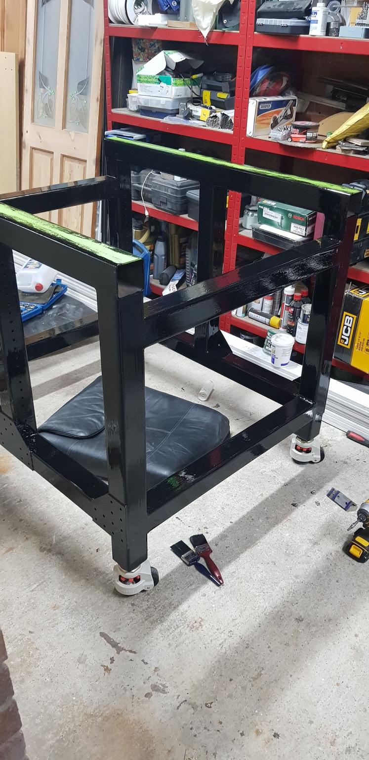

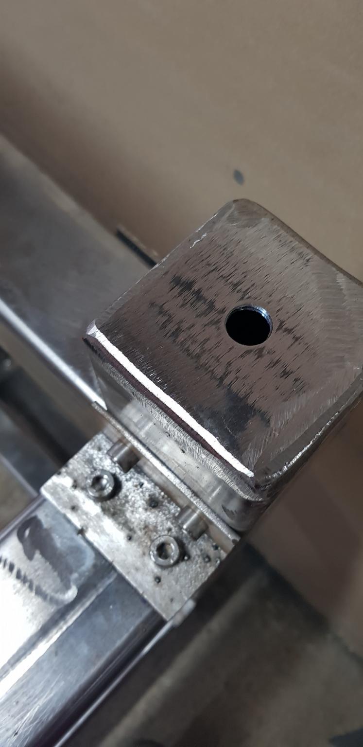

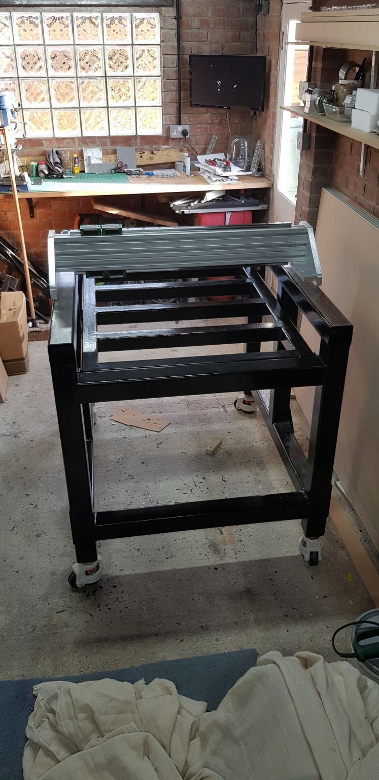

    Thanks :) Although my table is welded, and won't be coming apart without a grinder! The bolts were used to position everything for my first time welding, and are mostly aesthetic now. If I did need to separate the frame I'd need to repeat the epoxy levelling - its something I've mulled over, as we're considering building an extension which might trap the CNC in the workshop for good...
    Happy to send over any pictures of the model you'd fancy and provide dimensions, but the CAD is such a sprawling mess its a nightmare to get everything together to share. I'm also not sure of the benefits - if you're serious about building, designing the CAD model yourself is very helpful in organizing your thoughts, and helps your understanding how it all fits together, and it needs to be specific to your components. There are also a number of improvements I'd make now I've gone through the process, so if you start a build log you'll get a lot of suggestions from all directions.
    Oh, for sure I would be making my own CAD, but since your design is pretty similar to what i had in mind i'm bound to stumble upon the same problems and decisions and thought having a tried and tested design would help me resolve those at some point. The most significant difference is I don't have access to a mill... I do have my current tabletop CNC that i intend to use to machine the aluminum flatbar into whatever plates I need, and I also have a hobby lathe (not the crappiest kind, I think its the same as the Warco you might be more familiar with in the UK).
    Oh, so you essentially welded the sides, then assembled the table with screws and taps, and then welded it together? was it mostly to prevent it from moving?

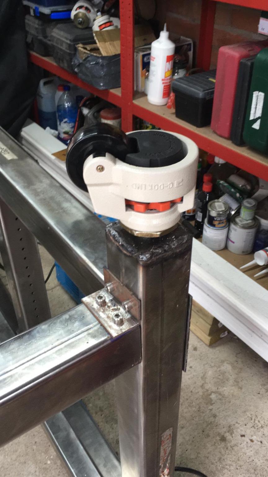

    What about the legs, did you solder anything below the open 80x80 tubes? I cannot bolt the table down to the floor because i have floor hitting and i'm sure i'll be unlucky enough to hit a hose with the drill. Probably won't be necessary as the table will weight a shit ton.
    Sorry my reply is a mess! Yes, i'd appreciate any pictures you could send about how all the frame is attached.

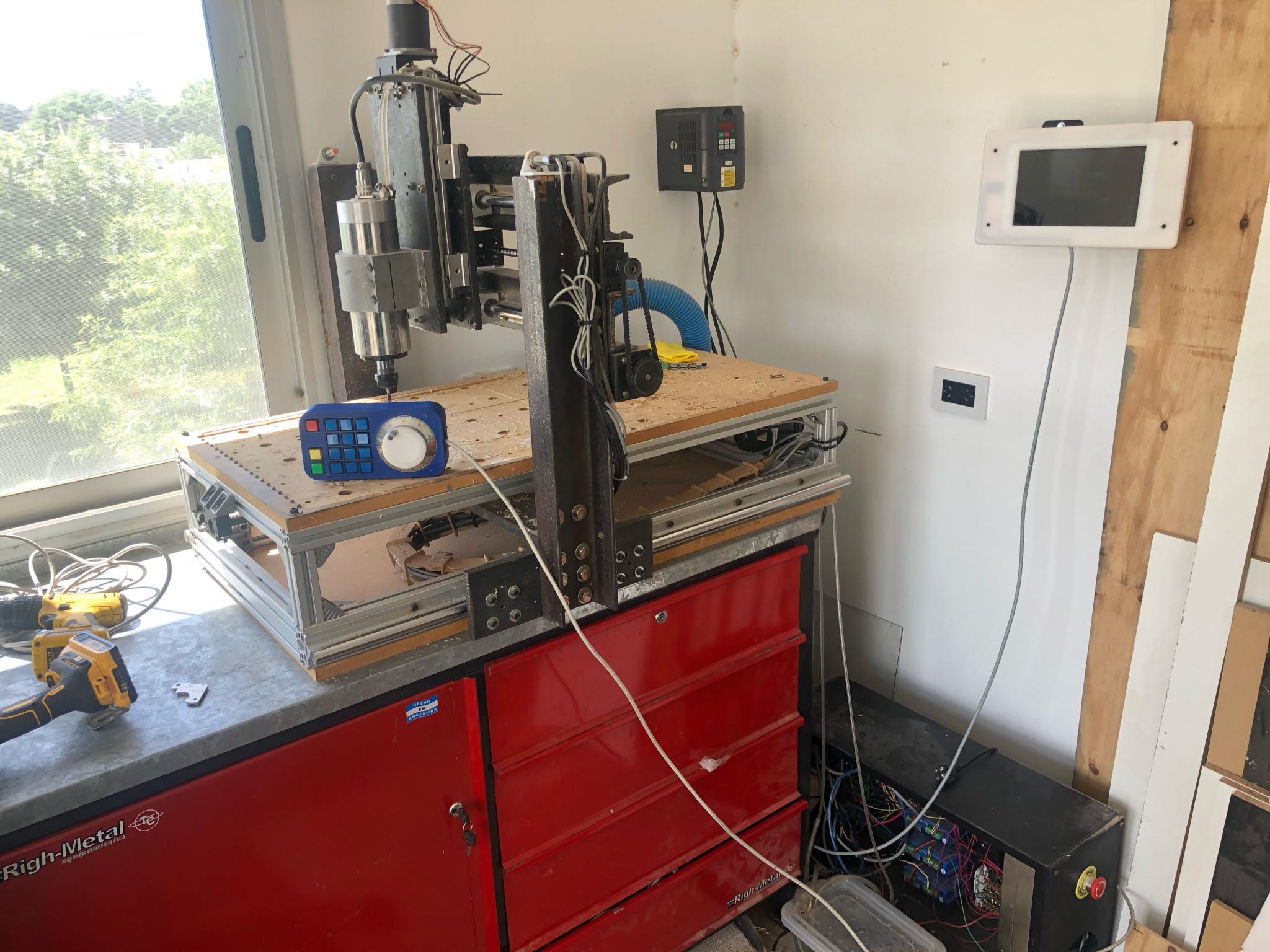

    Attaching a pic of my baby. I started this years when I didn't even have a workshop, let alone a proper one. It literally spent some time in the coffee table in the living room until i stole the laundry room from the wife. Now that i do and i've had time to see the flaws it's time for an upgrade. I already have all the hiwin style rails and longer screws. I'll be reusing only the longest axis rails that are now in X for the Y gantry (1m). I've already redone the control box and electronics and added the extra driver for dual X screws.
