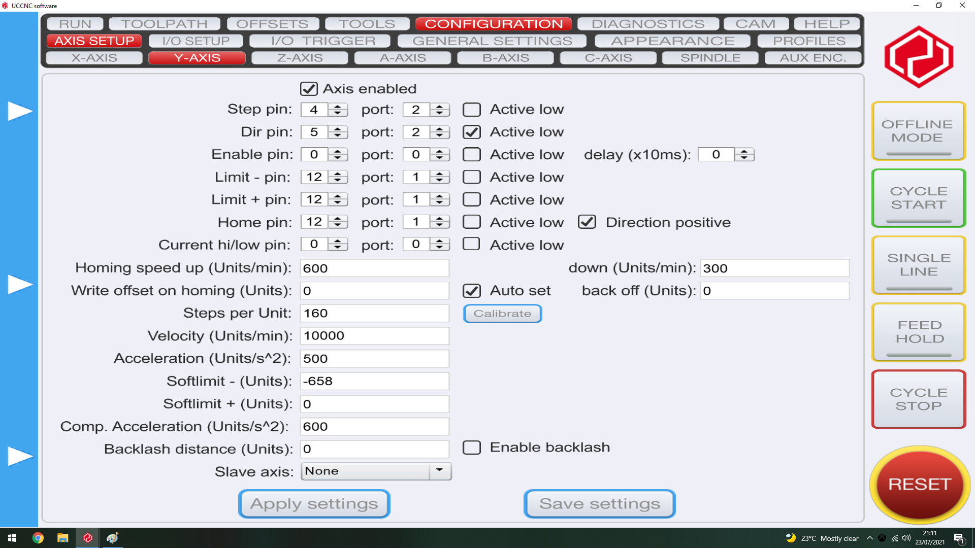

    Axis Settings (X/Y/Z/A)
ID:	30287 Click image for larger version.
ID:	30288 Click image for larger version.
    Note slaving of X and A. X&Y Steps per is pretty self explanatory (200 steps per rotation on the steppers, 10mm pitch screws, 8x microstepping = 160 steps per mm). Z is 5mm pitch so 320mm. Y&Z use a travelling inductive limit so port and pins identical. X&A have independent static switches for home and -ve limit, but share a +ve limit switch. Speeds and accelerations are set quite conservatively to avoid stalls.

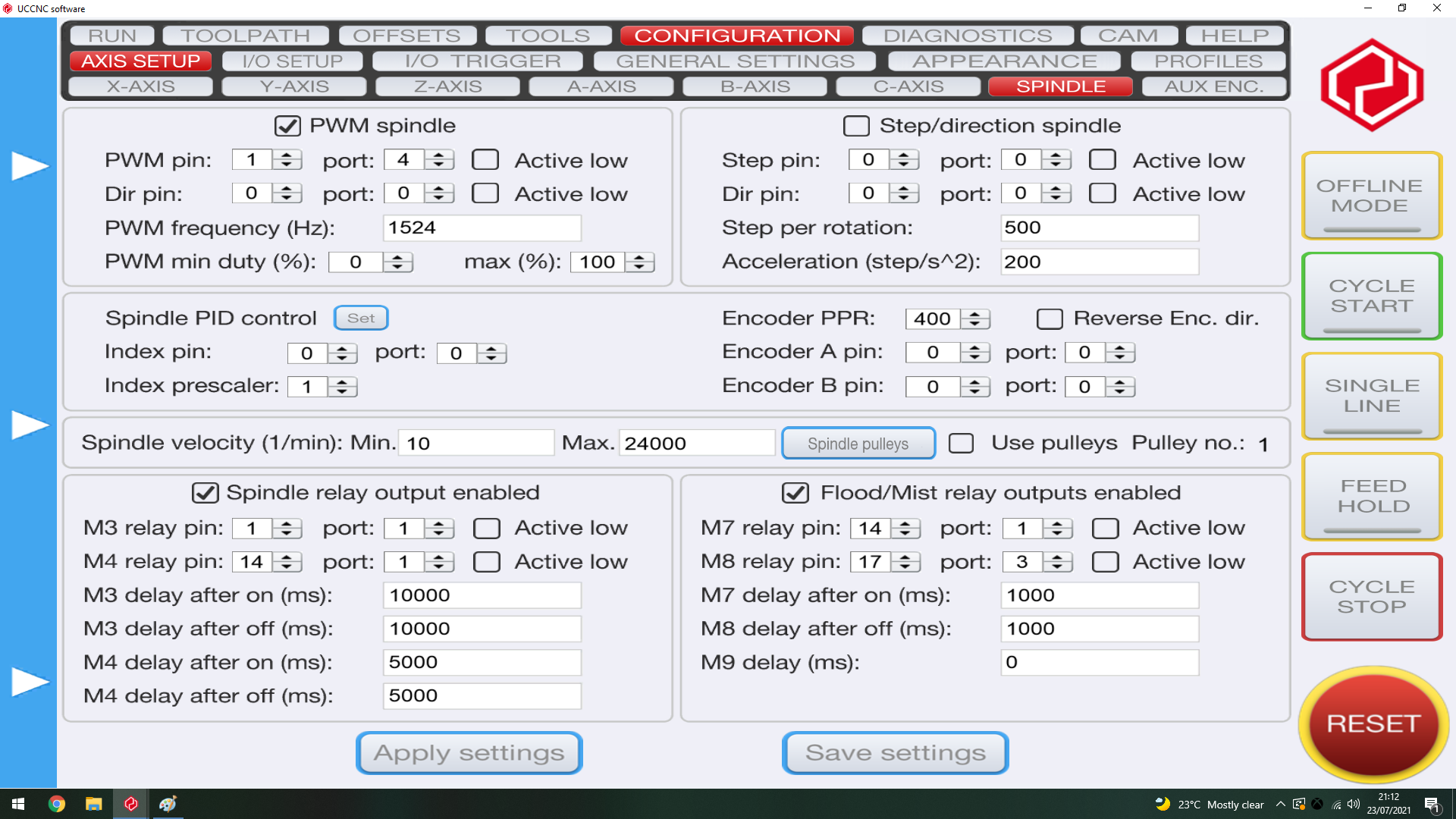

    Spindle Settings
    As per manual, nothing special here.

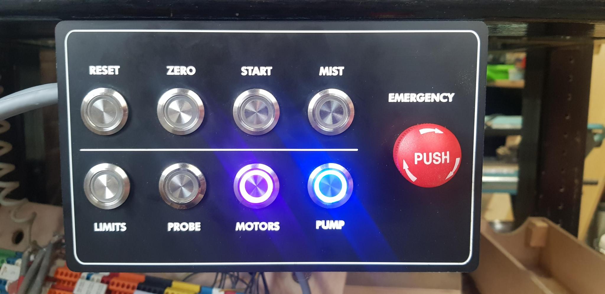

    Input Triggers
    These handle my control box switch inputs, you can make the same switch have multiple actions, some occur on depress and some on release (hence the low tick). If you see high numbers in the function code its a custom macro to do more complex actions, like my Z height probing or my Zero button which does homing or X&Y zeroing depending on the machine state.
    Output Triggers
    These exclusively control LEDs on my control panel, alongside some of my macroloops.

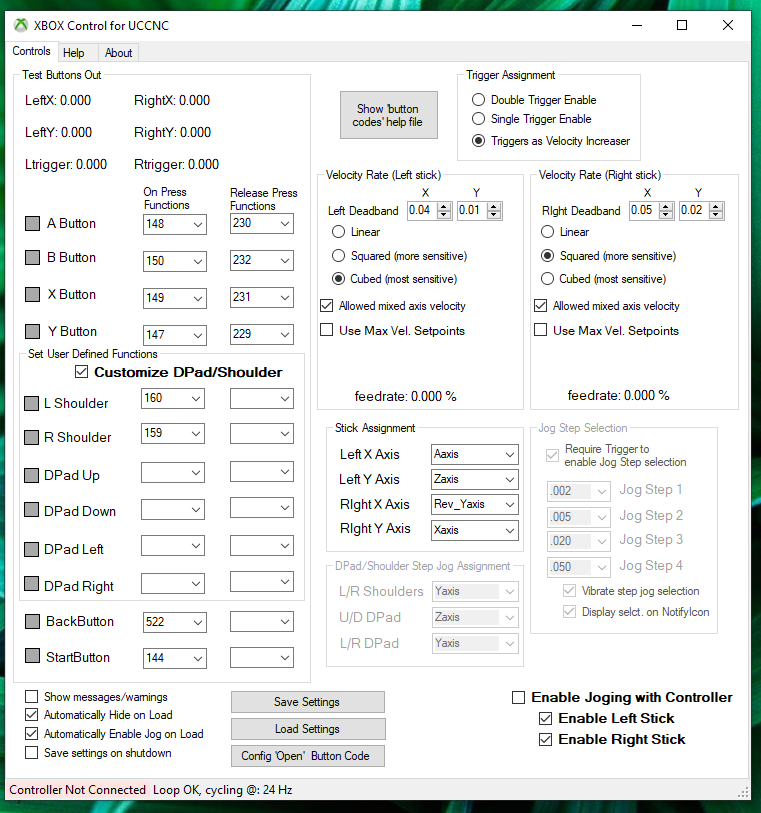

    Xbox Controller Settings
    See my previous post to discuss these.
