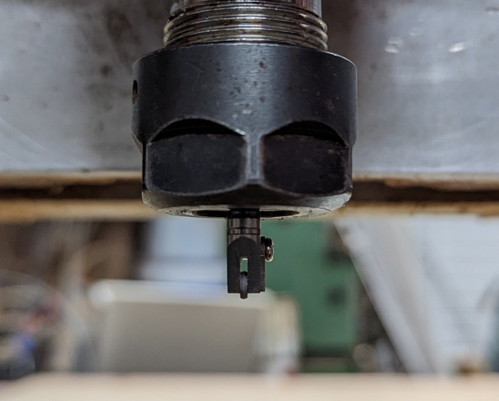

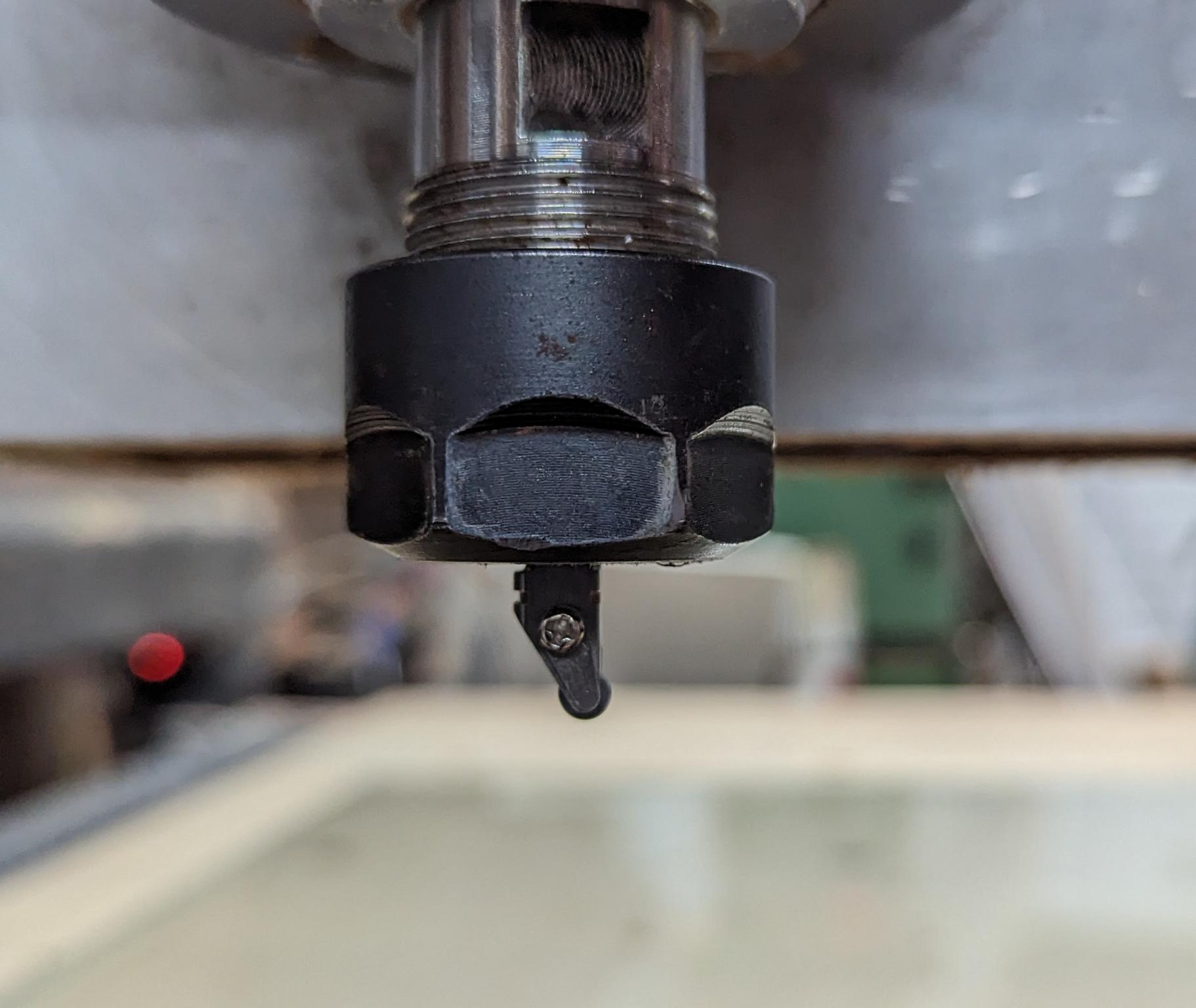

    Evening Folks.
    One of my original aims for this machine had been to help with the other half's glass work. We've made jigs, and aluminium bead making tools, but until now haven't touched glass itself.
    I kinda expected to need a water cooling trough, and to use a diamond burr to grind the glass away. Recently though, we stumbled on some people using a scoring wheel without any of that faff and thought we'd give it a try. Wheel cost us a couple of quid and is a drag style.
    I first probed the surface because it's not spring loaded yet, so you'll hear the machine doing some funky Z adjustments as it goes.

    Anyhow, she's delighted with the results, mainly because the CNC maintains a perfect perpendicular to the score line, so the pieces break out really nicely in comparison to amateurs cutting manually!!

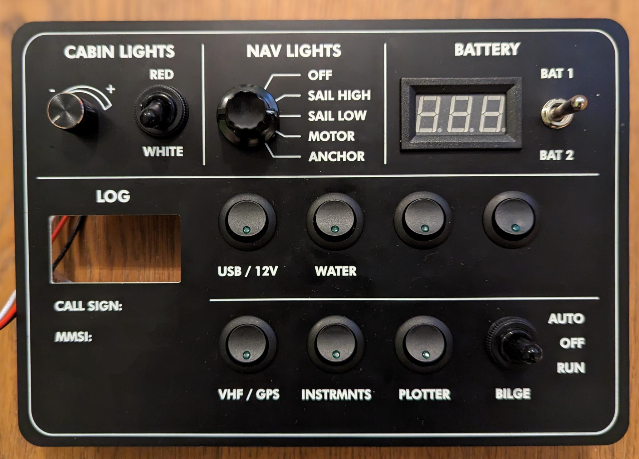

    Whilst I'm doing project updates... One of our other time sinks is being on the water. I'm currently rewiring our boat and thought it would be nice to give it a custom control panel. I've blanked out the identification area, but it was great fun to design and make this exactly how I wanted it.

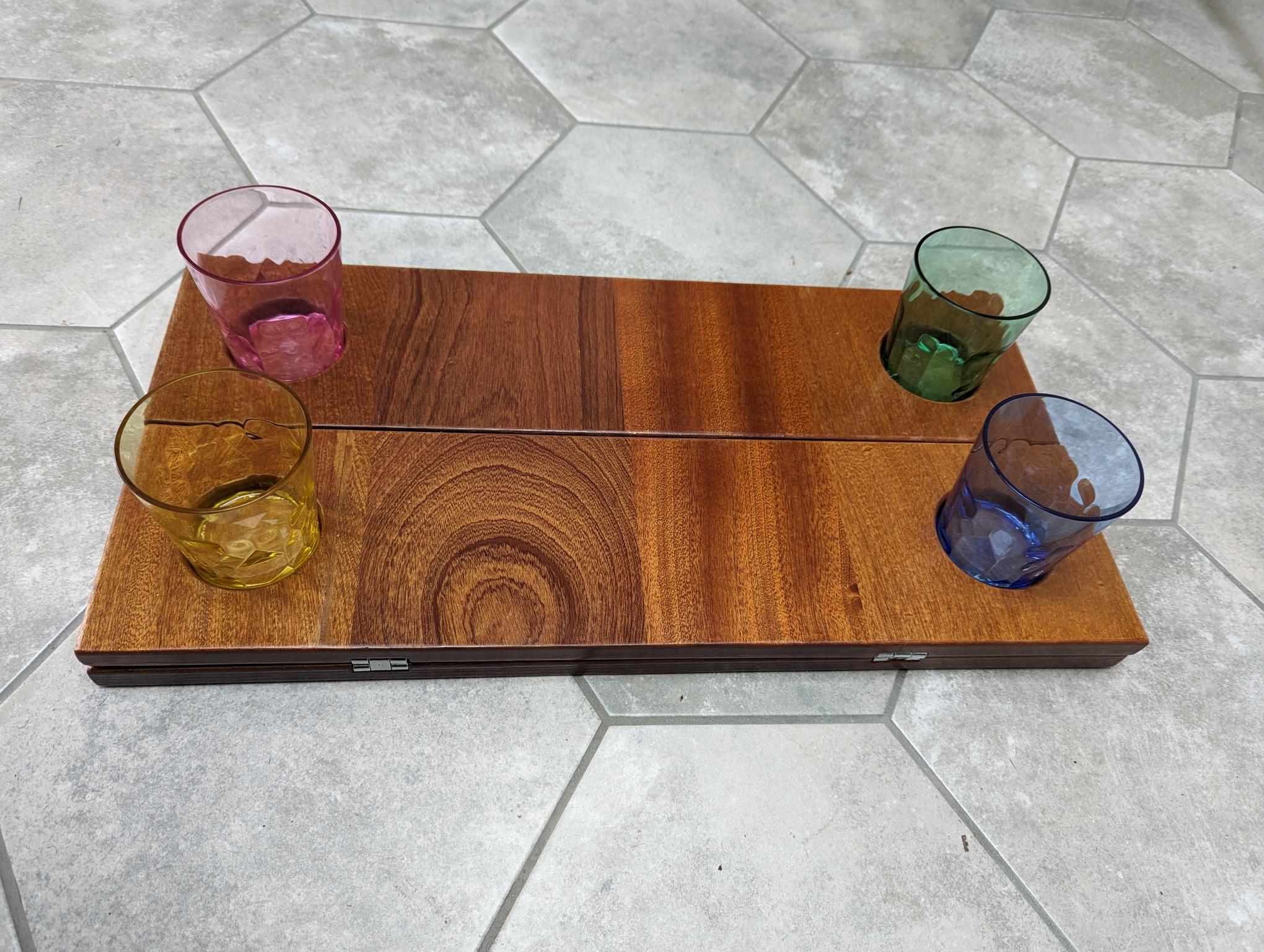

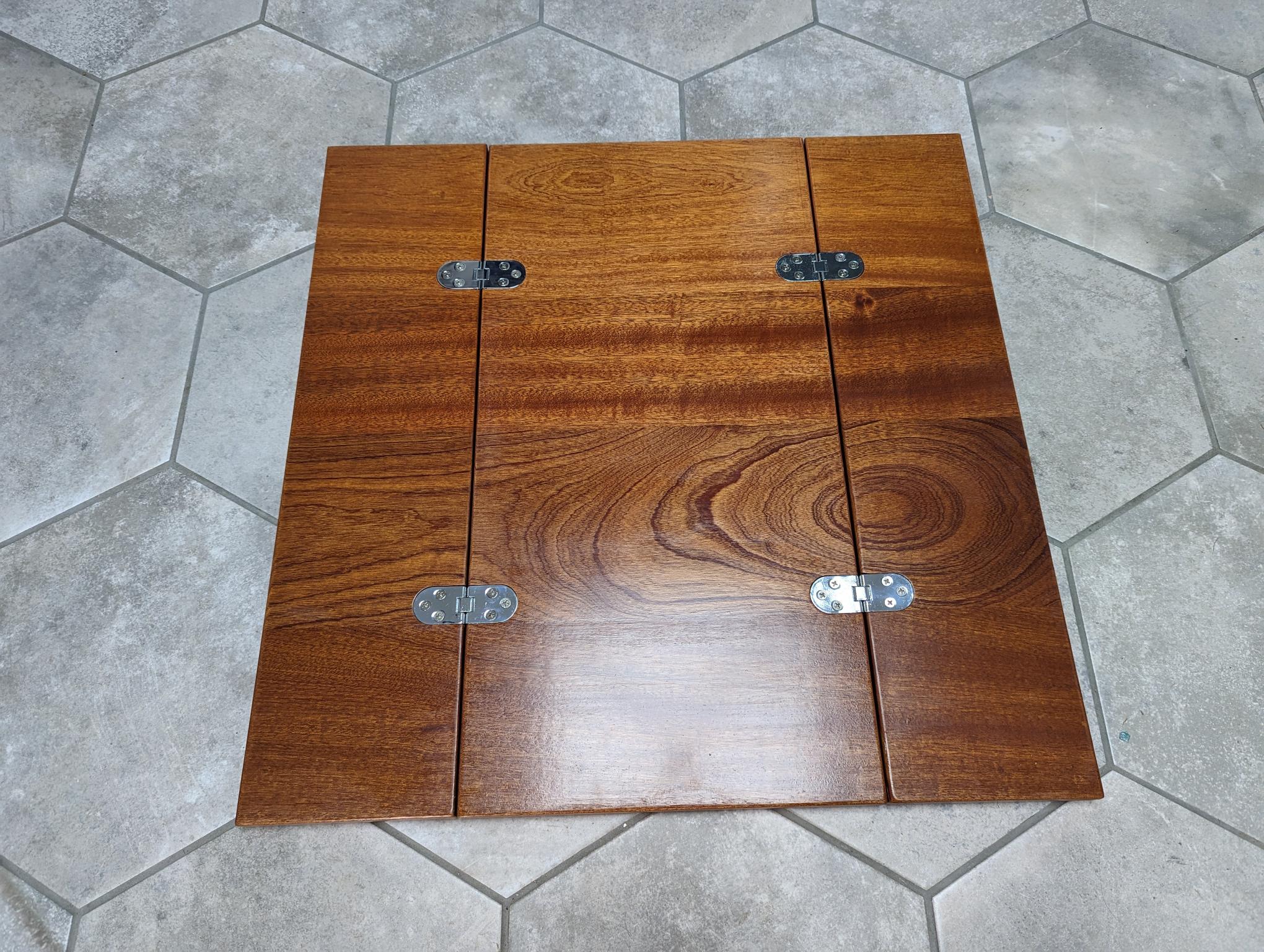

    Being a sailor also comes with a drinking habit, so you also need a nice drinks table for the cockpit. We grabbed some appropriate plastic tumblers and used the CNC to carve perfectly fitting cupholders, and nicely inlay the hinges into some Sapele. The hardest part of this project was the varnish :/

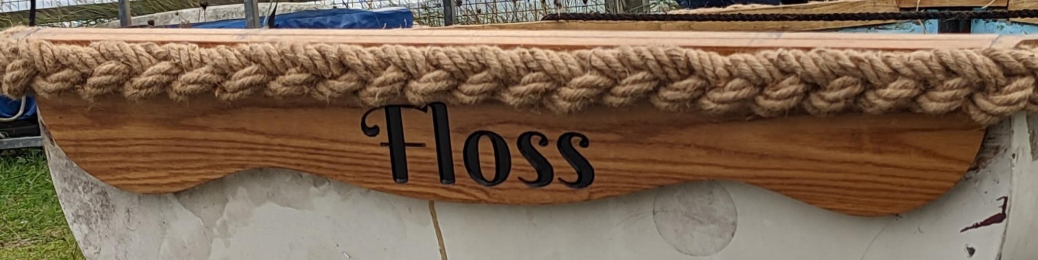

    Finally, the tender needed some love too, so along with steam bending new gunwales I also CNCed a new transom for it. Don't ask my why we've called our tender floss - I'm not even sure I know myself.

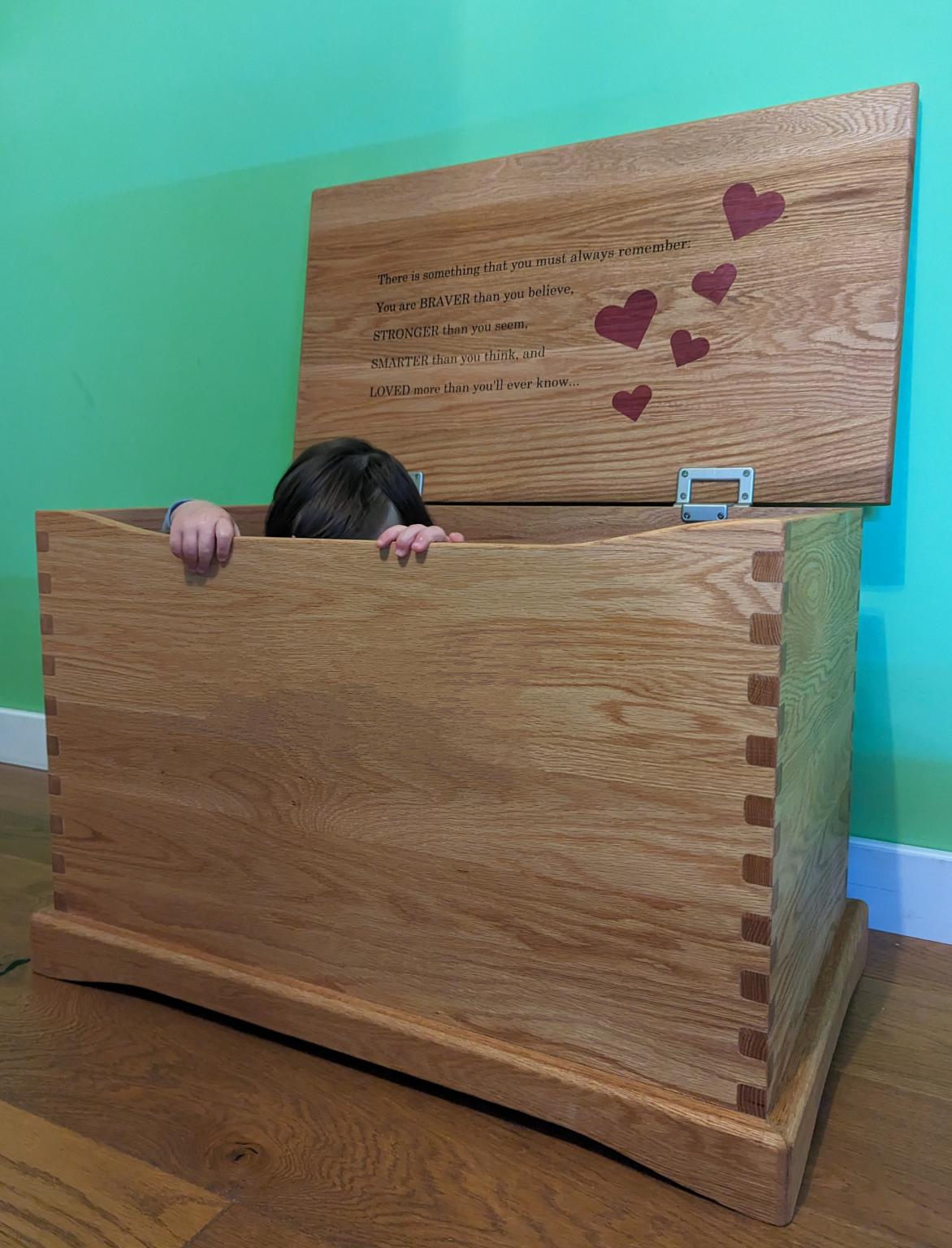

    And last, but by no means least, my Daughter's Christmas present. I took a few months over this one, which probably says more about how little free time we get these days!
    I saw the solid oak toy boxes from makemesomethingspecial - and was utterly obsessed. I had to make one, and now I have an excuse to have a toy box around... So off I went to find some appropriate oak, and into CAD I went. Here is the result - although again I've removed her name which is carved in the front through the wonder of Google's magic eraser (hasn't it done an amazing job matching the grain?!) - Complete with the box's owner playing peak-a-boo inside. Don't worry for her hands, the hinges are rockler's torsion spring hinges, so the lid stays exactly where its left.

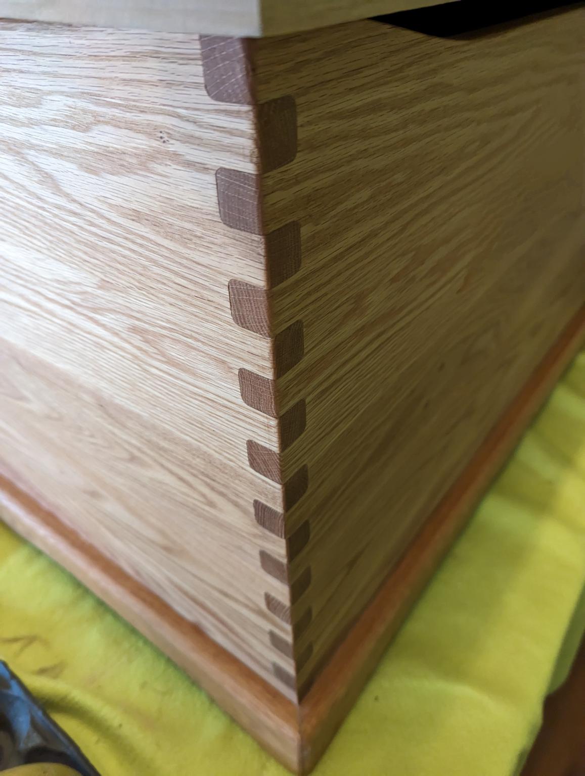

    One of the features I really love are the finger joints. Because I lack manual woodworking skills, I decided they had to be fully CNCed. So I chose the round the edges of the fingers to match the cutters radius on the internal corners. This meant not only rounding them in the profile cut, but also using a matched round over bit on the back face of each piece.

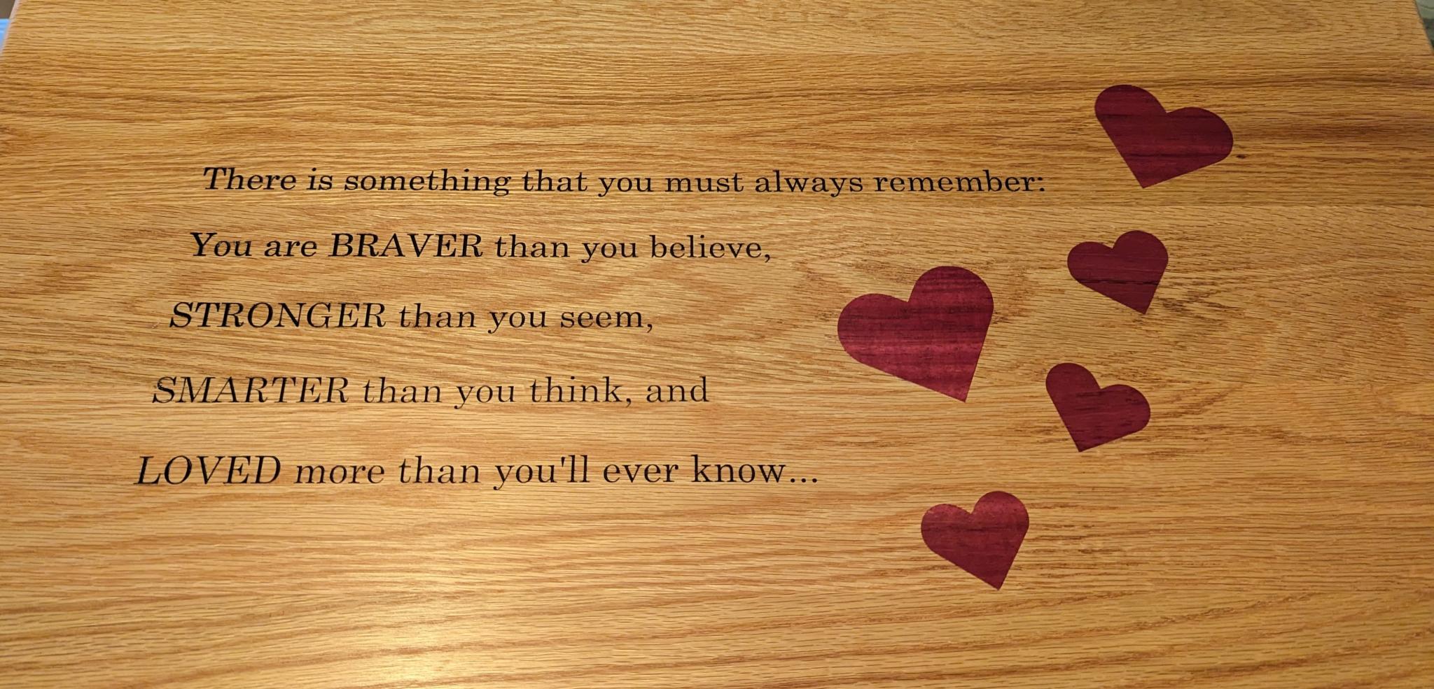

    And then of course the lid needed some inlays. I couldn't think of anything better than the Disney Winnie the pooh quote, so I went with that alongside some purple-heart purple hearts. Corny? Yeah. But cute, too.
