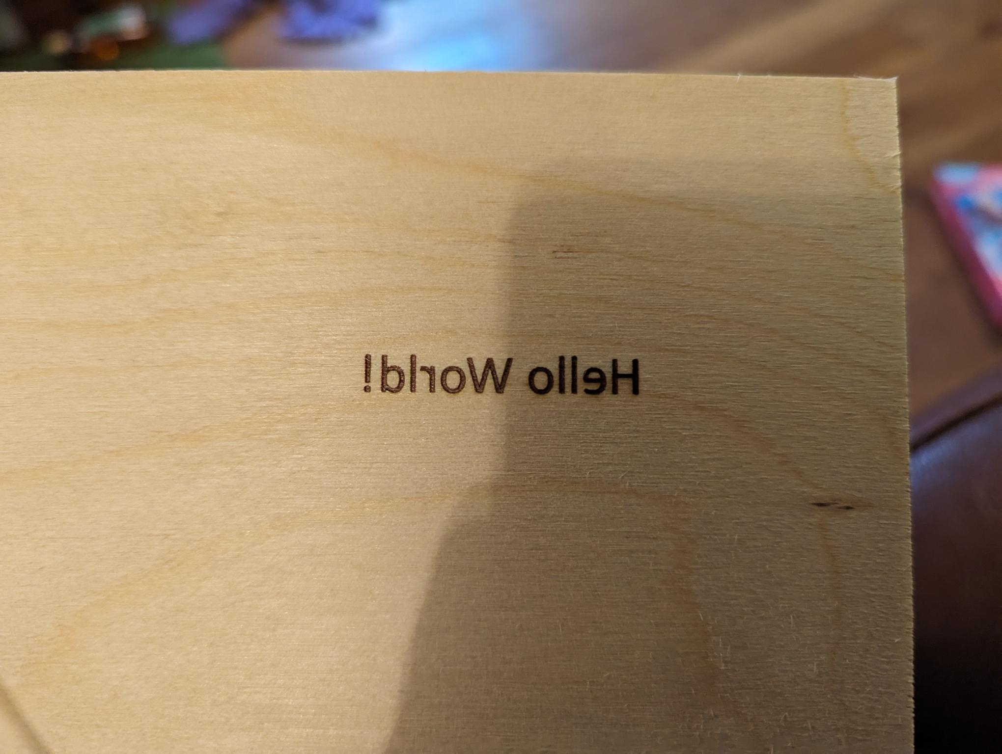

    a 10W Diode Laser
    Cool, so your using the machine as a diode laser engraver? Been thinking about this recently myself too
  6. #215
    Yeah, just a bit of a experiment really. £130 for a 10W 450nm Laser Tree 80 24V from their AliExpress store.
    Made the first couple of cuts tonight - was a bit of a bitch to setup and I'm not particularly enjoying how dangerous it feels for my eyes (I have reputable laser Goggles etc, but I used to work with similar lasers in an optics lab so know how evil these things can be), and it's quite fumey too. That and the fire risk.
    Having said that though, very happy with the results so far. Here was my first ever time running Gcode on the laser (UCCNC seems relatively capable, although clearly not designed with lasers in mind - there is a recent lightburn import plugin which is really helpful). Flipped the axis for the next cut and it looks fantastic - although in my first material test squares I ended up blasting through the 3mm ply and then on all the way through 20mm of MDF.... Whoops.
    The below test text is about 50mm wide, took about a minute with a single pass at 3000mm/min 50% power.

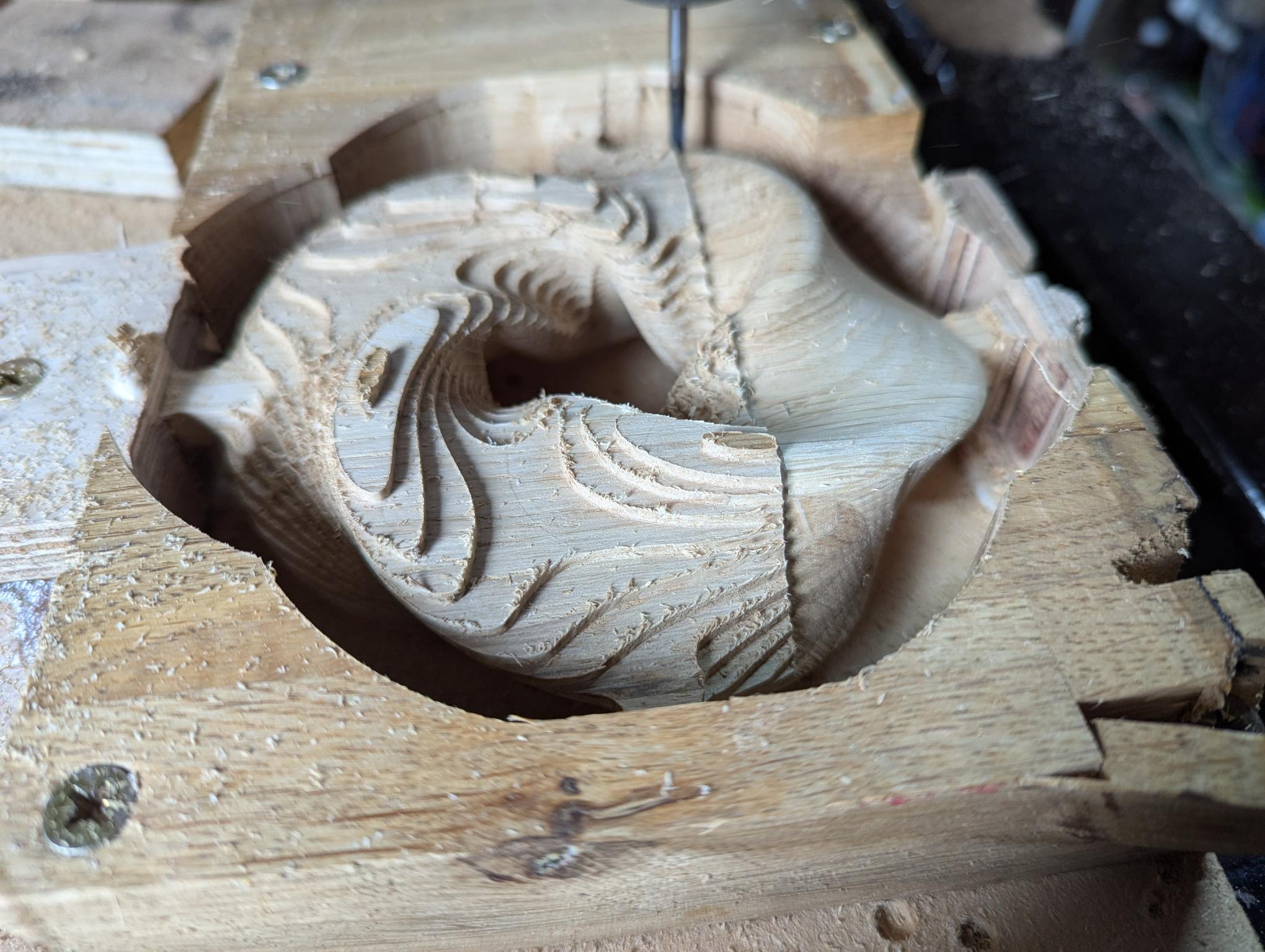

    4 Twist Umbilic Torus. What's cool is it only has one face.
    First project with openSCAD programming to generate the shape, which also allows all the variations to be generated (like different widths, radii, number of twists etc)

    It is very beautiful.
    Can you please share more information about the dimensions, the way you hold down the wood on the cnc bed, the cutting bits ,how you turn it and align it etc...
  11. #218
    Sure.
    It's 130x130x36mm, two sided machining operation with an 8mm endmill to rough, 4mm ballnose to finish. Ideally I'd have used a long tapered ball nose but didn't have one to hand, so had some silly stickout on a standard ballnose for clearancs. Held down with 3D tabs. Alignment with brass pins - you cut pockets for them on the first side, then the matching pattern into the spoil board. Ugly in progress photo attached.
