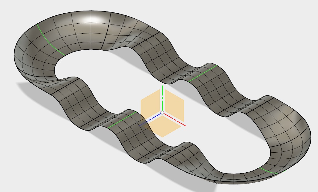

    This was a play project I originally done in Solidworks several years ago, then machined via CamBam.

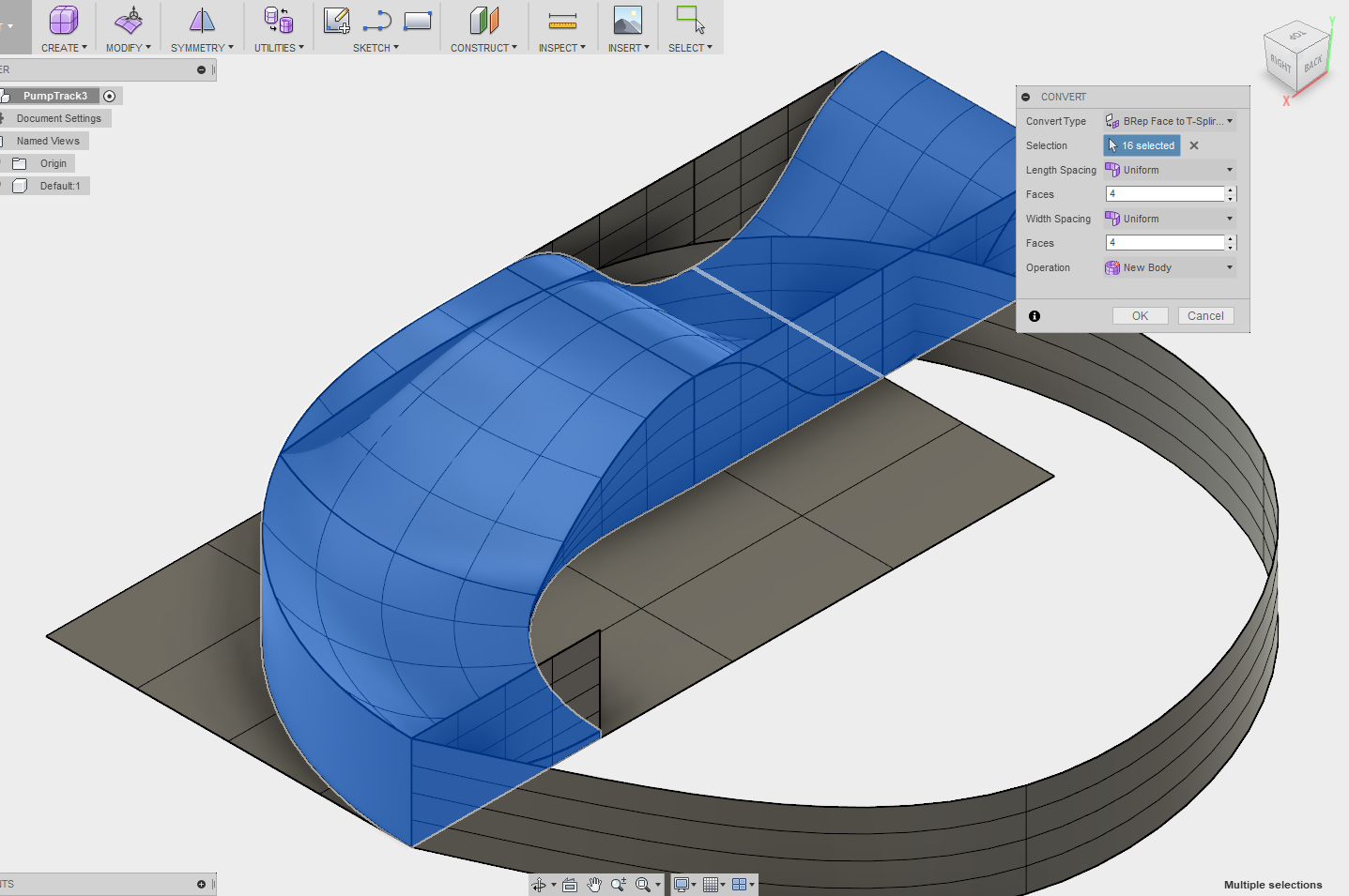

    The original SW file loads, but when I convert to T-splines, lots of the curves go the wrong way, so I end up with arcs opposite from where they should be, but cleaning it up gets the attached image.
    What I want to do is now transpose/extend that model so it forms that model on top of a flat base, but I've so far failed to find any good demonstrations of how to do it.
    Anybody care to point me in the right direction?

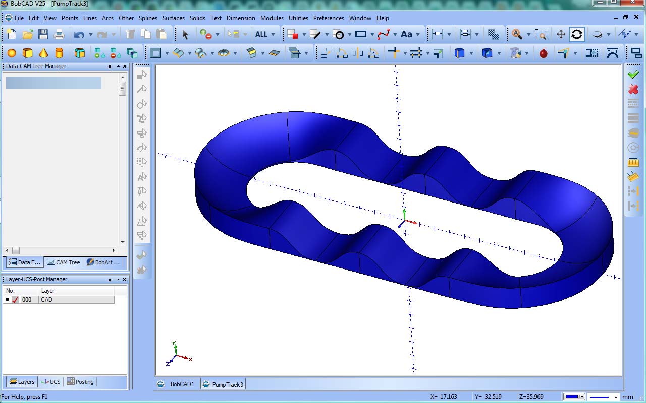

    I've managed this in BobCAD/CAM V25. The geometry looks good and clean

    Fusion really isn't liking the file.
    Although Fusion will load and display the original file, the STP, and IGES versions perfectly, you can't do anything with them. You have to convert them to T-Spline models, but this is what you end up with -
    or Fusion crashing if you select certain options.
    It's a bit of a poor show that several year old software will let you load and manipulate the file, yet something that's meant to be far more capable fails quite spectacularly.
    I'll remodel it when I get some time, as it'll be a good project to learn how the 3D tools work.

    The circular ribbon was present in the file you sent me along with a couple of other artifacts, I had to unstitch the ribbon from the solid and delete it, I suspect the other grey artifacts were also present but were dealt with by BobCAD's cleanup tools.
    Althoug the CAD side isn't to everyone's taste, even in V25 Bob's CAM had some very powerful 2, 3 and 4 axis toolpath options,
