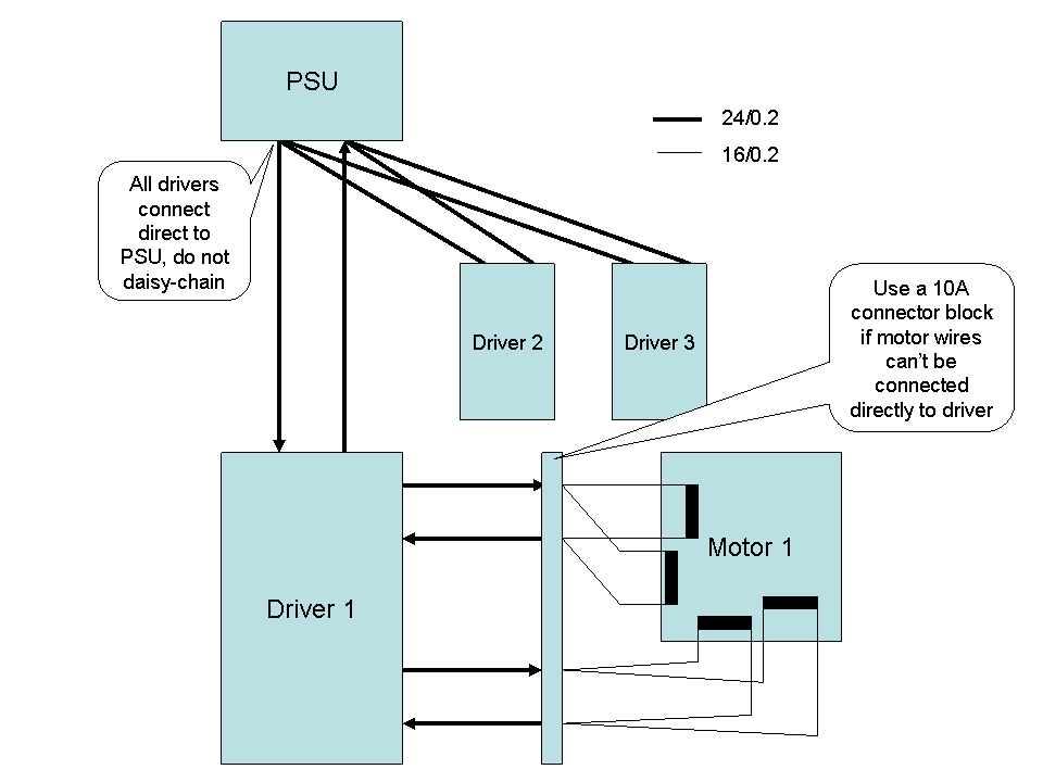

    Assuming an 8-wire motor, the motor wires only carry 2.1A, remember that the 4.2A is for bipolar parallel operation with 2 windings in use, 2.1A per winding. 16/0.2mm cable is rated for continuous 3A capacity. For the cables connecting to the driver, which are carryig 4.2A you should use 24/0.2mm which is rated at 6A continuous

    Ok but if the cables connecting to the driver are carrying 4.2a, is that devided by 4 wires if the motor is in a bipolar parallel operation ?
    Basicly Irving i just want to know what the correct rating of the wire should be that i use to connect the drivers to each motor/XLR. Can i not just use the same rated wire as whats on the motors or is it better to step down as you go?

    Lee, the attached diagram might help.
