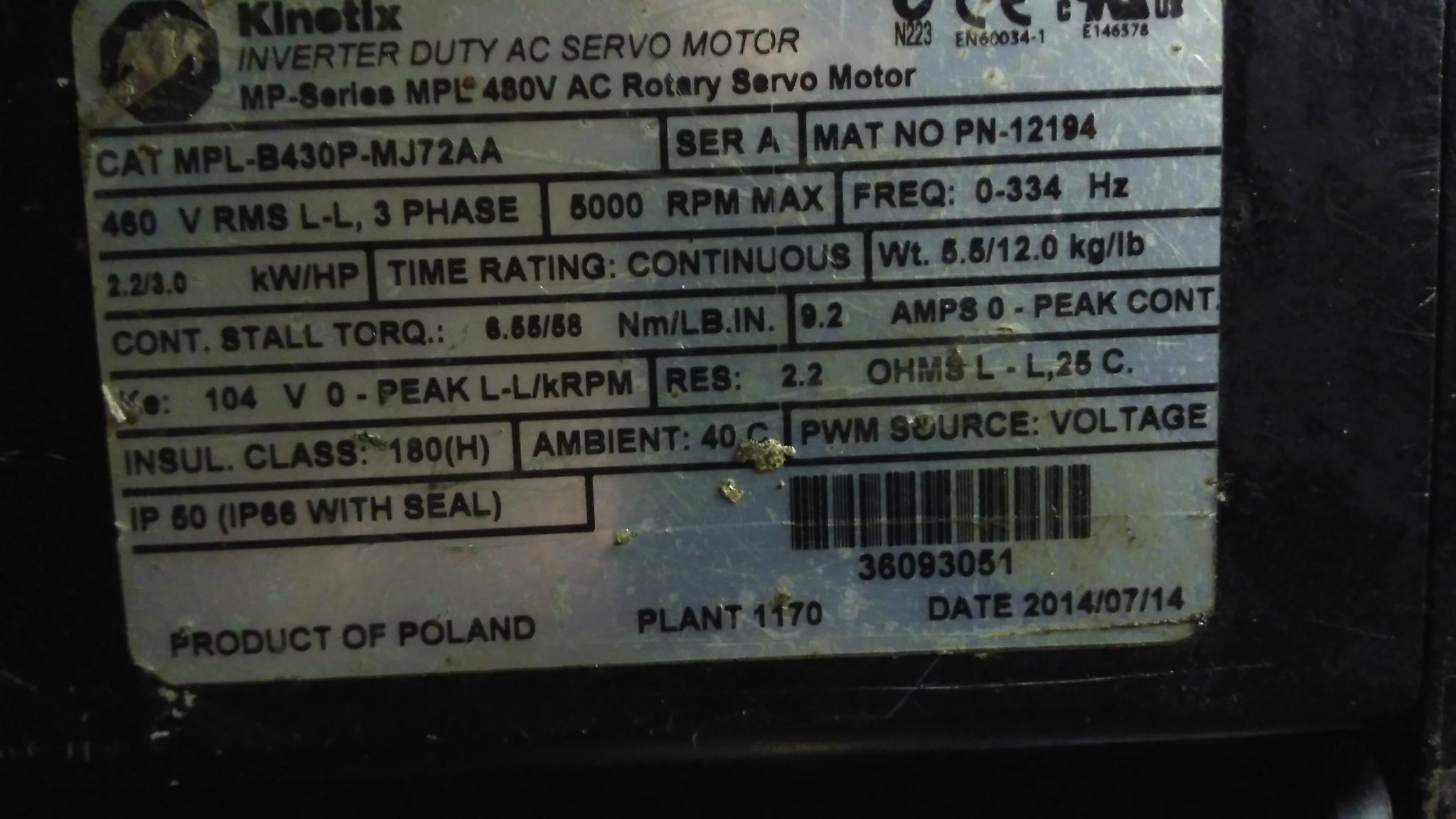

    Ah! In post #1 you said you have two AB servos without the drivers
    Oh yes I have those two but I got no wiring or controllers with them, so they are on the shelf in the workshop.Click image for larger version.
ID:	23538 this is a picture of the label.
