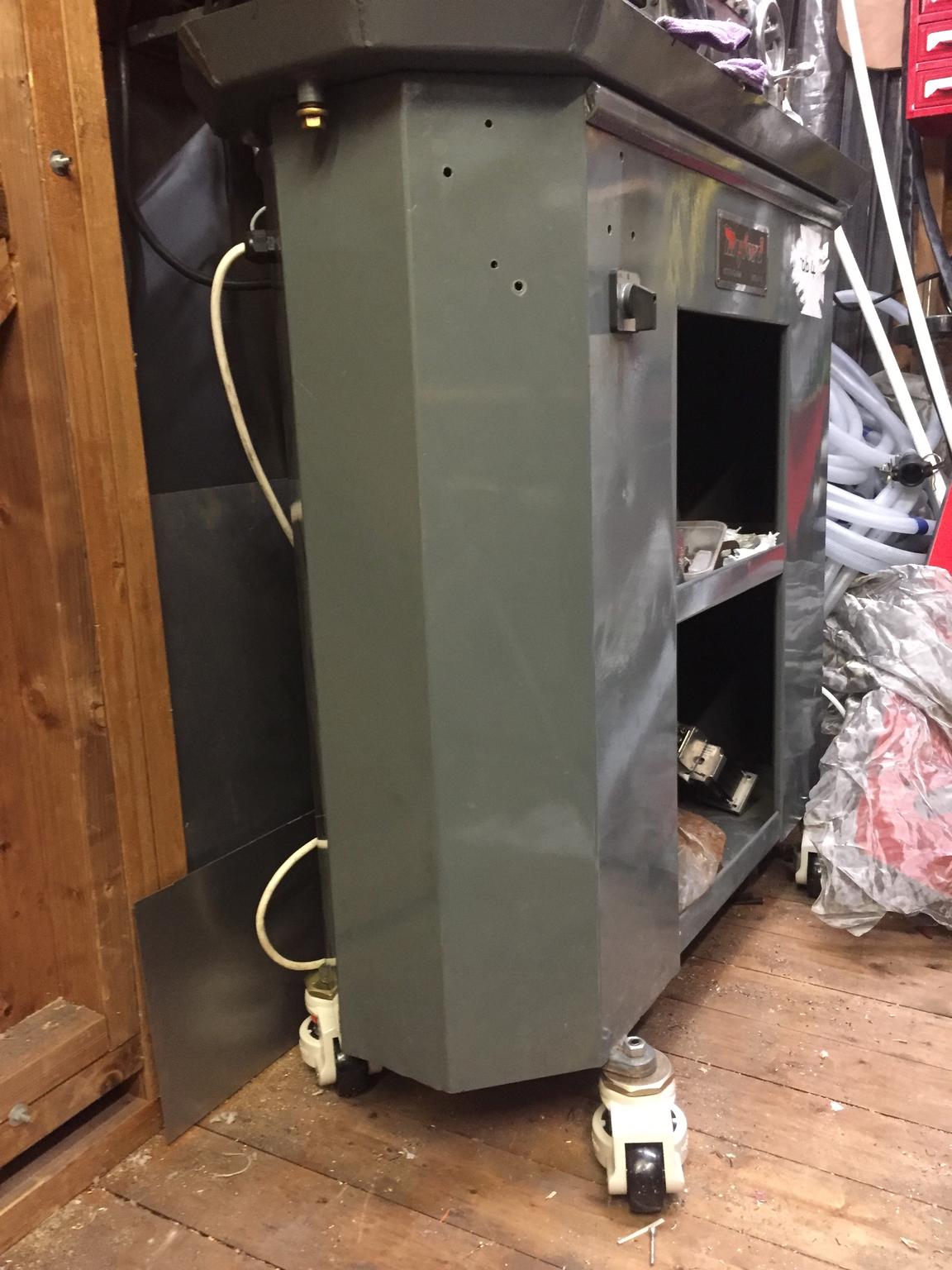

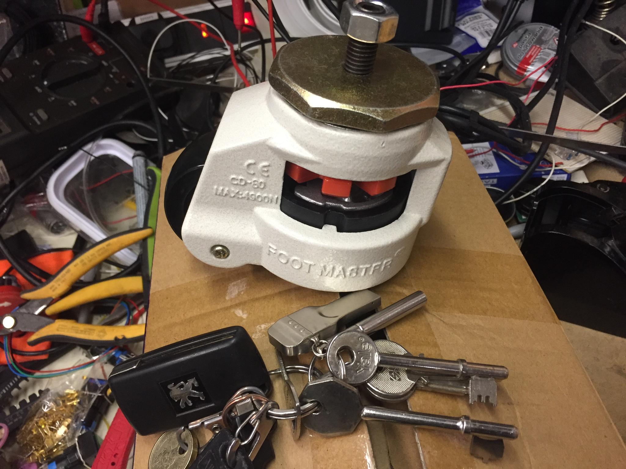

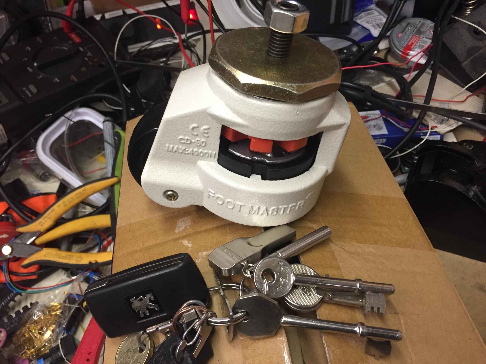

    If you're in still in the market in the next couple of days, I *should* have a set of the third largest (No. 3 of 4) of the Aim Tools link earlier, I can offer a personal view pre/post fit onto the lathe, together with pics and/or video.

    Edit: and here they are:
    Keys shown for scale. I was worried with the purpose of the Phillips screws near the castors - these just stop the heavy axle dropping out of the foot - not at all load bearing. Nylon foot is solid.
    Quite chunky on the Myford - but solid. I did a quick level just to see how stable they are and they are leaps-and-bounds better than the feet that they replaced. A proper level can wait until it's warmer. The castors are solid and I would now consider the installation portable.
