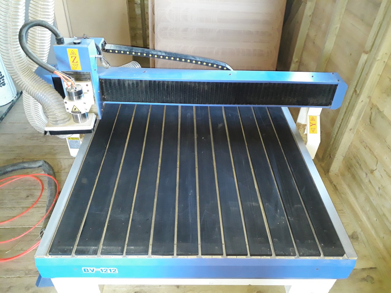

    my bed: https://i.imgur.com/jx3NAJu.jpg

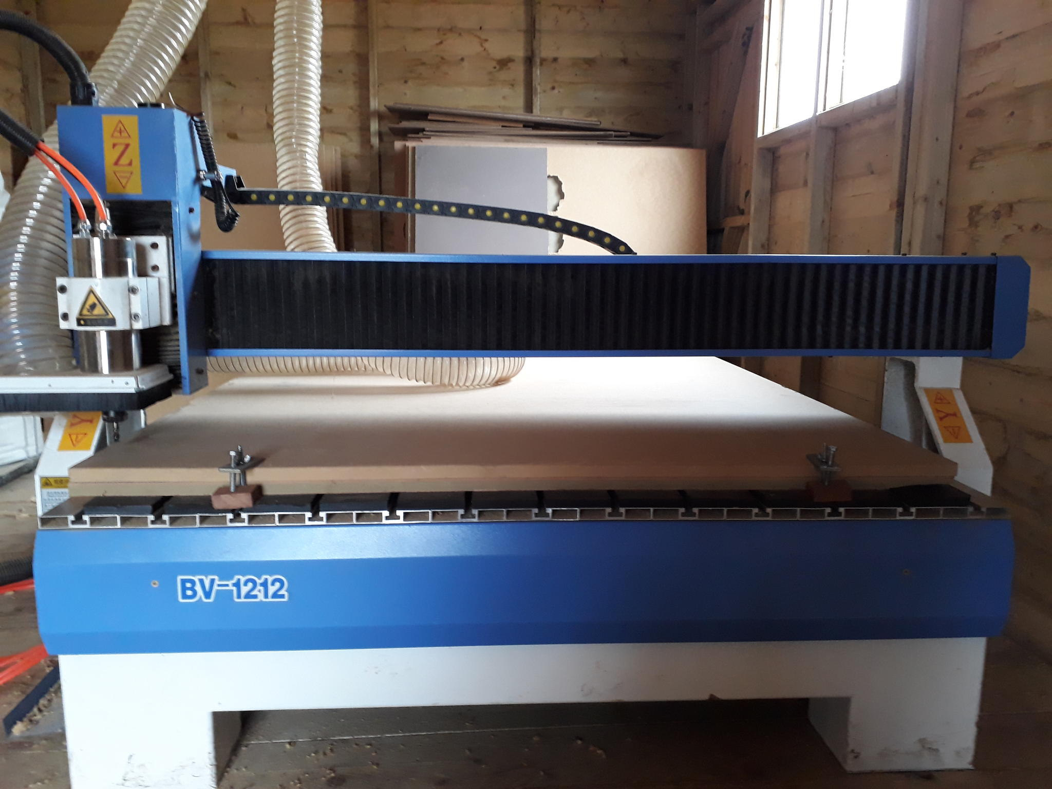

    Clamps: https://i.imgur.com/VkjFngU.jpg (I did have 3 but cut one down to try and bolt it therough spoil board - so I'm currently looking to replace them all tbh - they are well used)
    Thing with using my router to make the spoil board with counter sunk holes and what not is how would I be able to line up the tee slots, and I need the whole sheet for the signs in cutting out really. With clamps I still get a lot of waste as I have to set my work piece origin after them.
    Really I just need more clamps - or at least decent Tee bolts for my clamps to sit in.

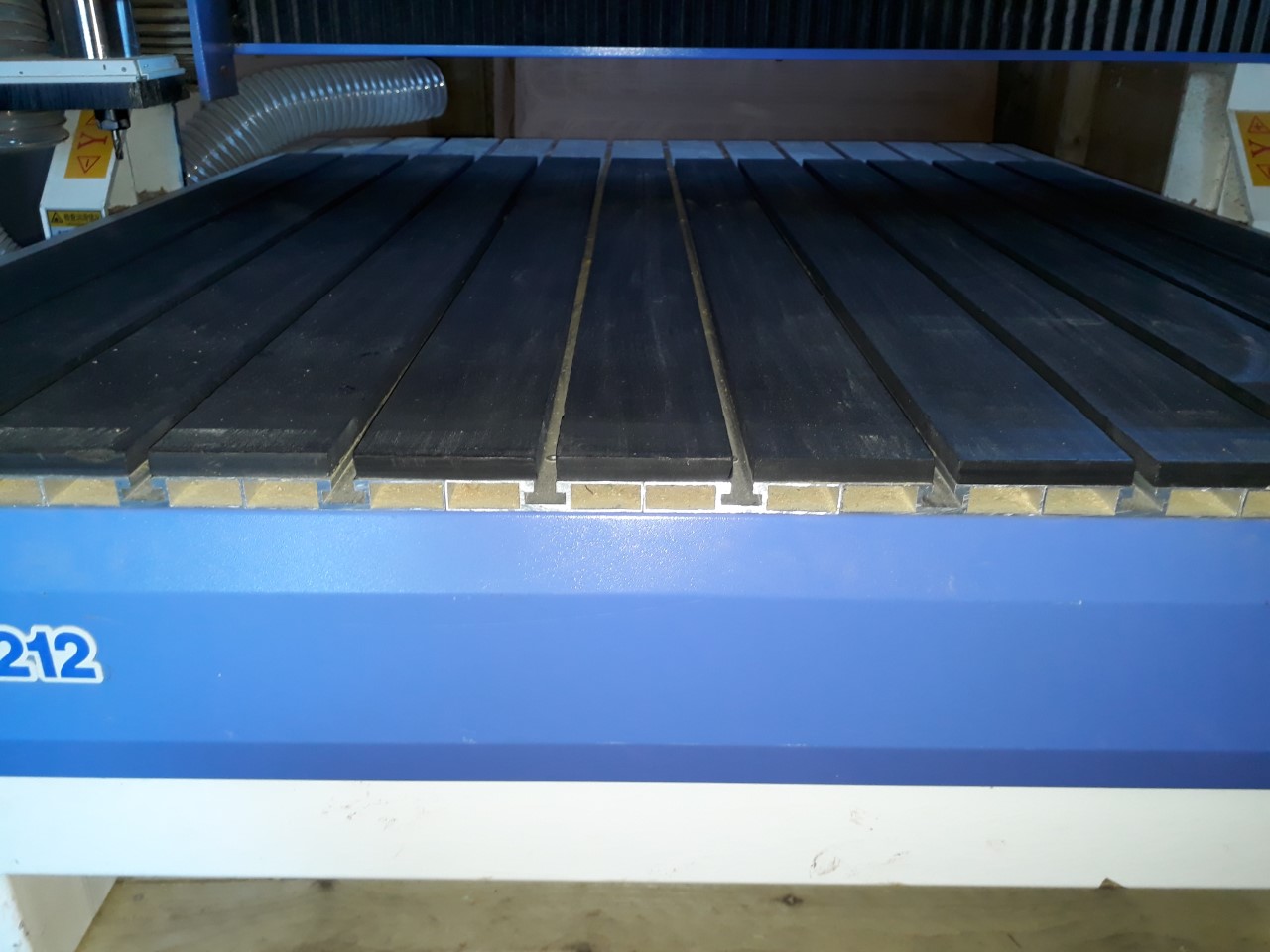

    Josh do you have a pic without the spoil board on?
  7. #6
    No sorry - my slot things don't go all the way up, must be less than 4ft because my spoil board atm peeks over the edge by about an inch.
    The way I had it set up was 2 clamps closest to me and one at the back with wood under the clamp... not very safe - as I'm the obly one trained with using it - trying to find a user friendly way for people to set the bed up when I'm on holidays and such.
