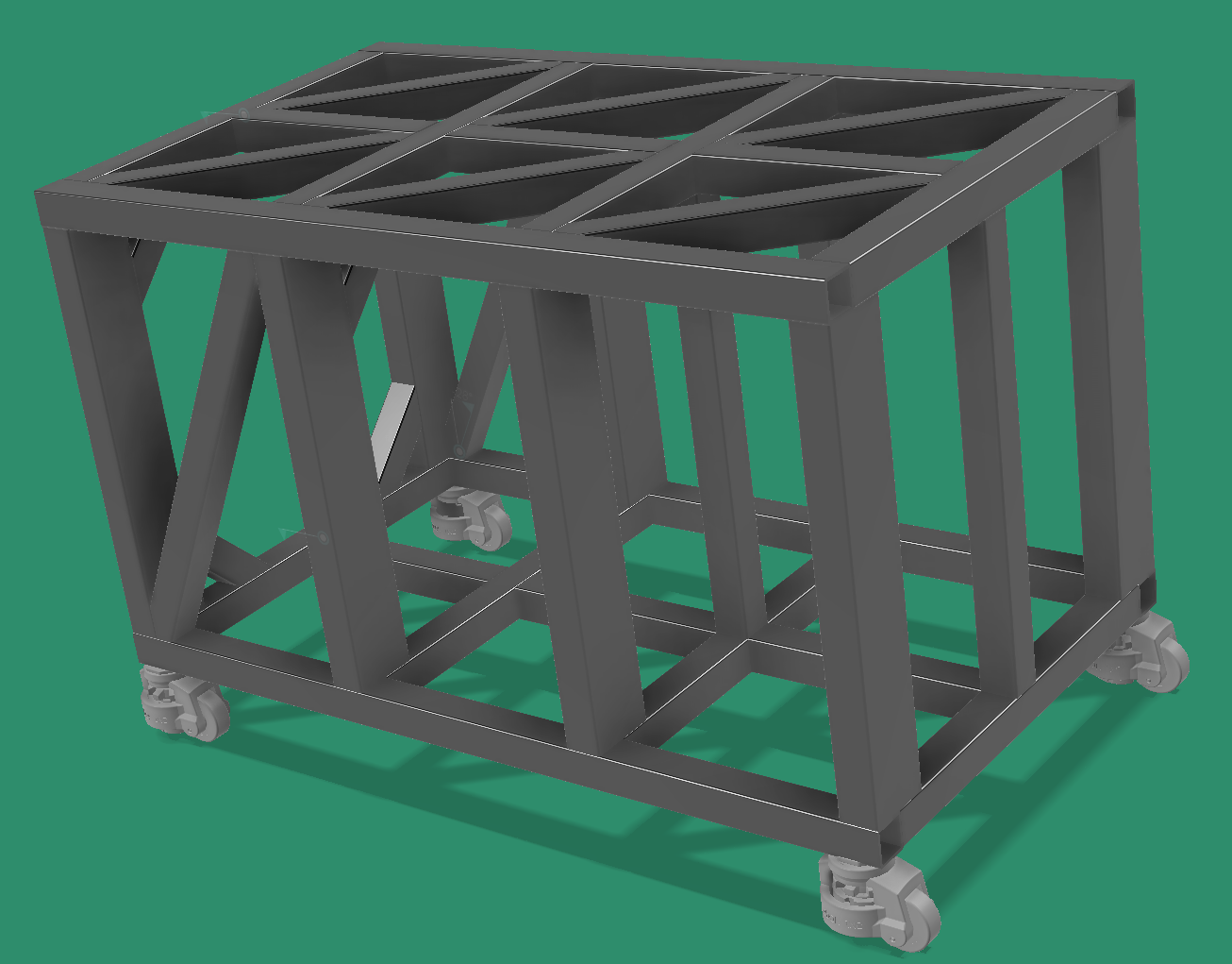

    I'm thinking about investing some time in designing a small (~800x600) router to cut upto and including aluminium. My existing work area supports a bench-top design, sat on a DIY pine workbench. But, is there a genuine advantage in knocking up a free-standing steel frame for this. Would a steel frame, say 100x50x3 box (it's a good price, and the online deflection calculators suggest it's a good geometry) offer advantage over a floating bed made from the same, sat on top of a bench top.

    My machine is a 900x600 but it's footprint is about 1200x1250 so you would need a large bench for a start.
    Without some extra mass the thing would bounce about all over the place because the forces involved are a lot more than anticipated.
    I would always build a frame on which to place the machine but it needs to be designed correctly.
    Eddy - aha, I was preoccupied with rigidity, not mass - something of an oversight of mine.
    So, I've been playing with Fusion 360, as much to try to get some familiarity with the software, using the idea of a frame as a starter project...

    Design based around 50x50x4 and 100x50x4 (shamelessly stolen from Neale's AVOR design), external dimensions of 1200 x 700 x 600(h). I'm not afraid of cutting / welding steel (or at least gluing steel together with a Tig torch), but there must come a point where you say enough is enough. I'm looking at this in cold light of day and thinking that I'm creating a design for a somewhat top-heavy frame, be a bit of a git to weld up (and use a hell of a lot of argon up in the process). I've found myself randomly adding bits to the design - the braced bed, the bracing for the internal space to house a small compressor, and maybe a suds sump, partial bracing for the frame - but it's at this point I decided to take a step back and question my sensibilities.
    (To do - add the top rails - similar to Neale's, as a raised set of rails on the top of the frame)
    Basically... when do you stop adding steel? Is a design like this remotely sensible?, or is it steel-work for steel-work's sake? Are there any pointers or directions into what the requirement for a frame is, and how to best approach a design?

    Personally, I reckon that's a bit over-built. Mine uses 3mm steel, not 4mm, and although my pictures don't really show all the bracing/triangulation that well, I've used a lot less than yours. You could probably do without all that triangulation under the bed, although it does depend on what the bed is going to look like. Have you thought about how you are going to sort the bed? That's the kind of thing that it's worth planning at this stage, just to make sure that you don't paint yourself into a corner. Also, where are the X rails going to be mounted, and what's the gantry going to look like?
    Unfortunately, there doesn't seem to be any magic formula, and the best thing to go on is other people's designs and their experience with them. Mine could be a little heavier, although I really haven't seen any structural weakness in it that worries me, even when doing machine-shaking detailed 3D work.

    My preference for 4mm over 3mm was partly due to deflection calcs (which I don't understand but can sense that one number is better than another), cost (not much in it) and more chance to hold a thread (although nothing at this stage is tapped). The bit I hadn't done was add the final two horizontal members on top of the bed - very much in keeping with your design to mount the rail. My intent was to measure and order the steel, and spend the next few weeks welding on warm days, and designing the gantry on cold days... but you might guess that much of the gantry would be somewhat familiar (I do like your design).
    The bed, and the bracing beneath the bed... the bracing from the maxim that more is good (but you can see that it's at this point I take a step back and wonder if I need to buy shares in a welding or steel supplier) and providing some bed rigidity and also some support for the bed itself. The bed - I haven't thought too much above but imagine a 15mm Ali sheet bolted to the bed frame, shimmed or skimmed, or both.
    Plans for more bracing under the centre - top to bottom but I have a strong desire to keep the right bay open for storage - controllers/computer/services and just tool storage.
    Painting into a corner?, that's kind of where I was losing confidence with the number of acute angles for bracing - I can see it being a bit of a git to weld all that and it's starting to feel heavy just on screen. And, at the end of the day how much is really necessary. That's when I tried to google about the effects of triangulation and bracing, but I think I'm using the wrong search strings.
    Yours, I think you are targeting hard woods, from memory?, or have you done any aluminium? My areas of interest are light alloys and laminate, plastics etc. I'd be interested if you have had success with your design on similar.
