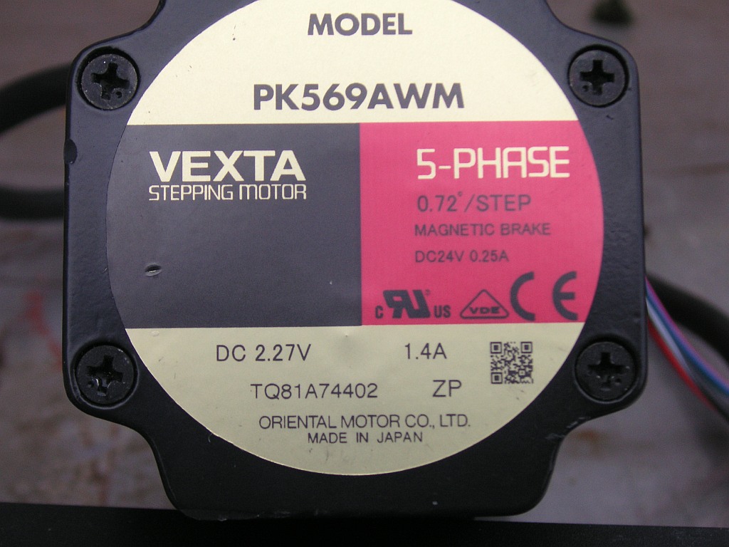

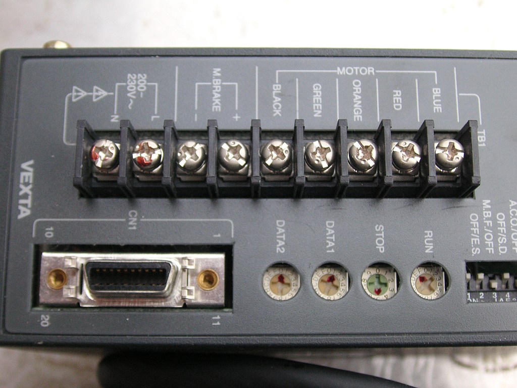

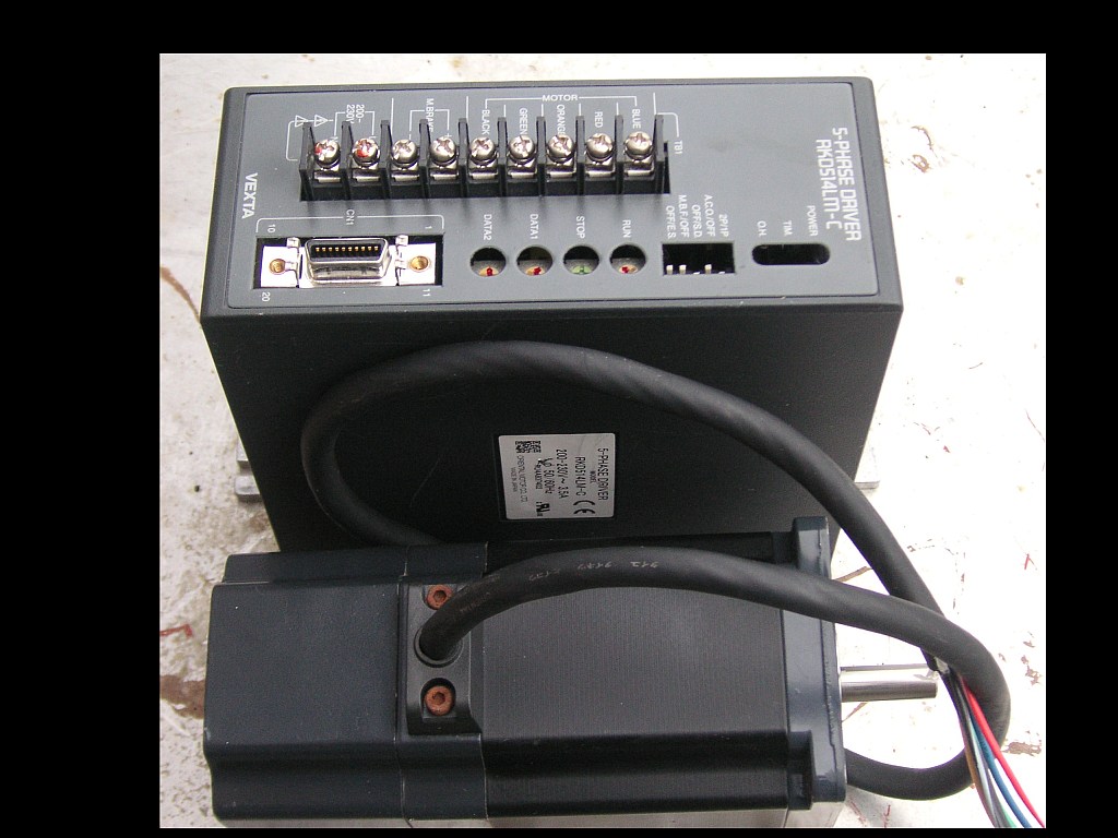

    I have Yaskawa sevo's on my mill with built in brake controlled by the driver. I also am building a router at the moment and using a servo with a brake. I also have Vexta stepper motors with built in brake controlled by the driver. They are industrial stuff but can be aquired relatively cheaply with plenty of Ebay searching.

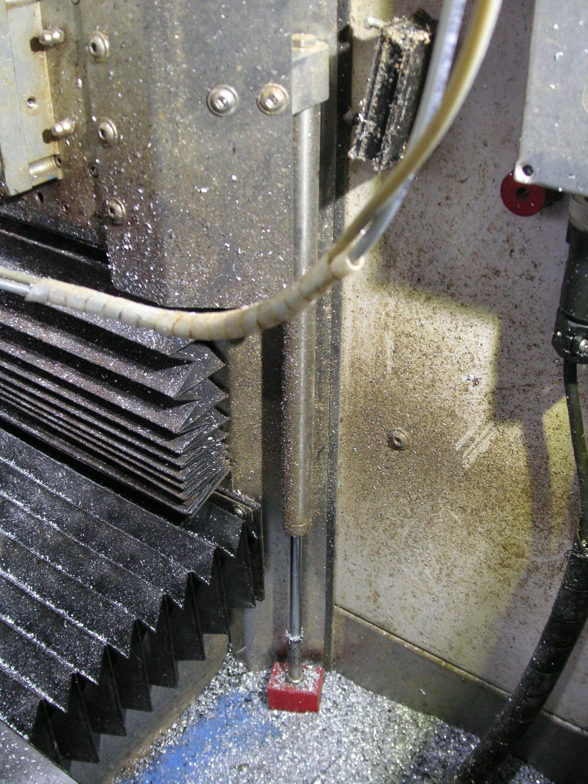

    Gas struts can be quite a good solution, (need to get one with no built in damping ), c/balance weight can be a bit problematic finding room for it to travel in and also control any bouncing with fast movements. Both solutions are IMO second choice solutions.Click image for larger version.

    Hi John
    Thanks for reply and photos, very helpful.
    On closer inspection a gas strut is going to be awkward to mount because of stroke length. Not impossible but a bit of a hassle. I haven't discounted this yet as I like the "assistance" it provides to the motor when lifting the table. Maybe I will end up with both strut and brake working to complement each other.
    In regards to the braked stepper set up I have a couple questions:
    I am interested to know, in terms of £, what is relatively "cheap" in your mind? - based for example on the Vexta example you show. - what would you pay?
    Secondly if I sourced stepper and driver without a brake I think I could add a brake set up, I guess I could control the brake either from my motion control board or simply release brake when drives are powered up.
    Post a photo and explain the nature of the problem, there are simple engineering solutions which can place you a mounting point in "thin air" ;-)

    I do actually have strut and a brake servo on my mill for the same reason.
    Cost of vexta steppers is very variable depending on how long you search for, very round figures £100 each, 5 phase, 500 steps, useful torque to 3000 rpm, direct 230v connection, I believe the steppers run at 162 v

    Just to be clear thats including the drive and motor in that estimate?
