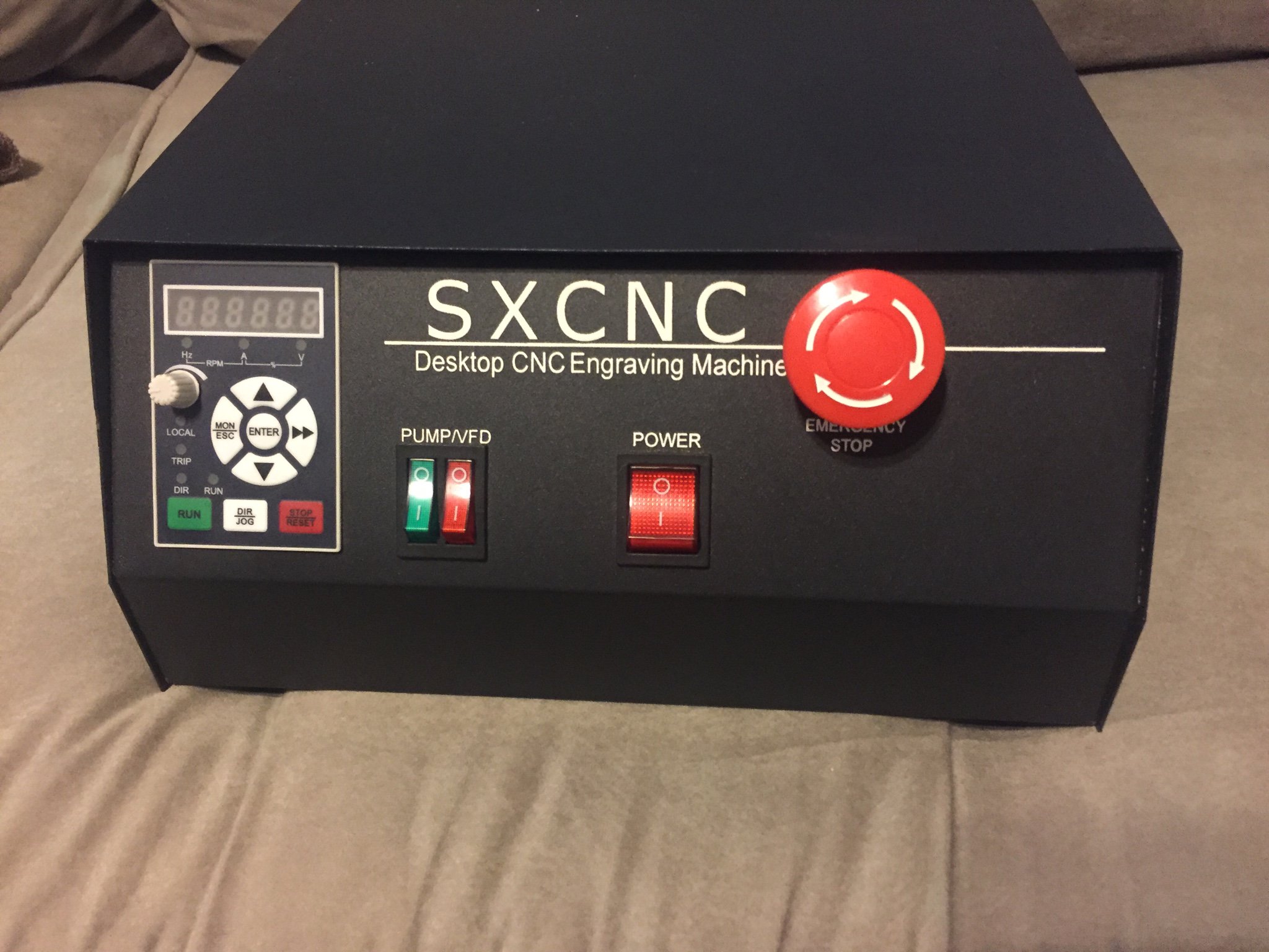

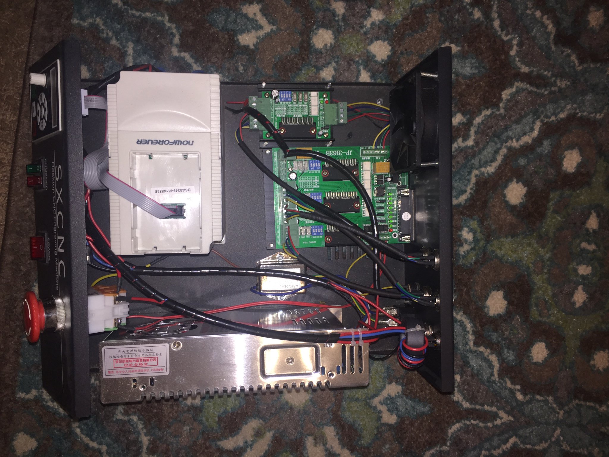

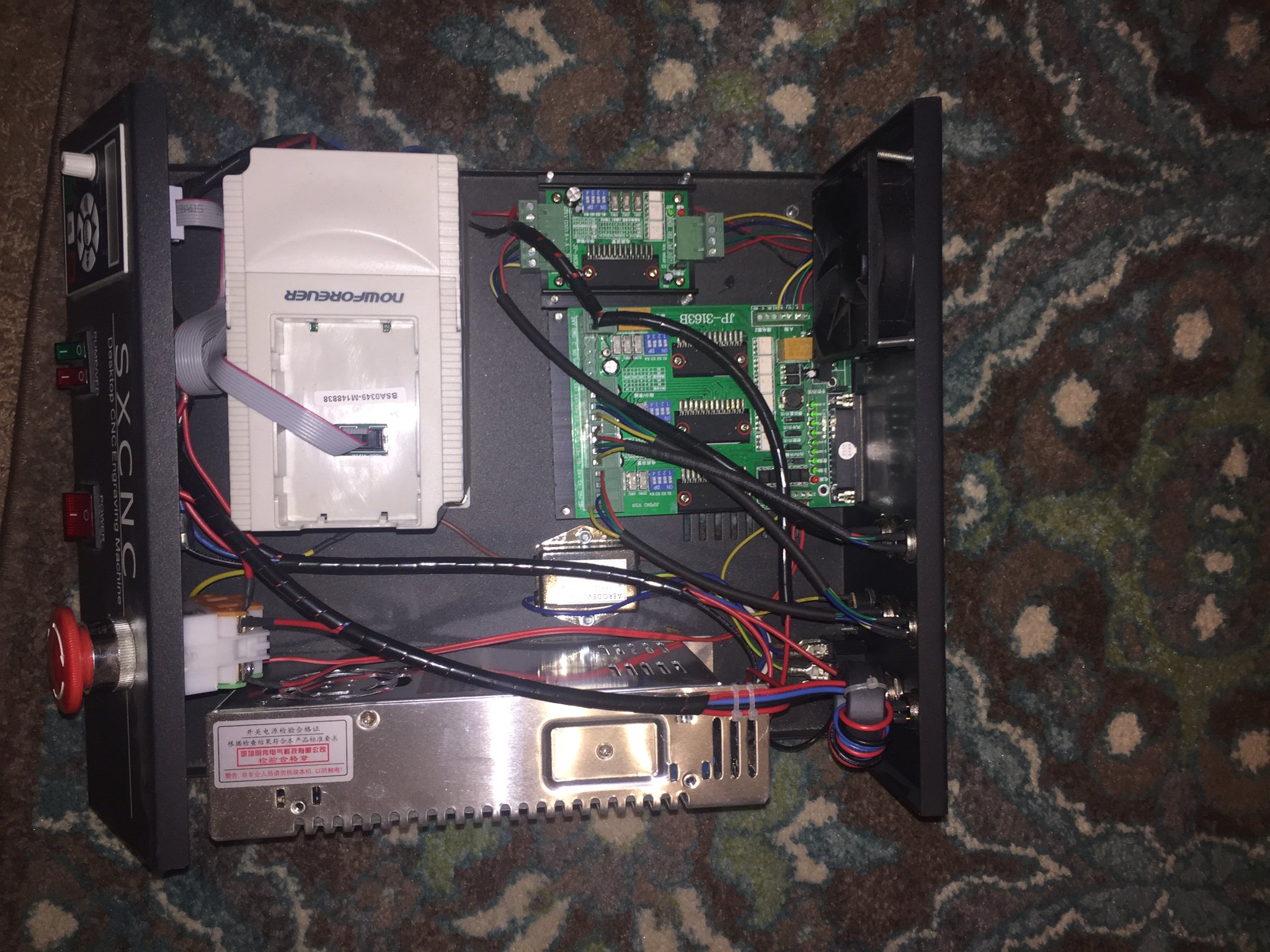

    Ok I do believe I've messed up the settings on the vfd control box... #sigh
    is there a way to reset the settings on the box or do I just go through each setting again and try and put it back to default?
    Also I believe I have found someone who has the same box as me and took photos of the innards so I copied the images for you guys to check out and see what I am dealing with, this person also had a UC100 so there thread did not help me.
    I am attempting to set up Mach 3 to be able to control the spindle/VFD but am I right in thinking that I cannot do this via a parallel port and instead require a UC100 and Controller card?
    I am very tempted to ask if there is anyone that lives near me for a 1 to 1 visit and assistance

  4. #24
    ~It looks like that board has the facilities to control the spindle with Mach3, but they are not wired in. at the bottom right on pic 4, the board is marked C (Com) NO, which is a spindle relay connection and 0-10v GND, which is the analogue voltage to control speed. I would leave it alone until you have the box working with manual spindle control. Then we can look at the box wiring.
    I would not recommend a factory reset on the VFD as you would have a hell of a lot of parameters to sort out. You have probably just taken it off manual control.

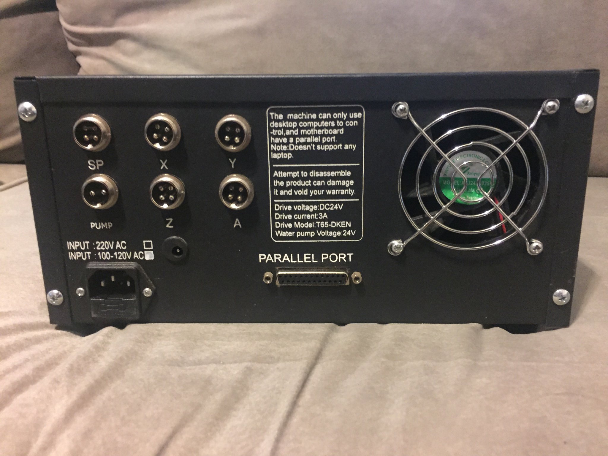

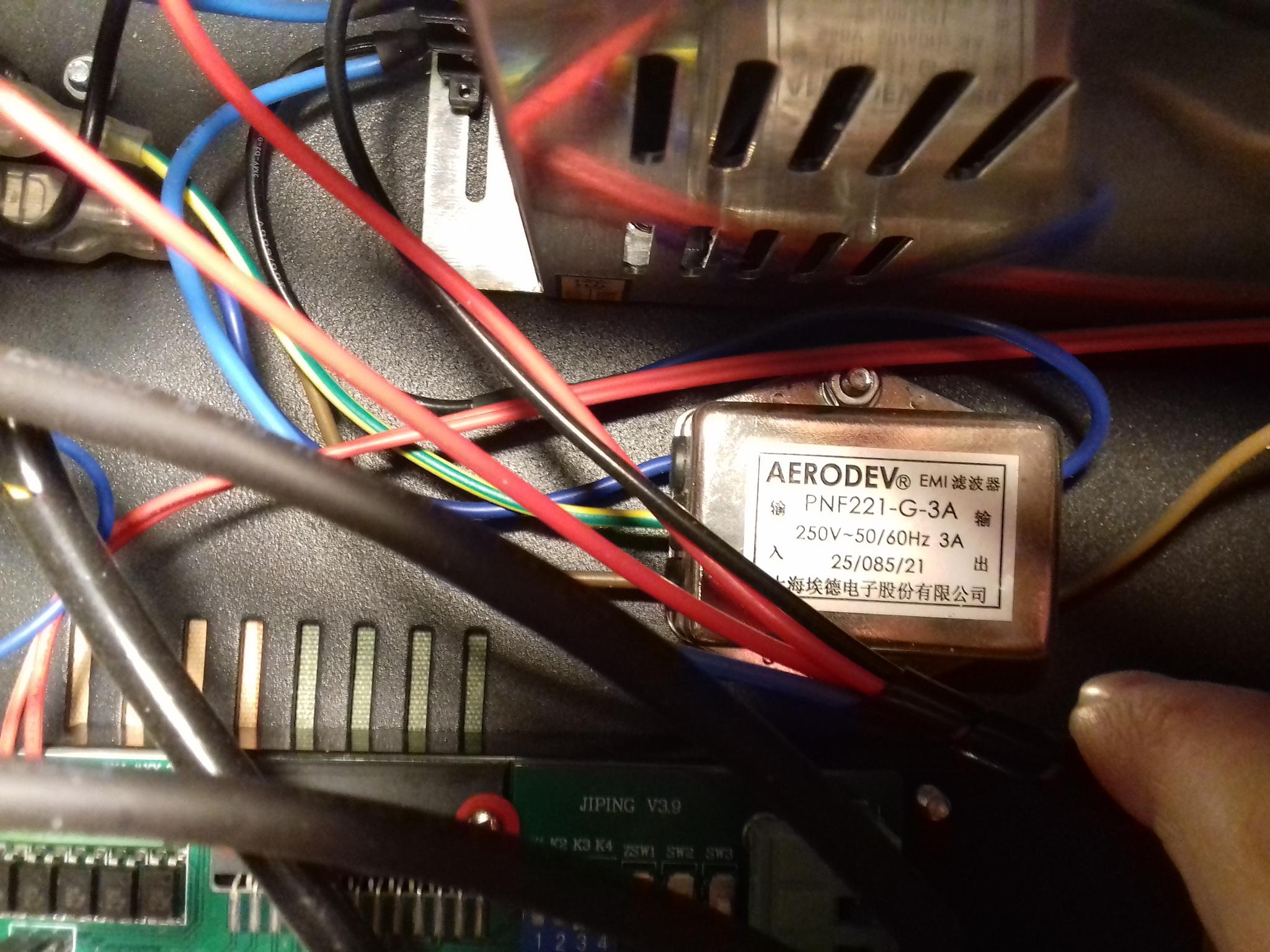

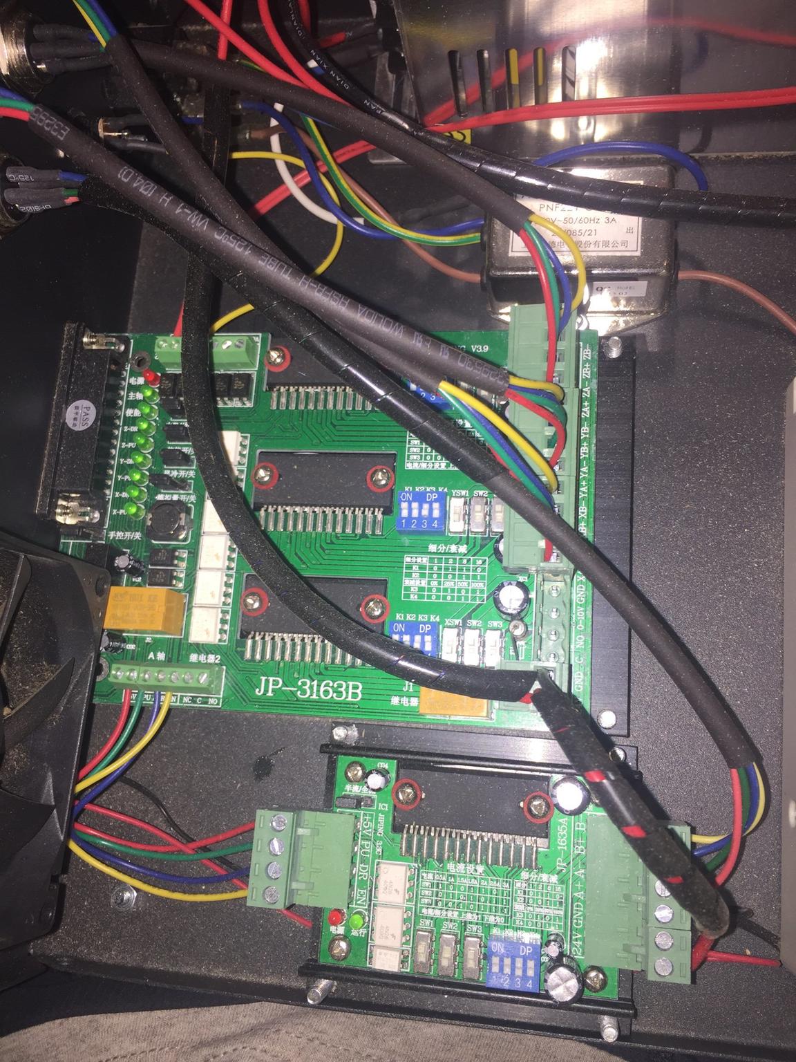

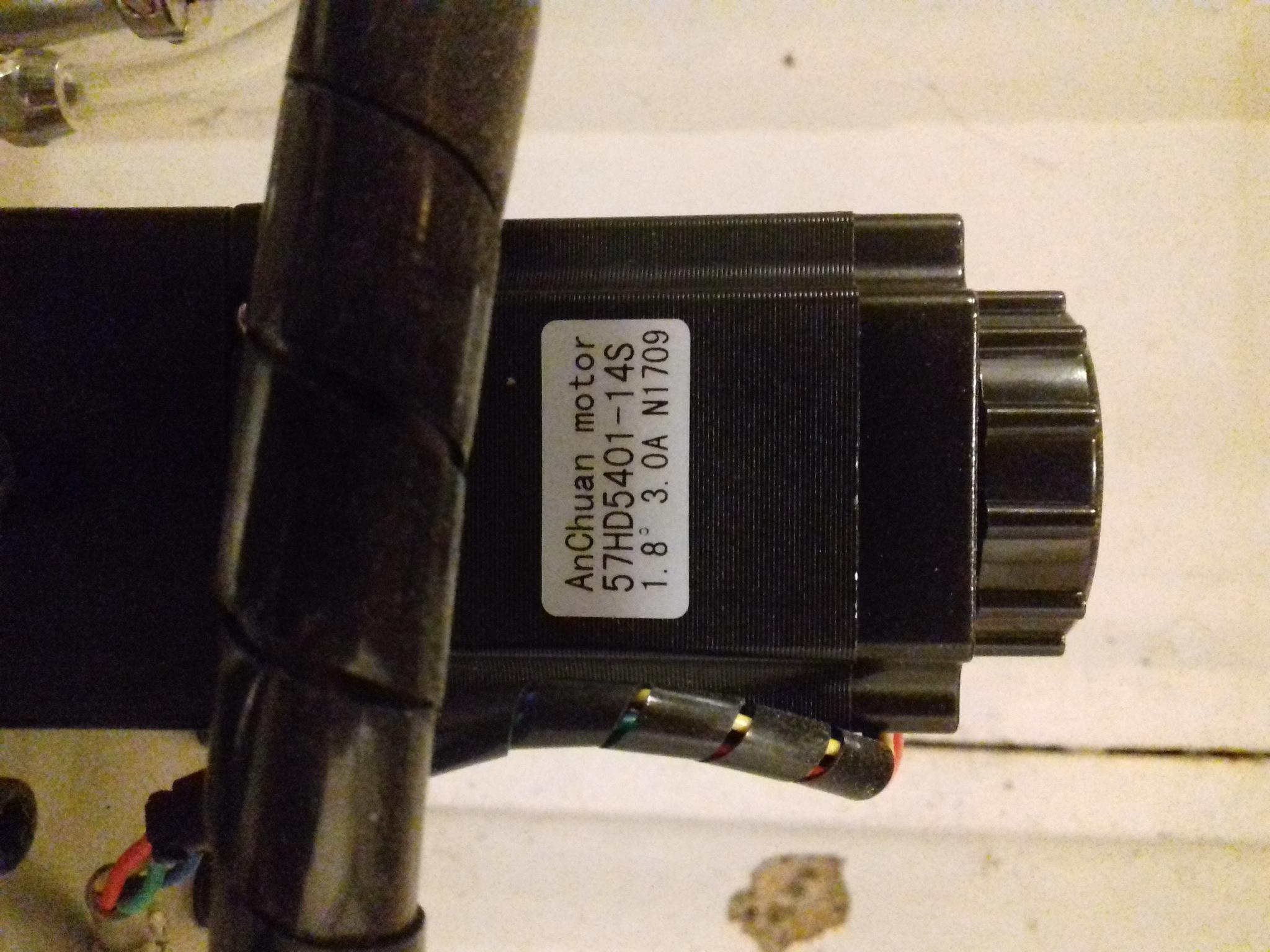

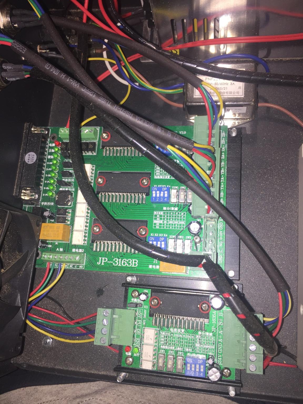

  8. #26
    ok so I think I did the ballscrew pitch check? I couldn't find a how to do video on it so went along like this, placed ruler 0'd with the drill bit, marked the bolts holding the ballscrew's, 0'd the axis and then inputted a move instruction and stopped the movement when a full rotation of the bolt came round... probably way off what you had in mind.
    anyway with this I got the following results:
    Y axis moved 5mm with 4.9535 on mach3
    x axis moved 5mm with 5.0031
    z axis moved 5mm with 3.6062

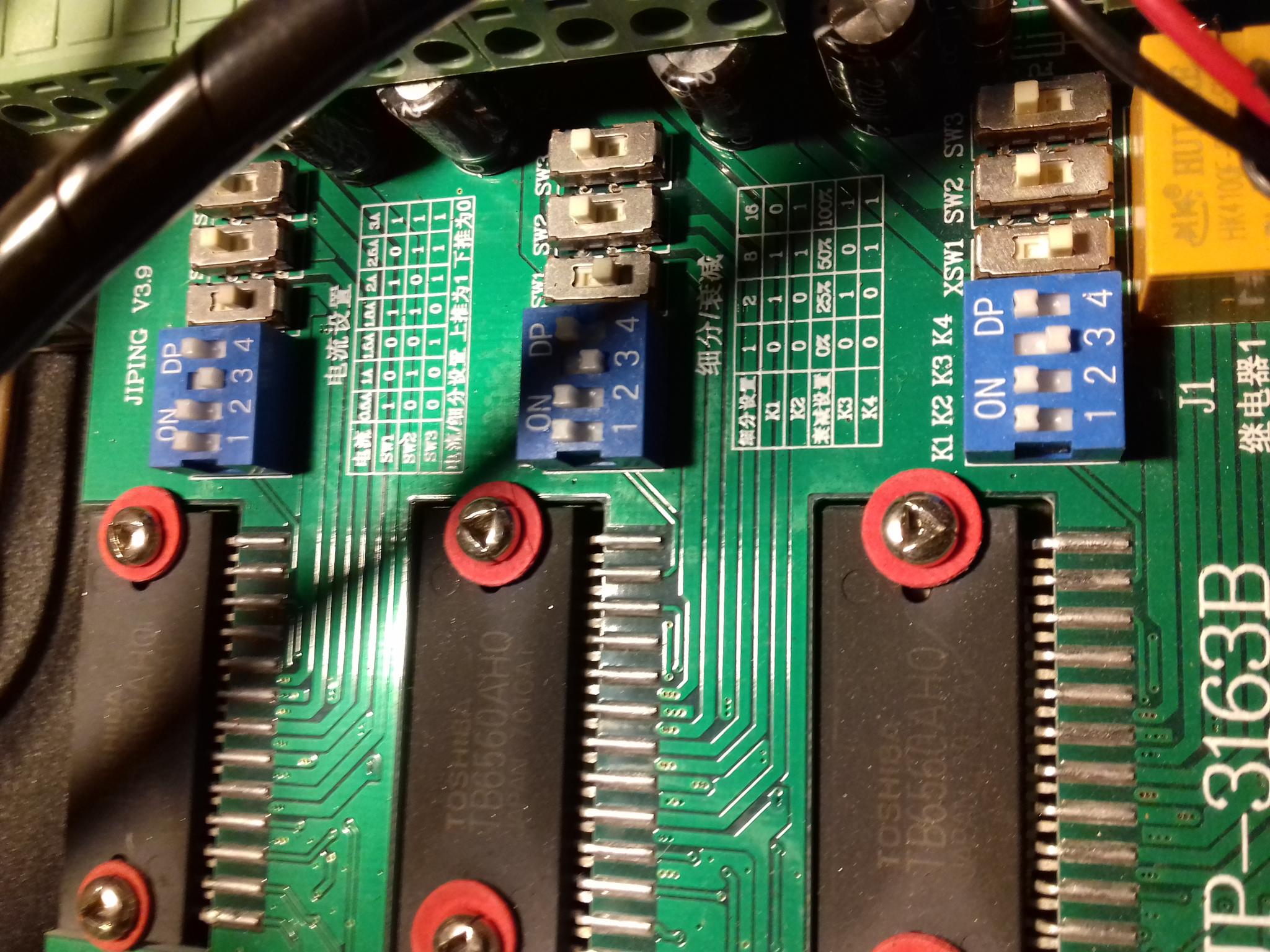

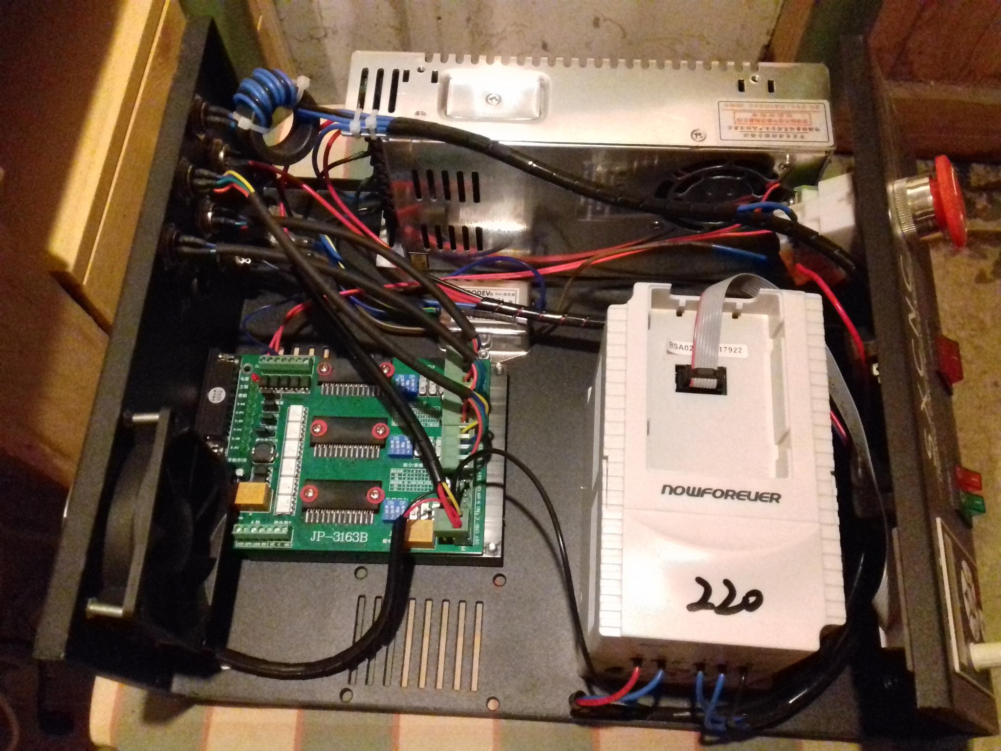

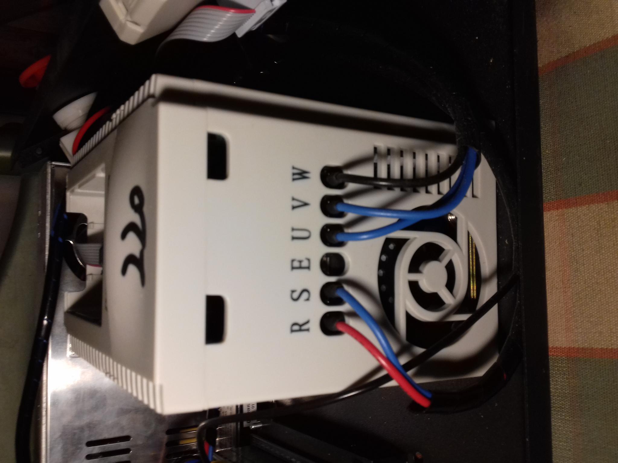

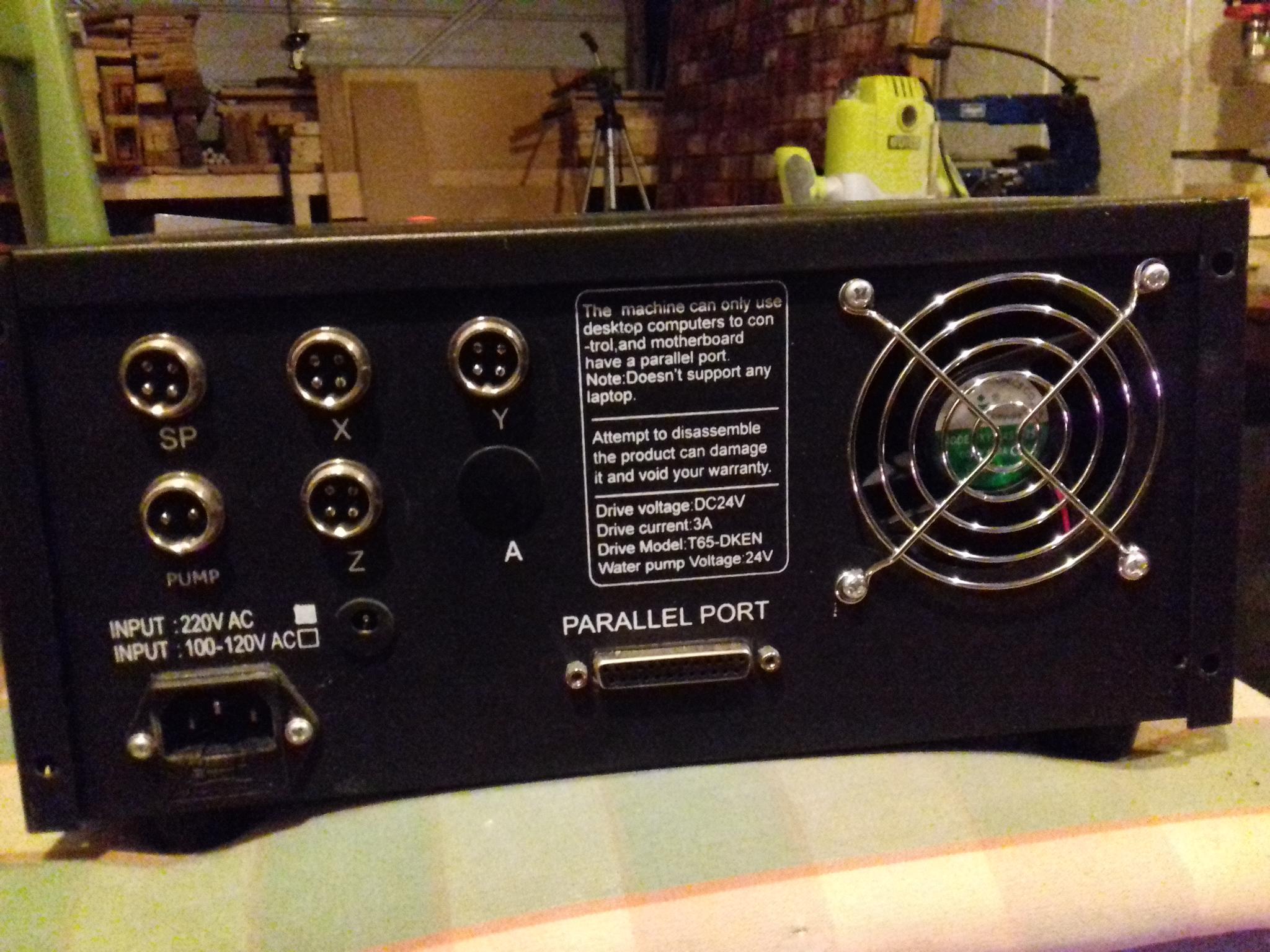

    I took photos of the inside of my control box and you were right its different to the previous photos.
    I found the DIP Switches were set on 3 (K3), the X Y and Z axis were also set on SW1.
    there is a chart but as its in Chinese I weren't 100% sure what it meant as K3 had a 1 marked in 2 (25%) and 16 (100%)

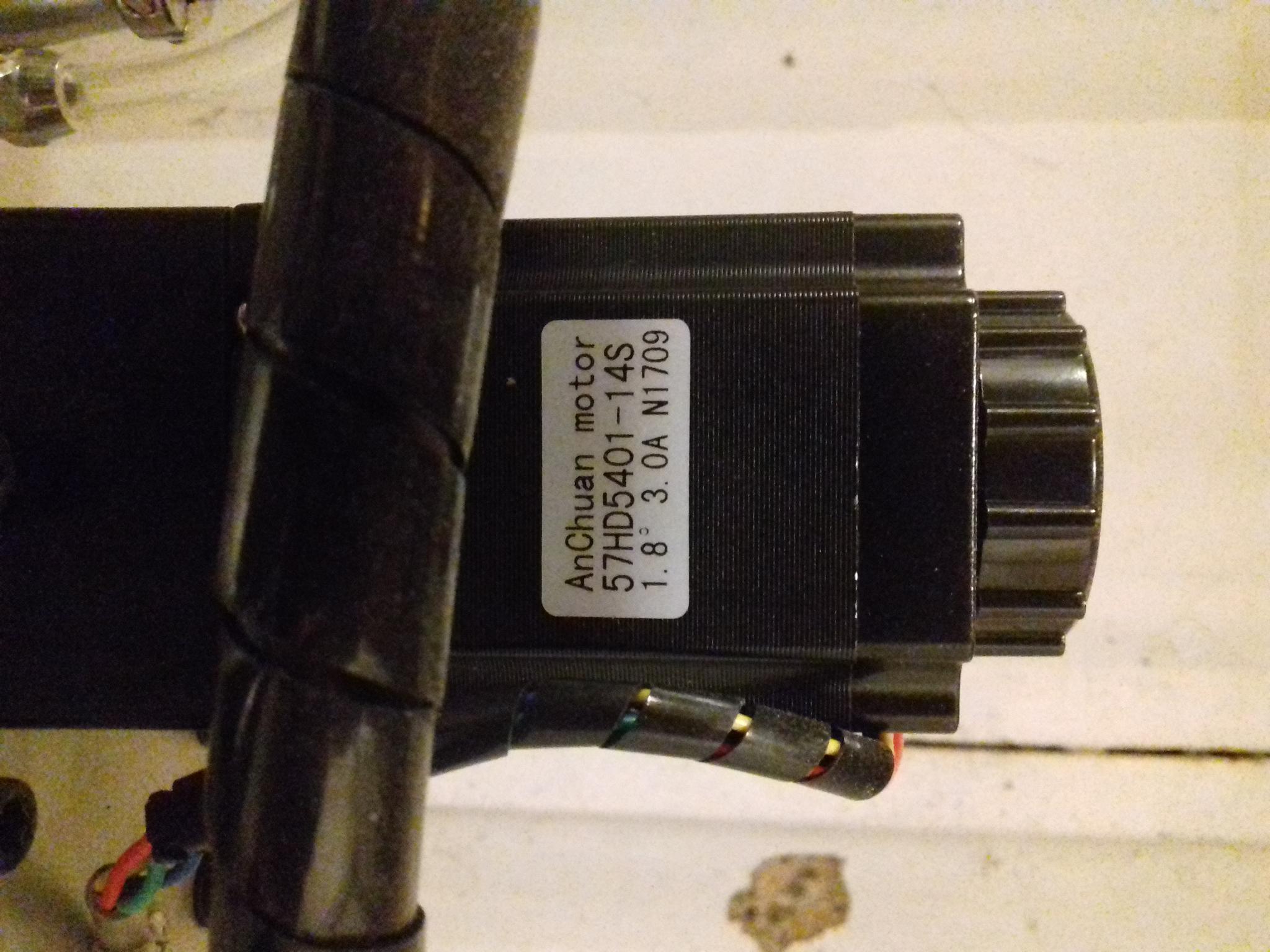

    the motors are 1.8deg
    the power is apparently 220 (written on)
    please see photos

  9. #27
    Ok, so you have 5mm ball screws.
    Now the Sw1 SW2 SW3 set the current range for the drives which must match or be just less than the motors rating. This setting can be set above the motors rating but recommended to keep on or just below.
    In your case looks set at 1.8a for all motors even thou the motors are rated 3A. This is a common practice of manufactures when they use these cheap boards. They do it to protect the drives so not working at maximum and overheating.
    What this means to you is that you are not getting the full power of the motors. However, it's double edge sword because if you turn them up you'll most likely fry the board unless put some cooling on it.
    SW4 it doesn't mention but I suspect it will be to turn motor current reduction on/off. Currently set to ON. What this does is reduce the current to motors when at idle.
    The amount of reduction is probably set by K3 K4. Currently set to 50% which is a standard current reduction on drives.
    K1 K2 set the Micro stepping which looks to set at 8. Which means 8 x 200=1600 Micro steps.
    However, I find it strange jumps from 2 to 8 because usually there's a 4 so can set 800Ms which is a common setting. So I'm not sure I fully believe these markings.
    However, it's easy to find out now we know the pitch because the distance traveled will be exactly half or double what we set if wrong.
    So start with what it looks to be set at and will take from there. So enter these settings in Motor Tuning.
    One note makes sure you select the axis in motor tuning by clicking the axis buttons on the right-hand side when in motor tuning. Also, remember to save before moving to next Axis other wise you'll lose the settings. Also when you input settings into boxs click enter before moving to next box.
    Enter these.
    Steps per = 320
    Velocity = 750
    Acceleration = 300
    Step pulse =0
    Dir =1
    These are very safe setting so should work. If you have OK movement but travels wrong distance then probably because switches K1 K2 are not setting MS to what they say they do, which again happens often on Chinese drives like these.
    So if traveling wrong distance got 2 options. Change the steps per to exactly half or double 320. If moves half the commanded distance then double the steps and vise versa.
    Option #2 let mach 3 do all the work for you by using the SET STEPS PER UNIT feature on the setting tab.(just above Reset)
    This will ask you for distance to travel. Then it will travel ask you how far it moved.
    So you'll need to mark the table or setup a reference point. Then accurately measure how far it moved. Digital Vernier gauge is good for this.
    Can either measure by hand or Open the gauge up full and Zero it then let the machine push it closed.
    The large the distance you can measure over the more accurate it will be.
    This is good way to quickly set steps per if your unsure. While not always spot it gets you very close.
    If machine isn't moving or moving badly then will need a video.
    Question what computer are you using. Desktop or laptop.? And what cable.?
    If machine isn't moving or moving irraticly then often Parallel cables give troubles so try another cable. It must be Straight-thru or whats called Null Modem cable not an Old printer cable which often cross over the pins.
    If using Laptop then that's most likely your problem. Mach3 doesn't work well with laptops unless using motion control card.
