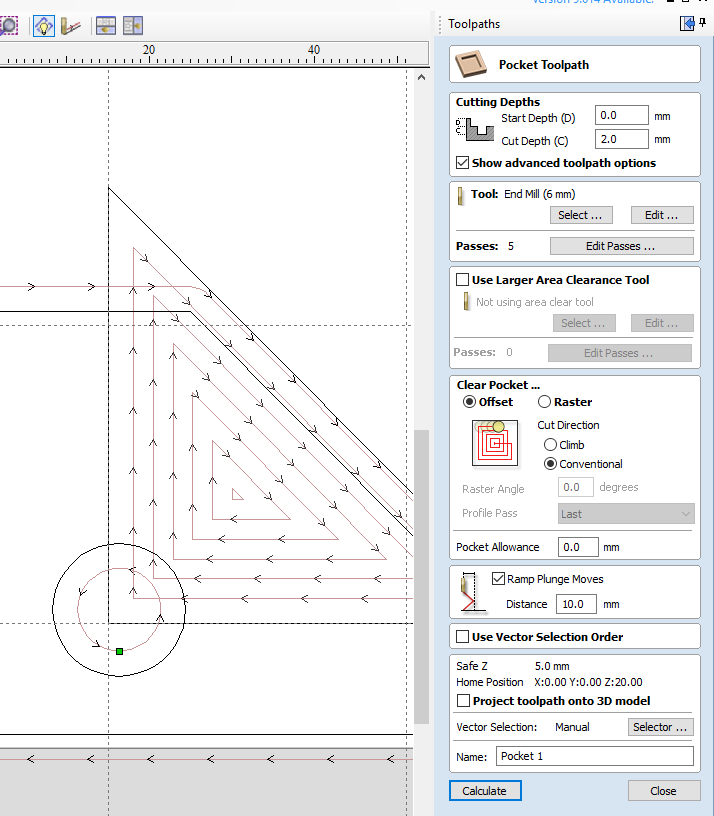

    I should be able to tell the tool path to start the at 6mm and pocket -2mm. At the moment no matter what i change it always pockets -2.45mm.

    are you saying to make a 2d model and create tool paths from that? i cant see how it can know the depths i need to face and pocket from a 2d model. I thought i could make my own model within the model and the machine it out in cam.

    sorry i dont understand why it cant be done the way im doing it and why its complicated. i've seen plenty of videos of people creating a model on fusion 360 and then using the cam to machine it. (https://www.youtube.com/watch?v=o-GBpUZ3piY&t=134s)
    I know i can do the same operating in aspire where i can surface the stock first and then set the start cut depth. so if i remove .45mm from the stock i can start the cut -45mm but to me fusion seems to make the same operation more complex or not very easy to understand.
    aspire is simple:
    Fusion does appear to have better tooling operations so i am keen to understand it more and use it for future projects. i am still new to it but something as simple as removing some materiel and then start the cut from the depth i want seems impossible at the moment.

    Nick, in Fusion360, you can create a model, then use 2D toolpaths on that model by picking chains.
    The only real benefit over using just a 2D drawing, is it allows you to see how the toolpaths are in relation to the model, which is handy for highlighting any issues (usually operator caused!). Regardless of 2D/3D toolpaths, you still have to ensure heights are correct for each toolpath, and you've set the part zero at the correct place.
    Industry standard is you set Z zero on the surface and work downwards, but in Fusion you can set part Z zero wherever you want and adjust heights accordingly. If you're unsure about the heights, you should be able to go to a side view, and when altering any of the depths, they should be shown on the model.
    Not all the settings may make sense if you're unfamiliar with the settings though, as there are options to alter where the heights are relative to.
