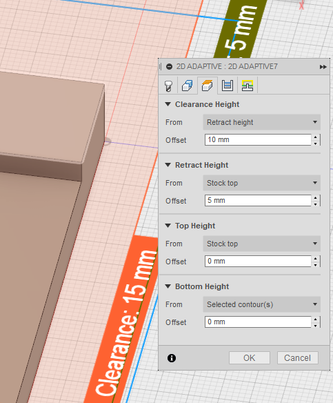

    Hi
    hope someone can explain this to me.
    i have a part that is 6mm in height. My stock is 6.45. i use a facing tool path that removes .45 making the stock 6mm in height.
    I have a pocket that is only meant to remove 2mm but when i run the simulation its removing 2.45mm
    Ive tried selecting the top height from the top of the model in the tool path settings but it still removes 2.45mm.
    can anyone help?

    If I were doing that part, I would make the last setting on the heights tab as "Bottom Height" From > Model Top, and the "Offset" as negative 2mm Not saying that's the correct way to do it, just how I would do it.

    i know its not but ot shoudl take into account the stock is thicker than the part and the take .45mm off the pocket if the stock has been faced.
    the first operating is a face to remove .45 and the next is a hole pocket and the operating after is to pocket 2mm not 2.45mm. On the simulation the z moves down to 2.45mm

    You are mixing things up and trying to make the CAM work the way you think it should.
    It's obvious that you are taking .45 off your stock but referencing your pocket depth as it would be from Top of Stock but your CAM is taking it from the actual Top of Part.
    Setting Top of Stock as Top of Part is the source of your issues, you'll have to work out how to juggle the numbers in CAM to deal with that, a spreadsheet would help in keeping track of the differences required ;-)

    thats correct. i would it expect it to know i already removed .45mm from the facing operation. I have to add a offset of -.45 for the tool path to start at the correct depth but it still pockets -2.45 which is going to make the the pocket deeper than it should be. At the moment the only way i can see is to leave it cutting nothing but it adds machining time. . To me it should know have took that into consideration.
    Unless there is a setting im missing.
    but if the fusion doesn't calculate it that it just adds more time for me creating paths. thank you for your response as always :)
