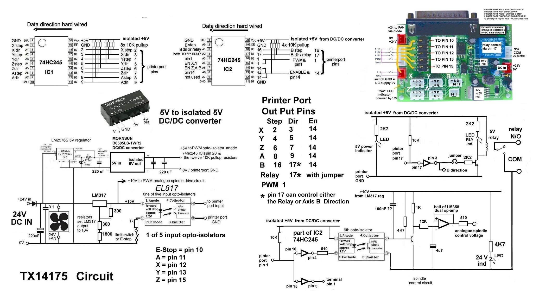

    Hi folks,
    I think I may have fried the bank of input pins on my BOB - it's one of the cheap Wantai boards that you get free when buying a set of drivers. I've found it to be a decent card and as such would like to replace it like for like.
    Having said that, it's a long shot that there's one available, so hit me up with what you've got in the way of simple parallel port, 3-axis, 12v boards...
    Wal.

    the BOB requires a 5V supply if you fit jumpers JN1 & JN2
    or two 5V DC supplies if jumpers JN1 & JN2 are not fitted
Name:	ebay opto-isolated CNC BOB  .jpg
    the circuit diagram is based on photos taken from the net !!
    John
    PS
    I assume the limit switches have NPN open collector outputs
    with just the 5V power connected to the BOB you should have close to 5V
    between the opto-isolator IC pins 3 & 4
    when you connect the opto-isolator pin2 to the input ground with a wire link the voltage across pins 3 & 4 should drop to close to zero volts (0 to 0.7v)
    it should be easy to change and damaged "817" opto-isolators

    simple tester for similar BOB inputs
Name:	BOB input  tester & partial TX14175 circuit.jpg
    TX14175 circuit
Name:	TX14175 circuit.jpg

    Wal's Avatar
    Cheers guys.
    Panic over for now - turns out it was my brain cells that were fried and not the input pins. The switch was behaving differently to how I expected it to - rather than take a closer look at what the switch was doing, I began a campaign of button mashing which lasted well into the night - not a great idea after a full day of assembling the bugger..!
    A clearer head this morning, a quick chat with Clive and a better look at what my switches were up to yielded better results..! (Oh, and restoring my back up .ini)
    Should have it up and running in the next few days.
    Wal.
    no damage done and now working
