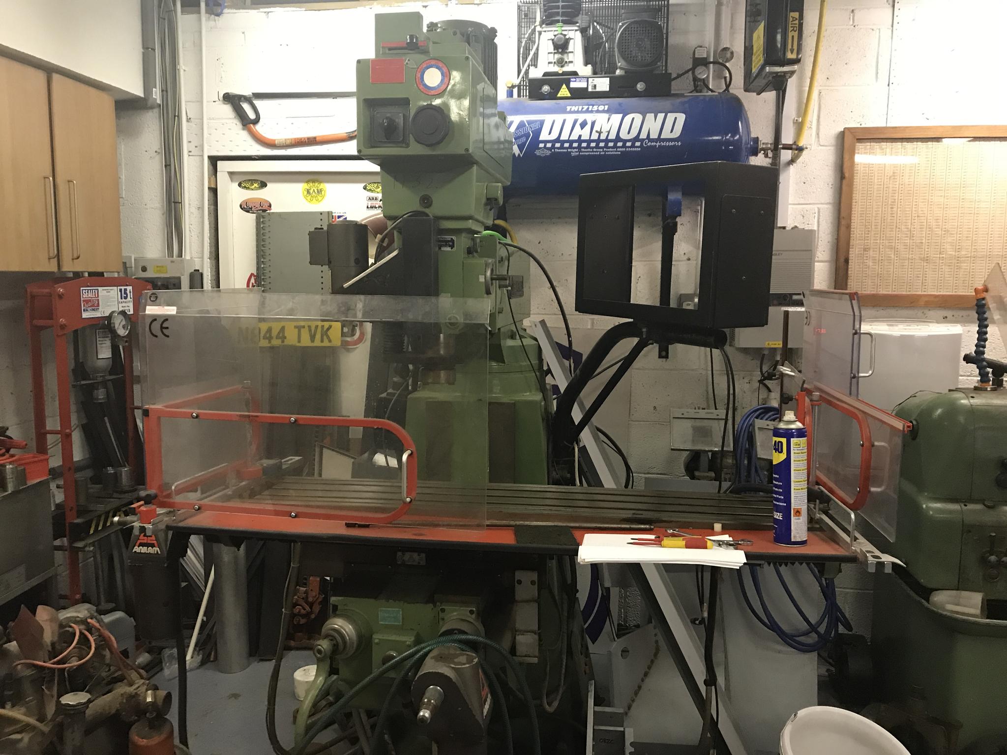

    Hoping for some advice. I came across a Beaver mill (VRP) a few years ago and as it was only £1 I bought it. It has Anilam crusader II CNC controls that don't work. The mill came out of a college and has apparently sat in a corner for many years due to a fault in the CNC controls.
    Roll forward a few years and it's in the way. I need to decide if I go with my manual Bridgeport or sort the beaver mill and sell the Bridgeport. To be honest I fancy having a cnc machine and the beaver mill is slightly heaver duty than the Bridgeport. So it comes down to how practical it is to upgrade the Beaver mill.

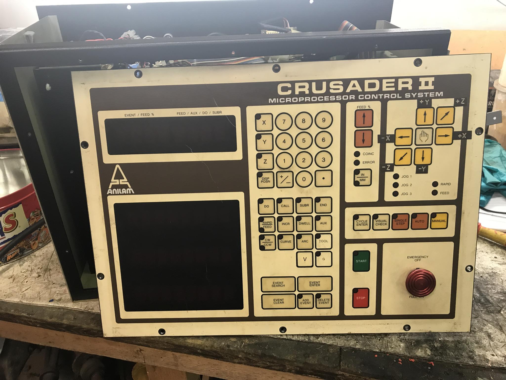

    I managed to get the machine tool tech's from work to look at it a while back. Conclusion was that there is an issue in the Crusader unit. Symptoms were refusal to jog in any direction. Once the override relay was frigged (piece of wood to hold it closed) all 3 axis would traverse. However the X axis would 'stall' after a few millimeters.
    I have stripped the unit and found no obvious poor soldered connections/loose connections. However to be honest the controller is ancient (cards are dated 1981), even if I get it working the link to send code to the machine is a parallel port, etc. In short I don't think it is worth making much effort with. From my limited experience with CNC it gets old very quickly typing in G code at a machine. I wan to be able to design in CAD (use atuoCAD), send to post processor and though to machine.
    So to me an upgrade of the controller is the right way forward.

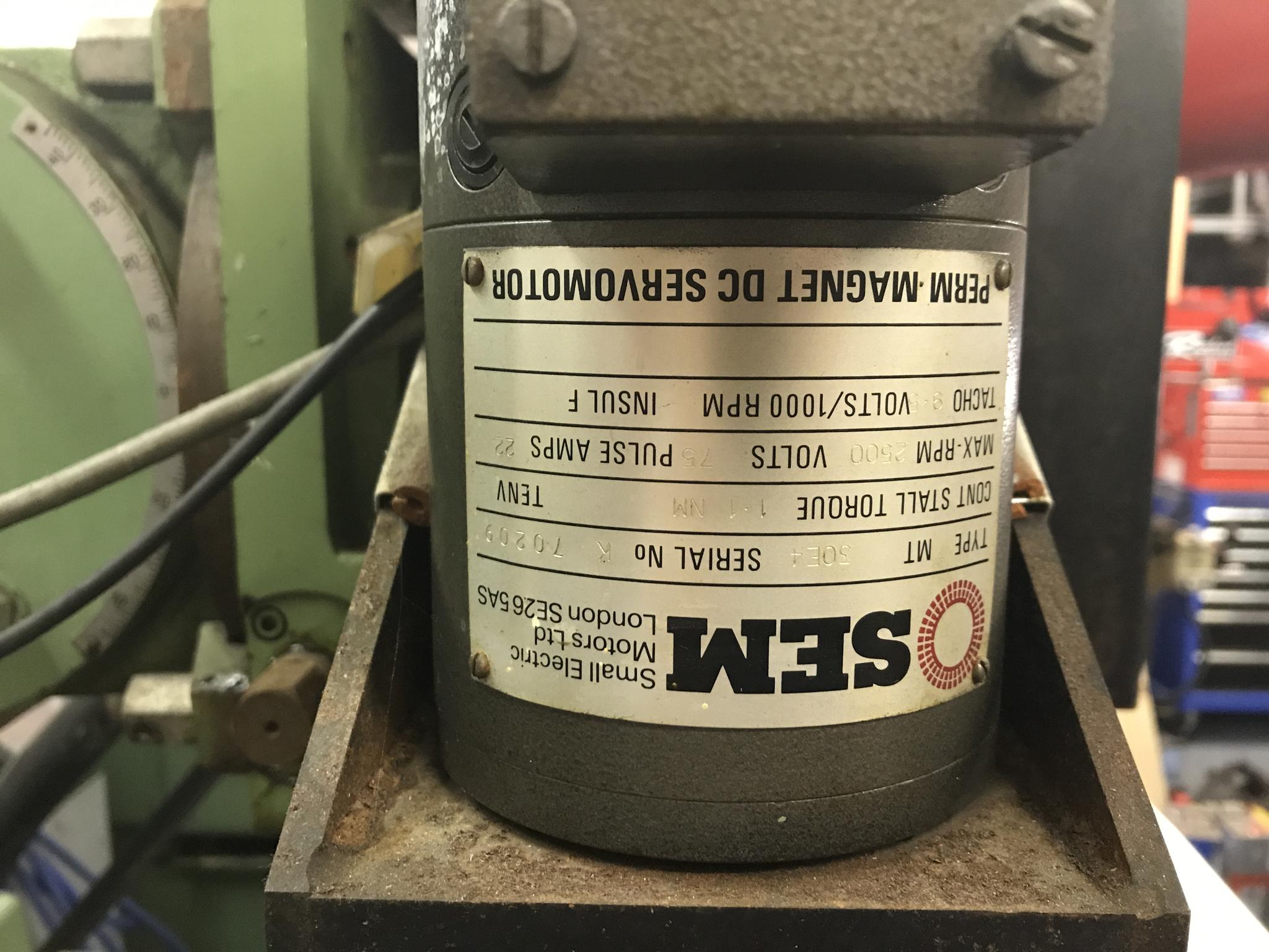

    x and y & Z - SEM DC servo drives (MT30E4's). 1.1 NM stall torque, max rpm 3600, 72 volts. Appear to be fitted with a tacho (7.5 volt per 1000 rpm)

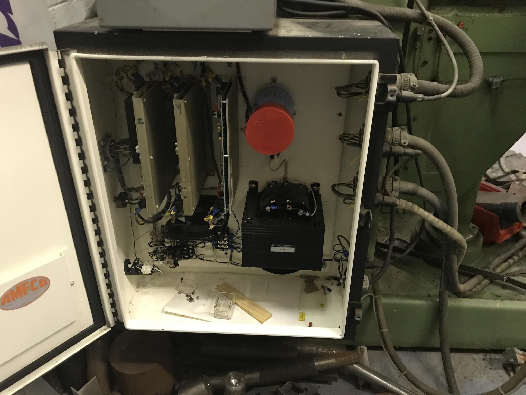

    Drives - not sure - in a cabinet, assume Anilam units

  2. depends how good you are at electrical work.
    its original servo drives will be analogue- so to use those you would require a motion controller that supports analogue servo control
    ie galil, csmio a, etc these will work with mach3/4 (ive never tried mach4 yet) these systems can be fun to wire/ setup and tune for steady movement if you havnt a clue in motion control.
    however- as your motors are quite low torque and voltage you could keep motors and install new step/direction drives ( www.cncdrive.com make these that would be suitable and not over expensive)
    you could also go the cheapest / easiest method and change servos for stepper motors- this would work fine too.

    Your plan is reasonable, however the one component you really need to check, are the encoders actually encoders?
    Given the age of the machine, they could be resolvers (basically the analogue predecessor to digital encoders).
    You can get converters, but fitting new encoders is cheaper. A KFlop/Kanalog combo can be rigged to read resolvers, but it's not recommended, as there are a lot of variables that affect the final accuracy.
    Keeping the existing servos/drives should work well as long as they all still work. They would need a controller capable of analogue +/-10V.

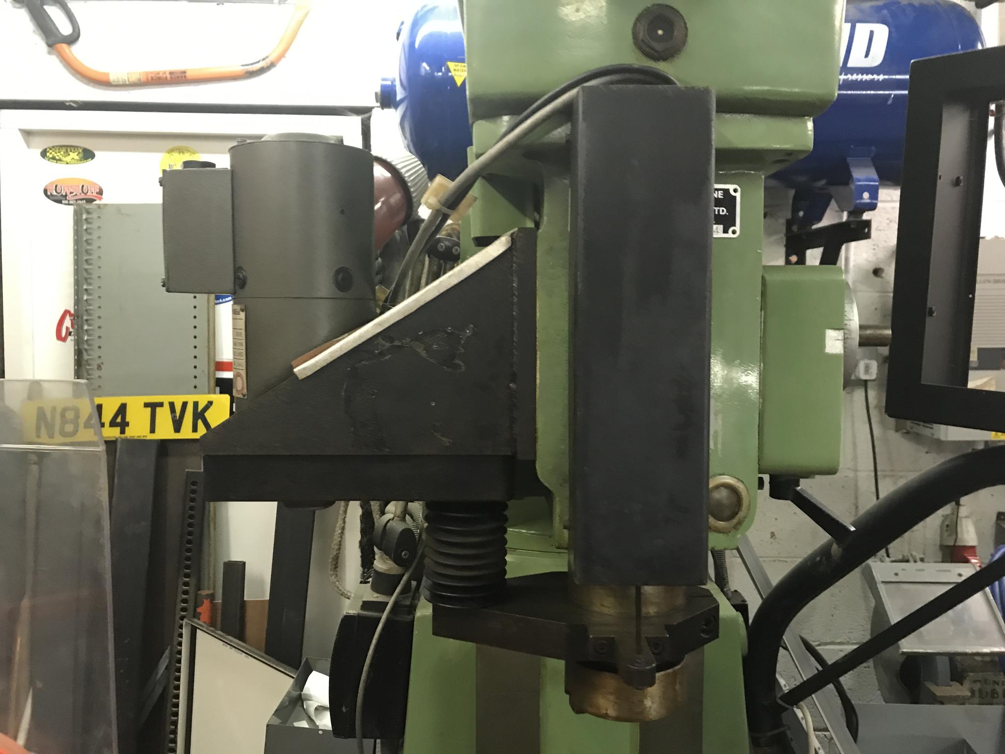

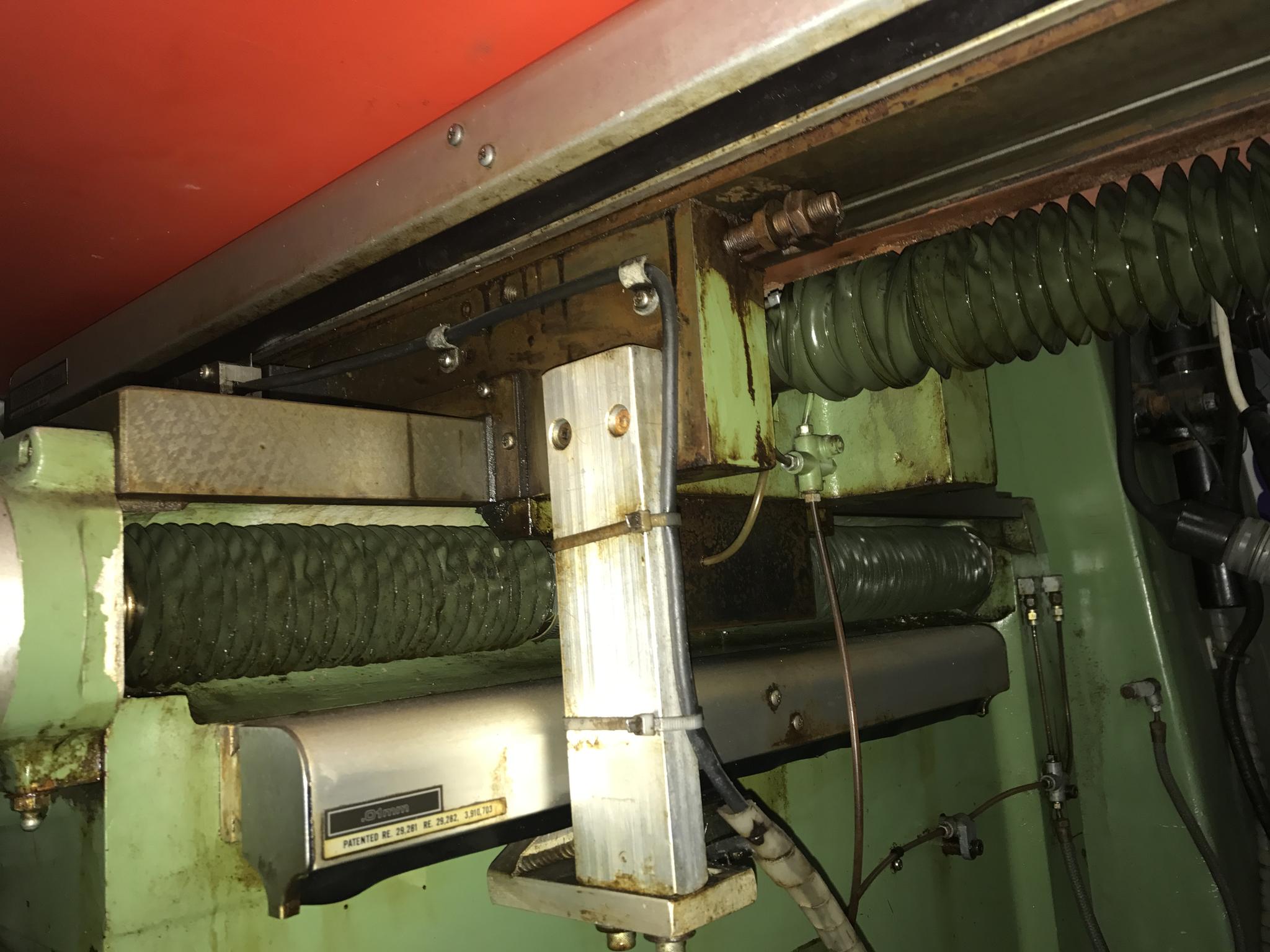

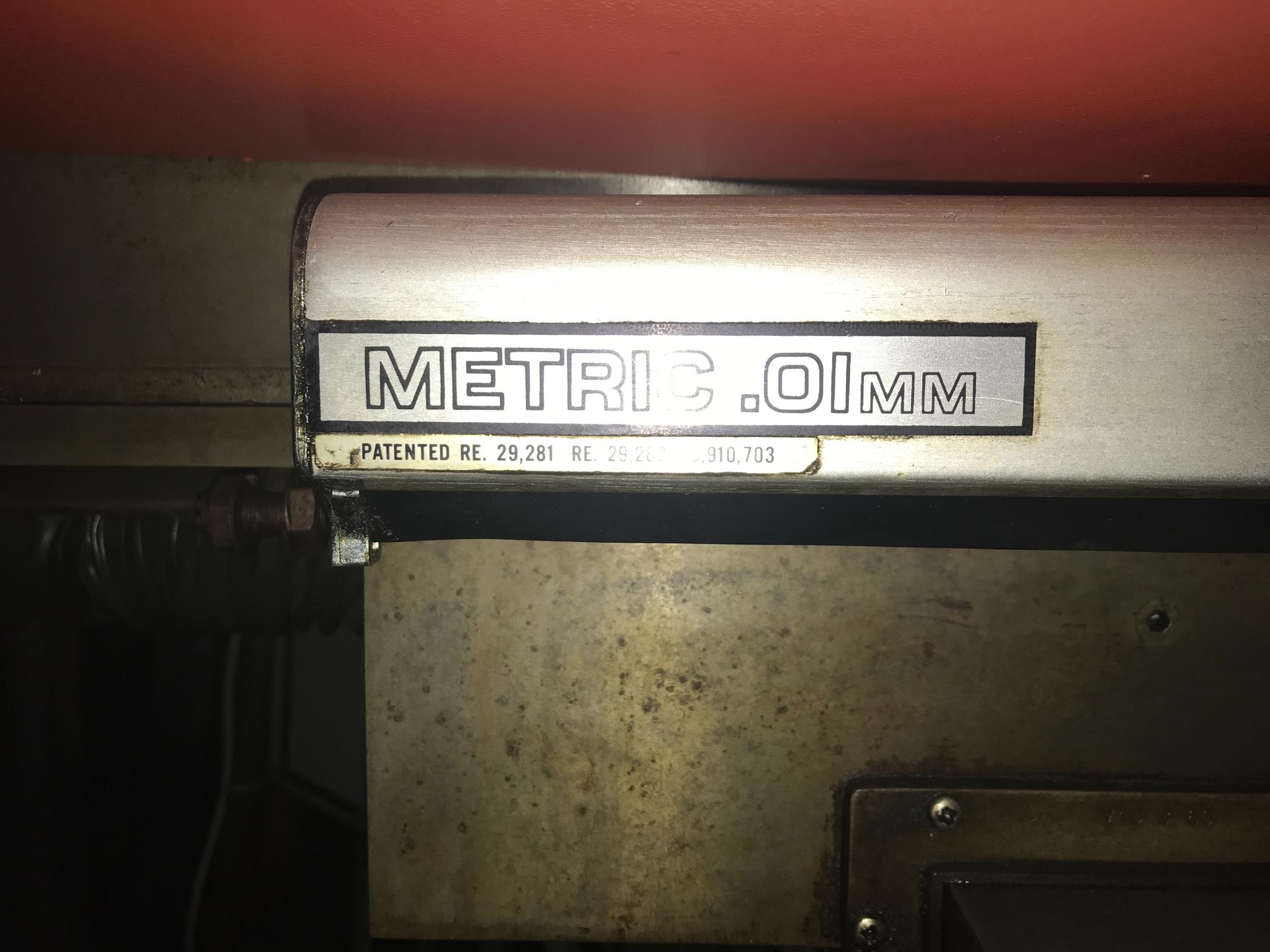

    Thought I would stick up a few pictures:

    Thanks to those that commented. I'll knock up an I/O list and post next.
    Adrian

    I'd personally consider motorising the knee, but you need to consider if the quill alone will provide enough travel, by the time you factor in variations in tool height, and the size of work you're likely to do. DaveK has just done it to his, and uses it to compensate for tool length. I wouldn't be using the knee to provide extra travel for machining, because as you say, they're not designed to running up and down constantly, and certainly not at high speed.
    Scales are good for getting the best accuracy possible, but to use reliably, you really need to use a double closed loop. If you rely on just the scales, tuning servos reliably can be a major problem, as any backlash affects the loop, so can cause some very erratic results.
    Scales do not eliminate homing. Most scales are incremental output i.e they only output what direction they're moving, and how much they're moving.
