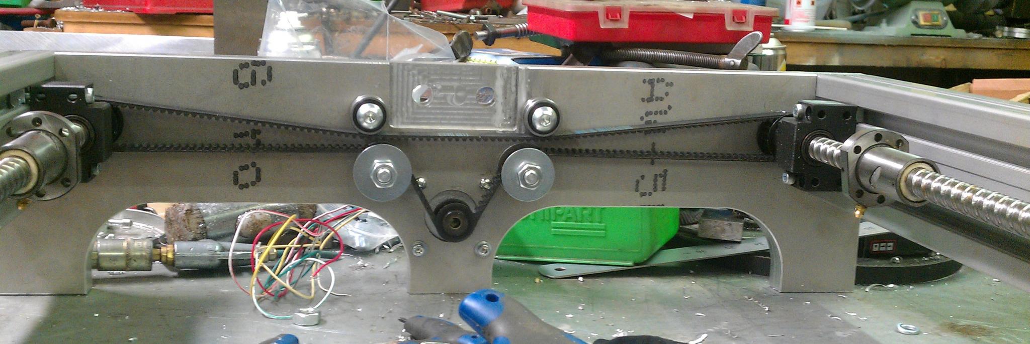

    Use the one that allows the shortest belt arrangement. They will all work equally well as each other but shorter belts are easier to find and implement.
    This is my preferred setup.

    Dean what size is that profile that allows for easy mounting the 16xx ball screw?
    project 1 , 2, Dust Shoe ...
    This one.
    https://www.motedis.co.uk/shop/Slot-...:99999415.html
