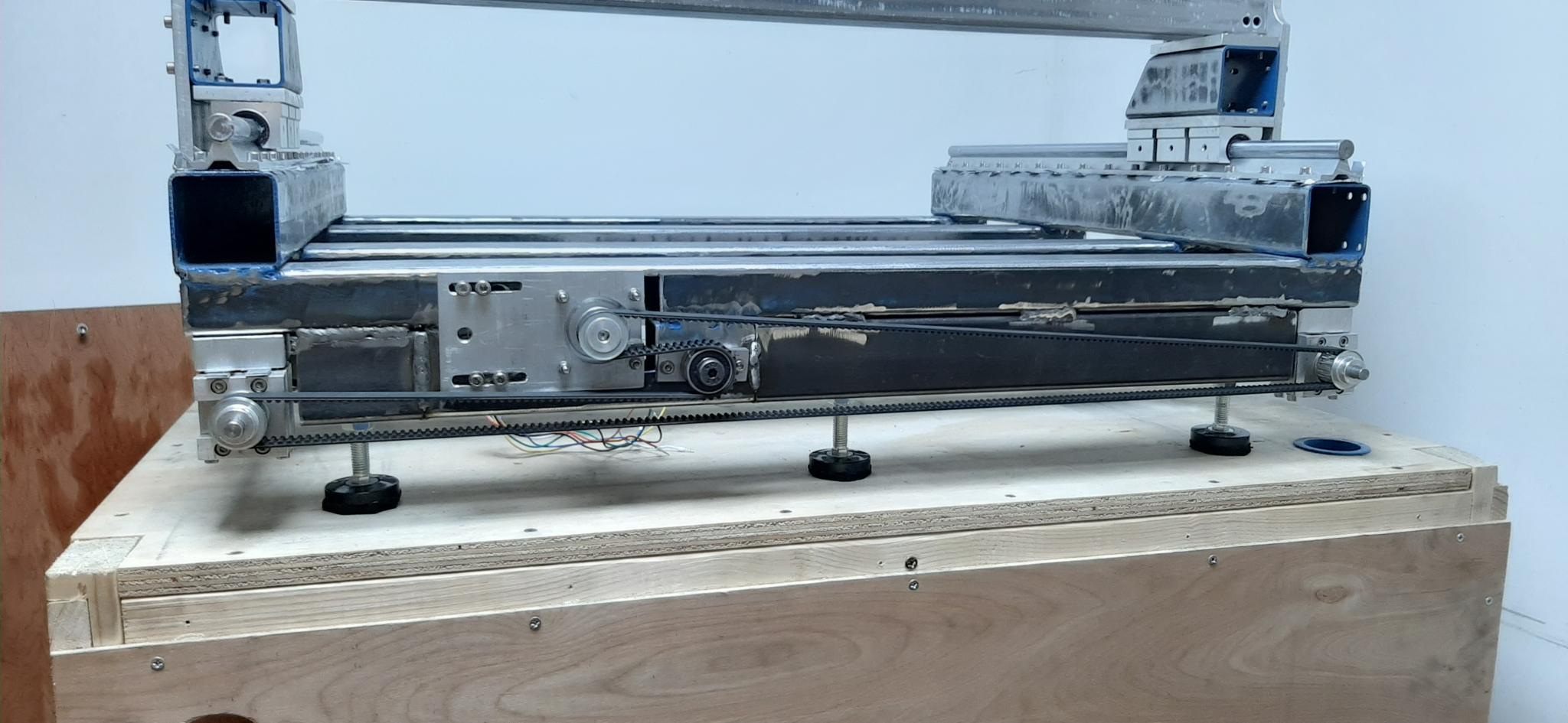

    Moving onto final assembly at last. Total gave up with paint in the end. After 4 tests with the second tin of enamel paint that all went soft even after drying for over a month, im going for the bear metal look! Its bone dry in the garage so dont see it been a problem.
    Y (forward - backwards) axis rails have been leveled and are parallel, and both ball screws are have been aligned with the axis.
    Struggling with aligning the pulleys that connect both ball screws to my single stepper. Any tips for getting them aligned would be appreciated.
    ThanksClick image for larger version.
