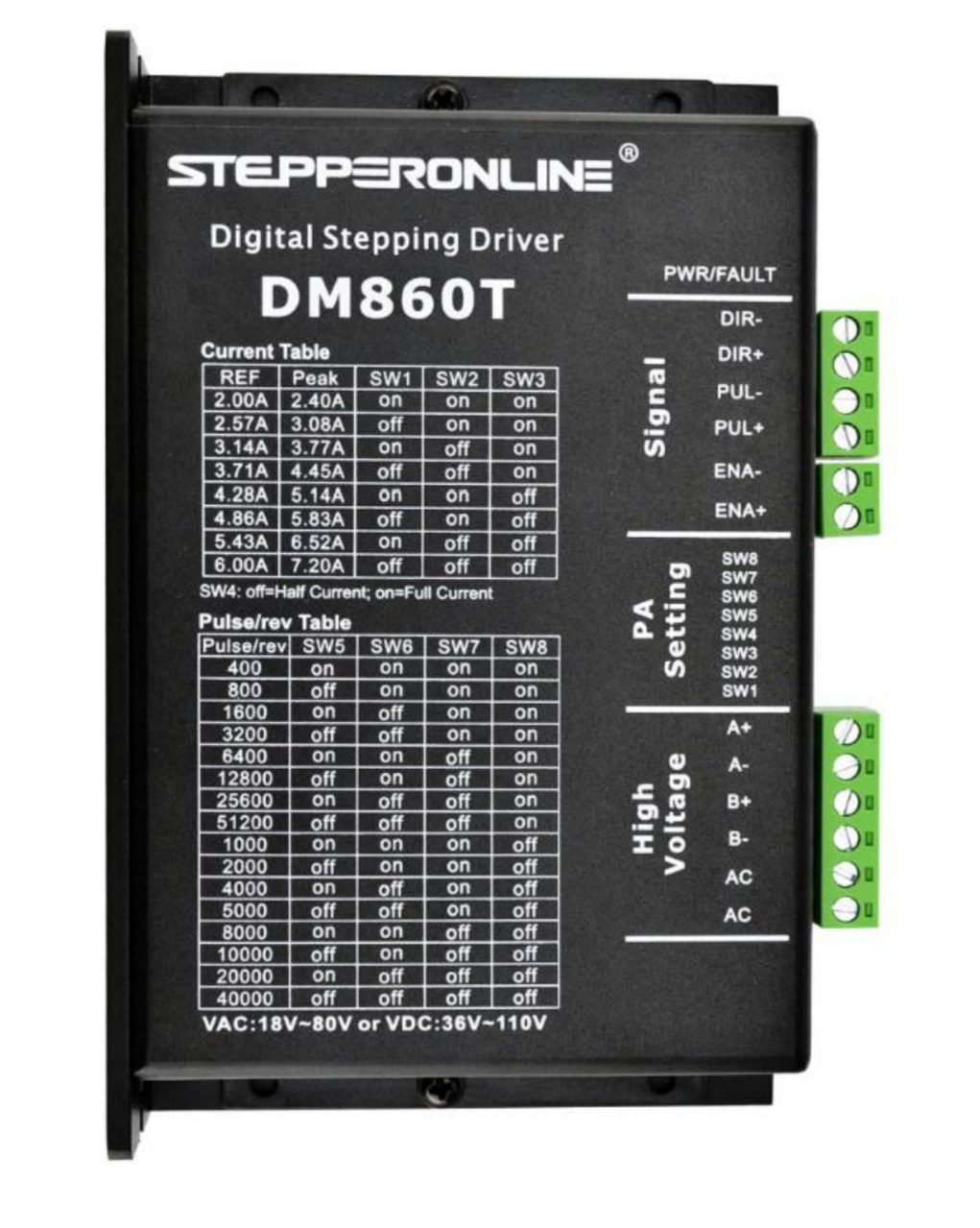

    For the electronics, I have just got 3 DM860T drivers from stepper online to power my 3.1Nm Nema 23's.
    I would quite like to wire up the motors just to check everything is working correctly, so starting to think more about BOB and PSU.
    The drivers can take either AC of DC input.
    I like the idea of AC as it make the power supply build a little simpler, but is there any downside to using an AC input?
    Any advice for BOB? I plan on using linuxCNC.

    Dont have a PSU to hand, so looking to put together a simple 70vac transformer, but im struggling to find a suitable toroidal transformer.
    Only 230v to 70v transformers I have found so far are max 500va, which im not sure is sufficient for 3-4 motors. The current design is 3, but want to leave room for a 4th if i choose to upgrade later

    I think i need to check my PSU calcs. Can someone point me towards some example PSU design calcs?
    Also, any idea if there is any benefit of AC vs DC?
  10. #50
    This is quite a good introduction...
    http://www.skillbank.co.uk/psu/
    The stepper driver must be rectifying the AC into DC anyway, though with little or no smoothing. My guess is that making drivers that can be fed with AC is done merely to reduce the cost of the power supply. Whether a smoothed DC supply noticeably reduces motor vibration compared to AC will need some research.
