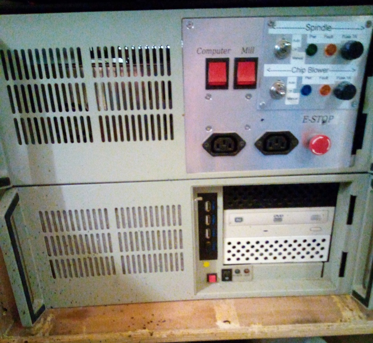

    Another option is to grab yourself a server rack with a glass front (reasonably inexpensive on ebay - especially the kits or 2nd hand), or use a large PC case.
    Server cabinets are cheap enough, the larger ones can't be given away sometimes. I have one dismantled in storage, deep enough to put a tool cabinet in the front and the control electronics in the back.
    I built my control box in an old computer case, with the computer in another :-
    It got a bit messy recently when I splashed it with a solution of black ABS, nothing like the mess when a spray can exploded on my garage
    Cheers,
    Rob-T

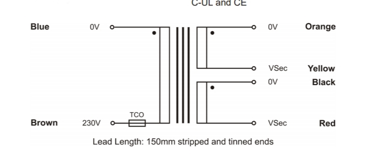

  4. #84
    Got a new multimeter and I'm getting 33v from each secondary. Glad I didn't get a 35v transformer or I would be very close to the 80v max.
    To wire this thing in series, am I correct in thinking I connect the yellow and black?
    Also the drivers dont have positive and negative marked on the input, both are just labelled AC. I'm guessing that because it AC it doesn't matter which way around it connected?

  5. #85
    Quote Originally Posted by diycnc View Post
    Yep.

  7. #86
    The drivers dont have positive and negative marked on the input, both are just labelled AC. I'm guessing thats because its AC it doesn't matter which way around its connected?
    Does this also apply to the location of the fuse?
  8. #87
    Yep often they are labeled R S but can put anyway around. I always connect live to R and Nuetral to S

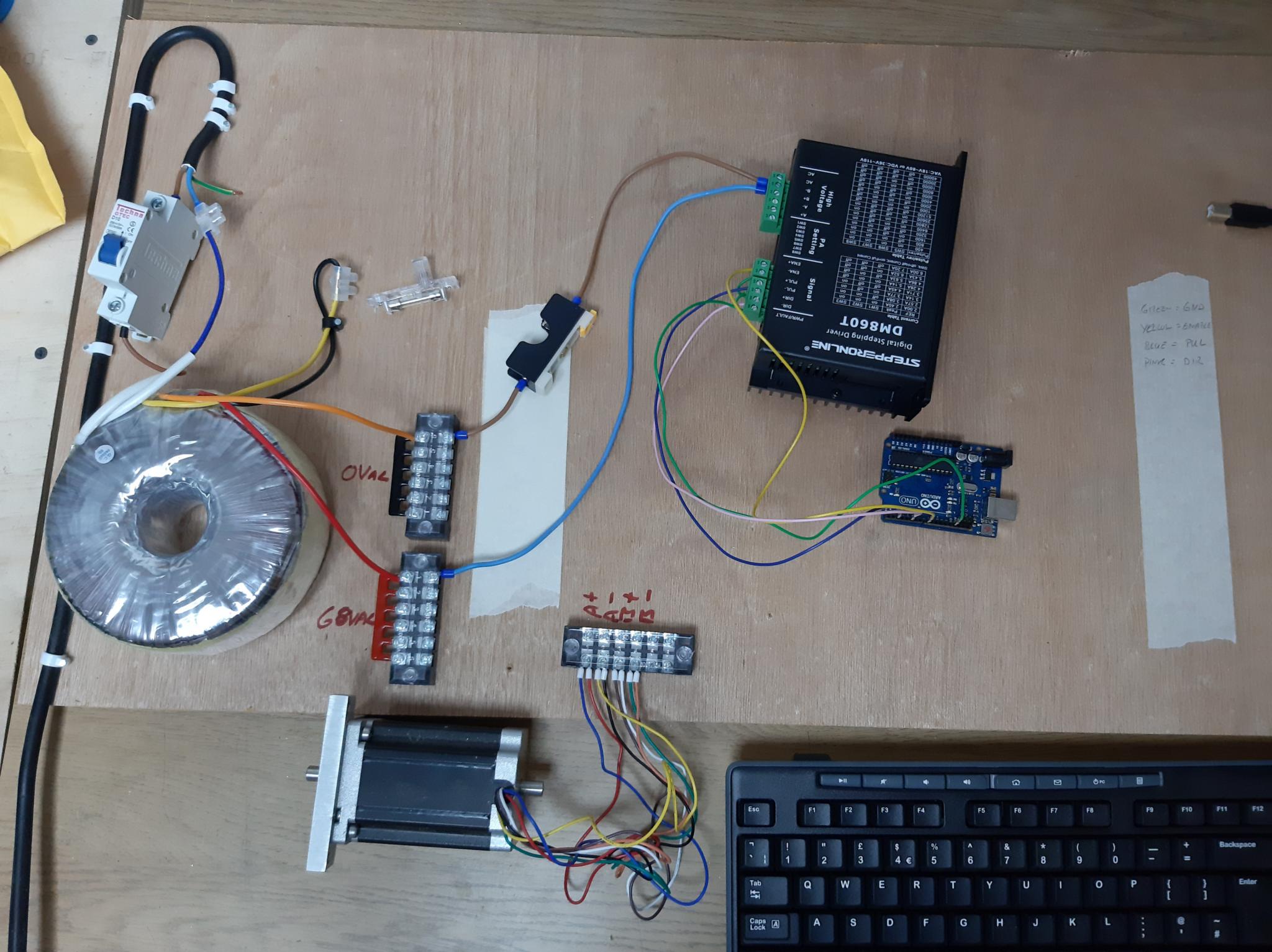

  9. #88
    Finally got around to putting some test electronics together, just need to connect the motor and flash grbl onto the arduino. Would be awesome if someone could take a look at my wiring befor I do anything too stupid. I'm a bit unsure about the earth at the moment. The negative enable, step, and pulse are all connected together and the ground pin on the arduino. And mains earth isn't connected to anything at the moment.
    Once I have one tested and working, will test all three together.
  10. #89
    Just spotting I have the fuse on the zero volt side of the psu!
  11. #90
    If it were me I'd run the enable, pulse and dir. signals as twisted pairs - common the -ve ends up at the Arduino. This approach gives much cleaner waveforms and better resistance to interference.
