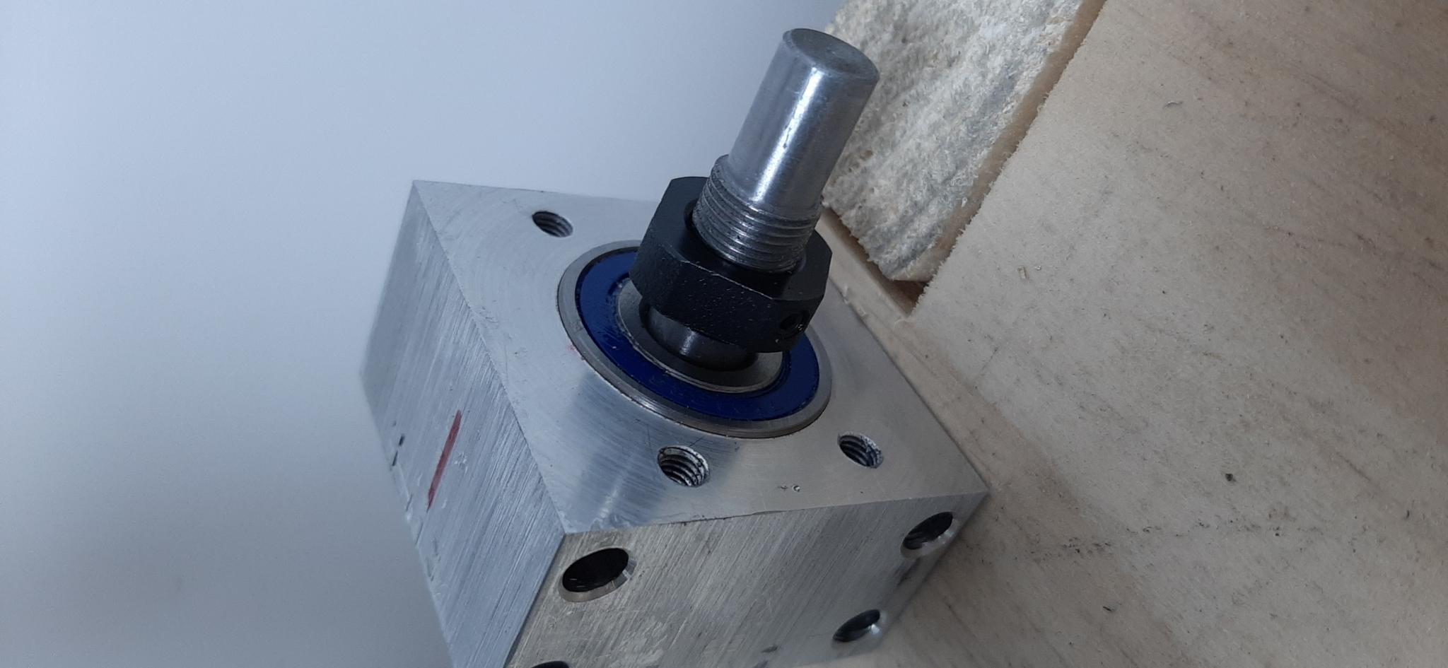

    Could someone help shed some light on the correct orientation of AC bearings?
    I thought I had a handle on it, but iv just come to install some pulleys and iv spotted iv got some face to face, and some back to back, so now I think i must have misunderstood something.
    My current understanding it face to face is the preferred orientation and to preload them to remove any backlash I shim the outer race.
    Face to face is with the larger inner race face pointing towards each other?
    A second opinion on this would be great!
  3. #113
    Scratch that.
    If I'm shimming the outer race, I need them back to back.... with the larger inner race face pointing away from each other...?
  4. #114
    Yea, for this application back to back is what you want.
