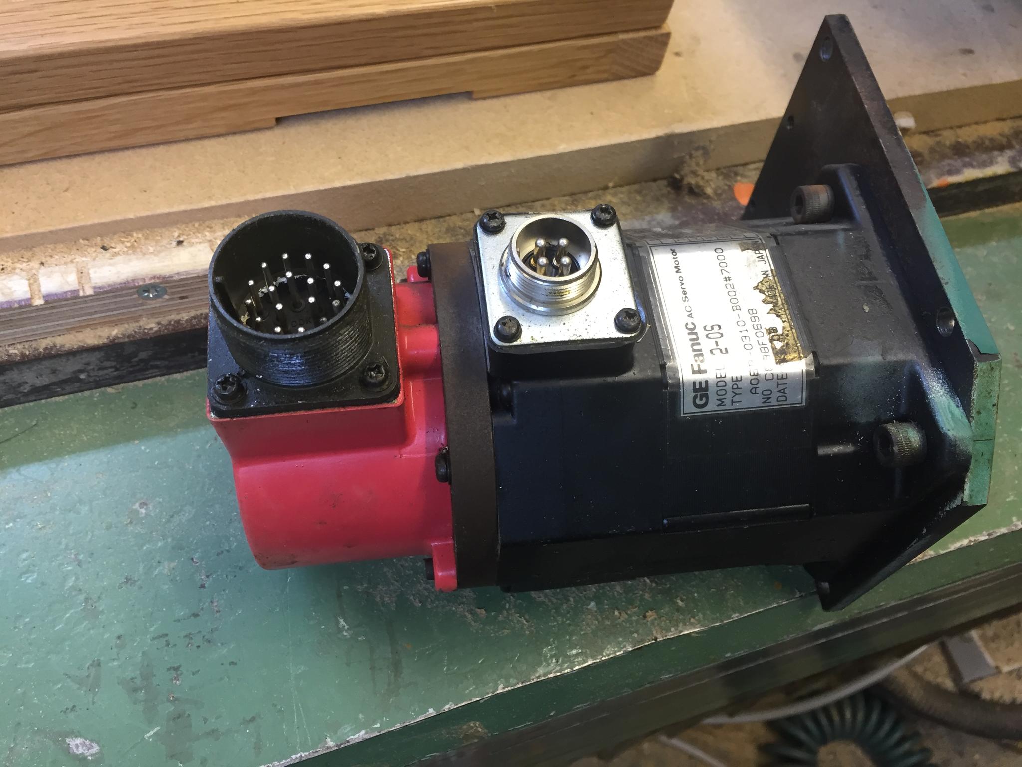

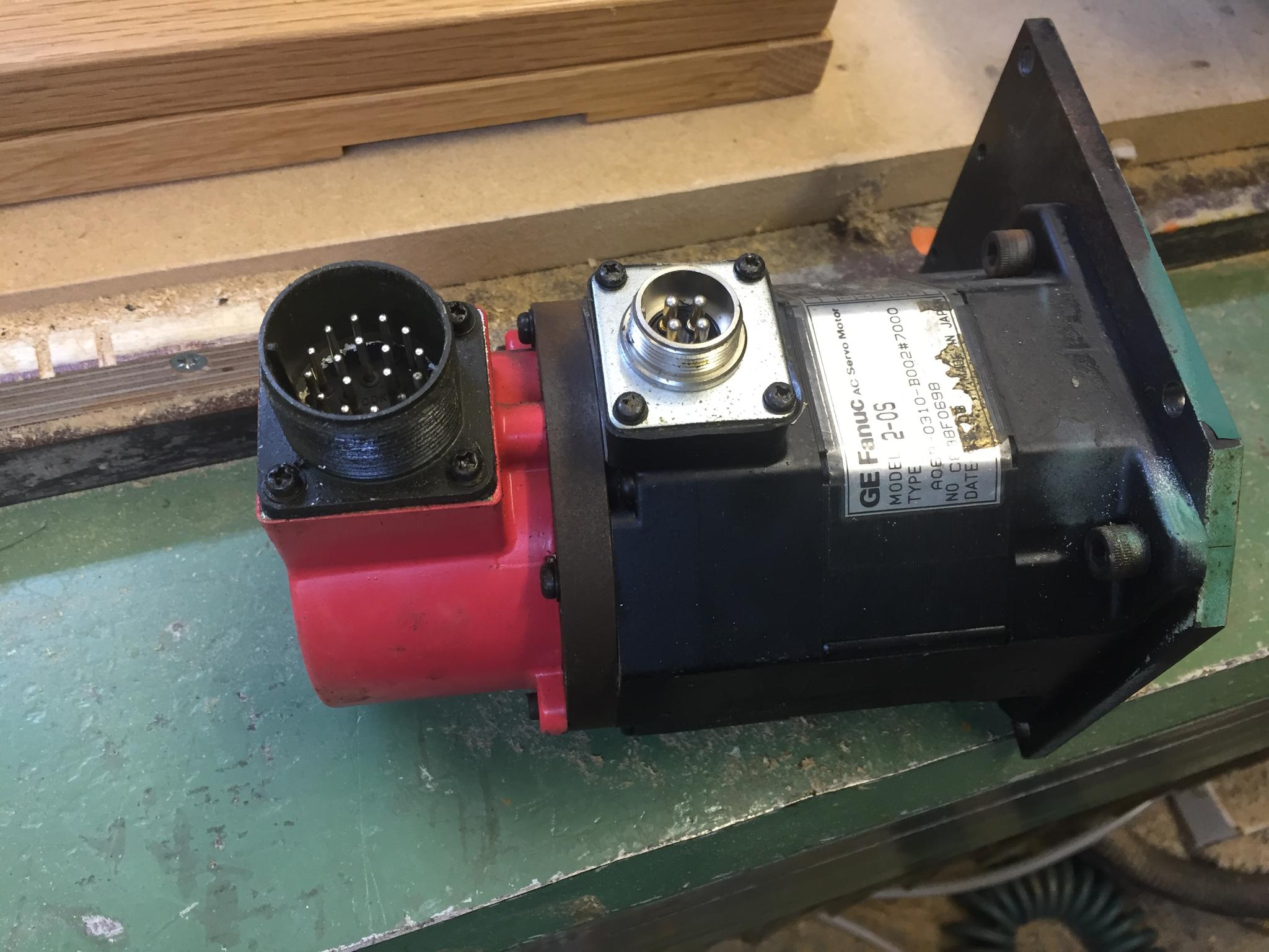

  11. Does anyone have a spare encoder cable or just encoder plug for fanuc red cap
    Only required for test rig to set up my new drives.
    Terminal layout is different to most motors- pain!Click image for larger version.
  12. Got the red caps running perfectly on step/ direction
