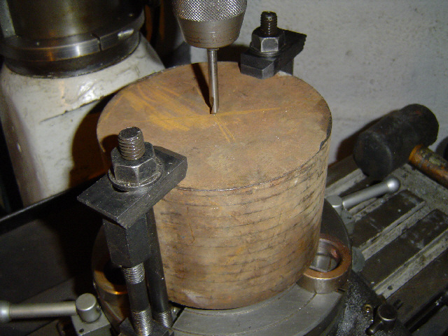

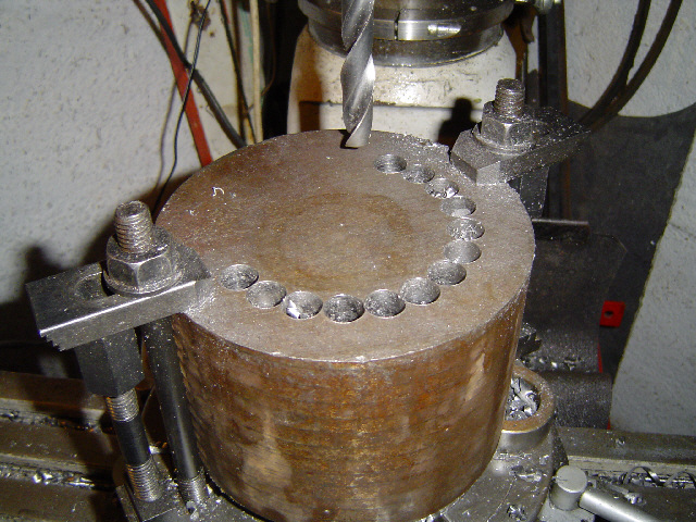

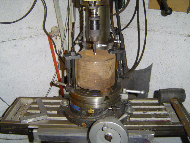

    My nephew Lee has a bad habit of asking me to make him things out of stupid sized bits of metal; a couple of weeks ago he asked me to make him a 35mm diameter steel sleeve with a 25mm bore and then supplied a length of 50mm bar - I couldn't find any 40mm bar locally, so had to spend hours turning the bloody thing down.

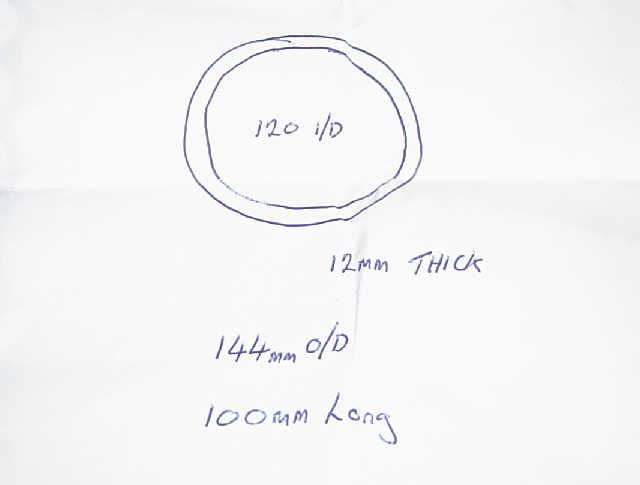

    Saturday, he dropped off a 'technical' drawing - anyone who has seen the The film "The Hudsucker Proxy" would have recognised the drawing straight away i.e. two roughly concentric circles with 120 written in the middle and 12 by the edge with a side note saying 100mm long.
    With it came a 4" long by 6" diameter block of steel - I'm suppose to make it into a tube
Name:	The block.jpg
ID:	1088   Click image for larger version.
ID:	1089   Click image for larger version.
ID:	1090   Click image for larger version.
Name:	more holes.jpg
ID:	1091   Click image for larger version.
Name:	End of part one.jpg

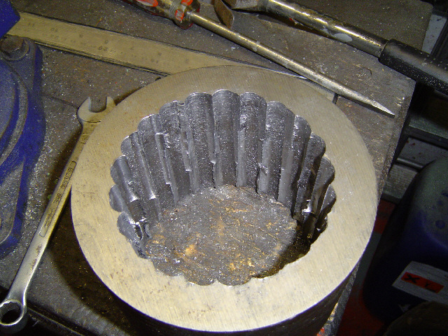

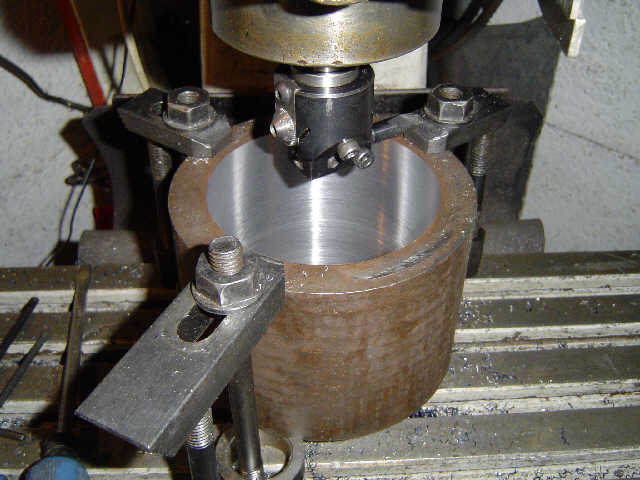

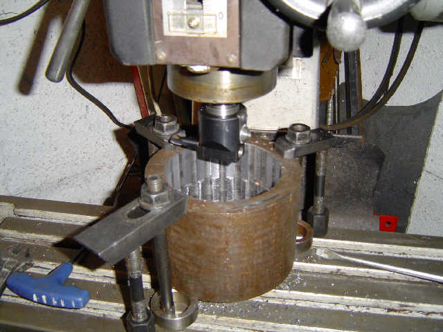

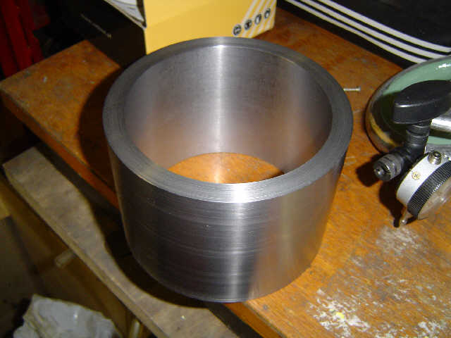

  3. I wasn't happy about mounting the rough outside of the block in the lathe, so I finished the bore on the RF30 drill/mill
    After a very noisy interrupted cut, the boring job when quite smoothly.
    Last act was to turn the outside to size on the lathe
ID:	1097   Click image for larger version.
ID:	1098   Click image for larger version.
Name:	turning the outside.jpg
ID:	1099   Click image for larger version.
ID:	1100   Click image for larger version.
Name:	You know - For kids.jpg
