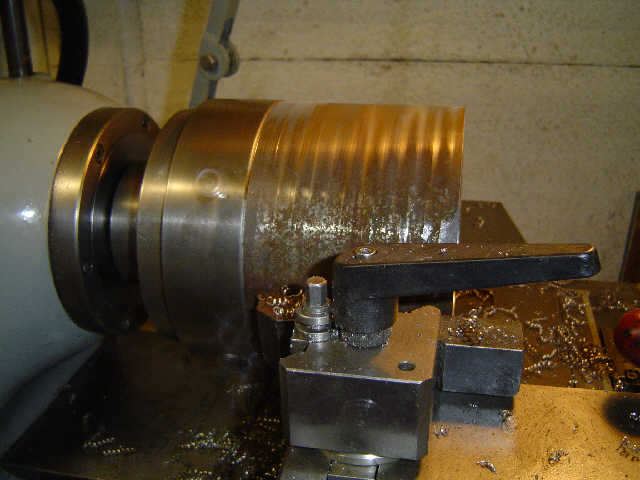

  7. I wasn't happy about mounting the rough outside of the block in the lathe, so I finished the bore on the RF30 drill/mill
    After a very noisy interrupted cut, the boring job when quite smoothly.
    Last act was to turn the outside to size on the lathe
