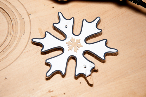

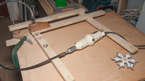

    3. Some inlays require me to make a pattern for a homemade pantograph using 8x (size) patterns and 1mm cutters in a dremel fixed to a home made pantograph – this is time consuming at best.
    This also requires a reversed pattern to cut the housings with the pantograph too
    Took me quite a while to admit to the first point, the second point is simply one of cost. MoP and other shell inlay blanks are quite cheap and offer a greater range of sizes which in turn offers more flexibility in the designs I can use. Point three shows that I can currently cut inlays and housing but the process is drawn out in having to make enlarged patterns to cut out shapes.

    Rosettes are currently cut with a Dremel on an adjustable radial arm which rotates about a fixed pivot at the centre of the soundhole.

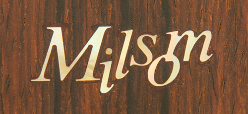

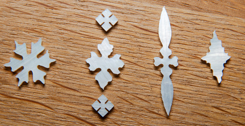

    I have some image examples of typical simple inlays I’ve made with the pantograph/Dremel and a commercially made logo.
    Francis
ID:	23685Click image for larger version.
ID:	23686Click image for larger version.
ID:	23687Click image for larger version.
