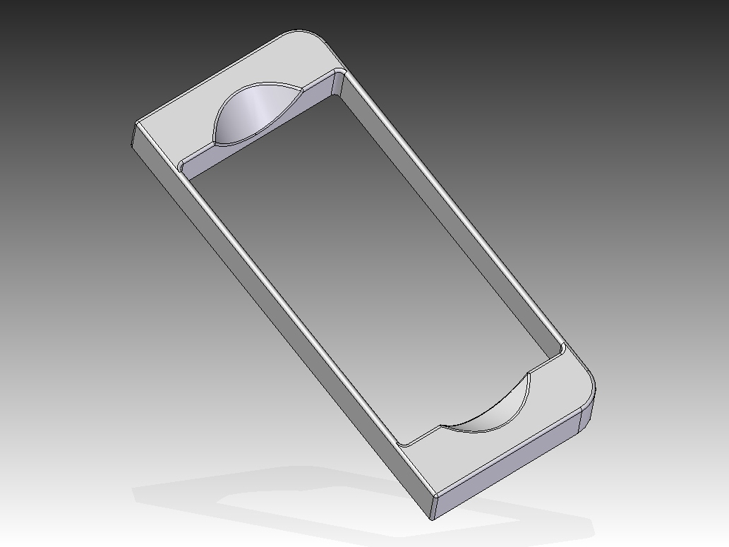

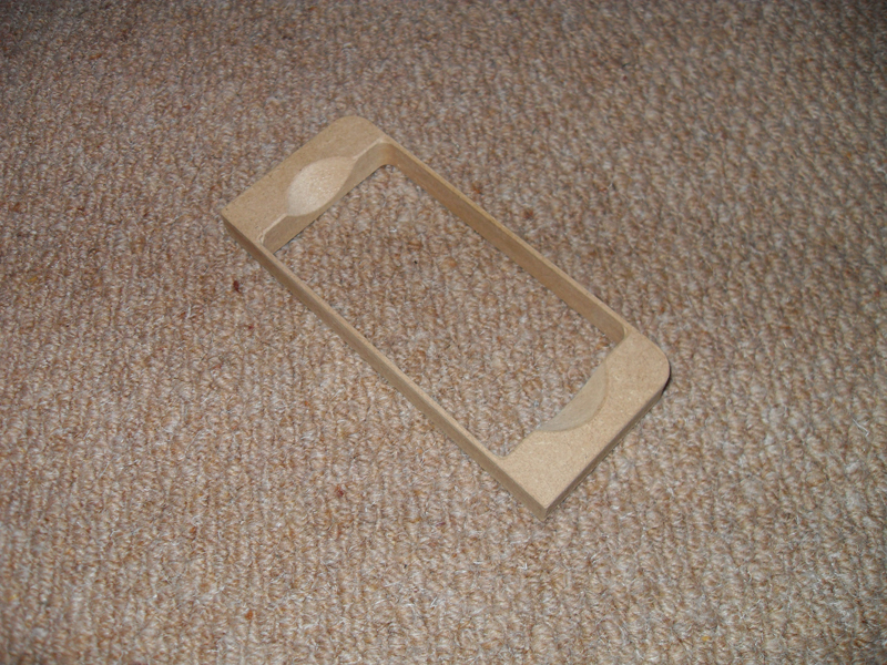

    I have been playing with FeatureCam 2009 for the last couple of days and I have eventually got my head round it, took a few hours but well worth it. I have attached my results below.
    I have also attached a Featurecam post processor that I have been tweaking which will allow it to produce programs suitable for Mach3, be aware that it is not finished or fully tested but is producing good results as you can see.
    If anyone does have a fully working and tested post processor then please let me know as I have looked everywhere and can't find one.
