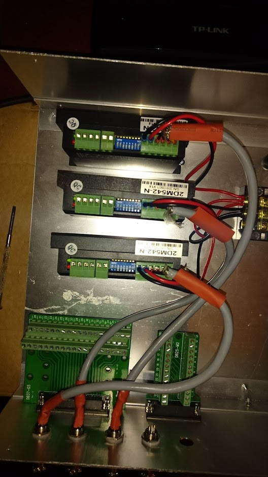

    Fitted a toroidal transformer to give me 36v for the drivers and a 24v supply to power the DDCSV, fan, and pump for the spindle. Both fan and pump will be stepped down to 12v.
    Here's a pic so far:
    I've still to add an earth star-point, but I've temporally wired the DDCSV and steppers and they all power up fine. The steppers I'm using are just some cheap 2DM542-N. I could have gone Leadshine, but with this being my first attempt I didn't want to be destroying expensive drivers. Besides, can always modify things later.
    The above is about as far as I've got. Still waiting for a 37pin D-sub cable to arrive and 4 Core CY cable. I also need to buy a new 1.5k VFD for the spindle. The D-Sub will be used to connect to the box containing the DDCSV, E-stop and rotary controller.
    Greatly appreciate any help with setting the drivers for my Nema 23 type-57 3 amp, and wiring the drivers, DDCSV and, later, limit switches.

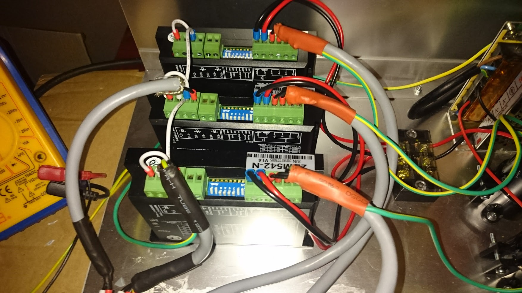

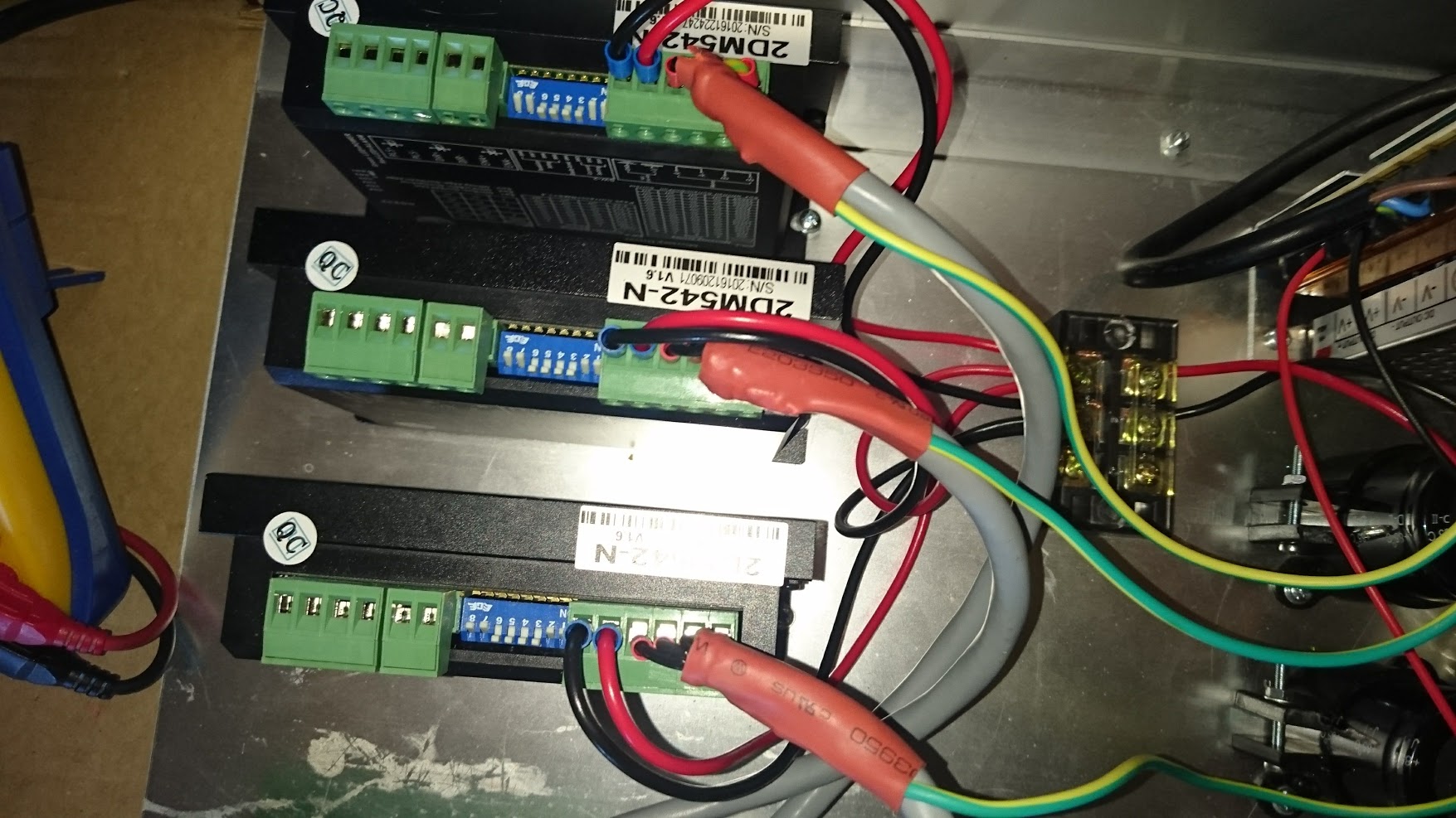

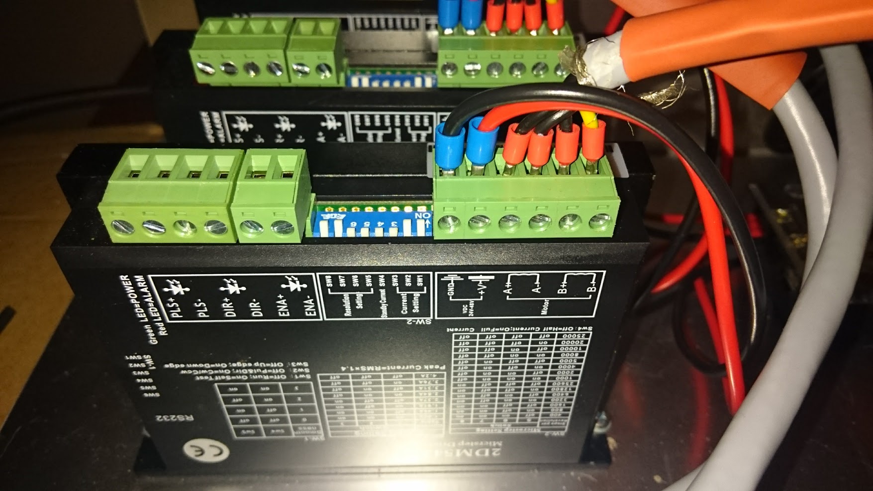

    My CY cable has arrived so I've wired the x,y,z to the drivers:
    I've left the shielding on each cable because I'm unsure about the following: Should the shielding on the A+A-/B+B- side of the drives for the motors go to the drives DC ground - or should they go to the AC earth star-point? Asking because I've seen images where people wire their shielding here to the DC ground on their drives. But I've also read that all shielded cables should go to AC earth star-point - and not DC ground.
    Bought a Chinese 6040...if only I'd known better :(
    Quote Originally Posted by Rye View Post
    All grounds should go back to AC Star earth point.
    Rye's Avatar
    Lives in Sheffield, United Kingdom. Last Activity: 16-02-2019 Has been a member for 9-10 years. Has a total post count of 50. Received thanks 4 times, giving thanks to others 0 times.

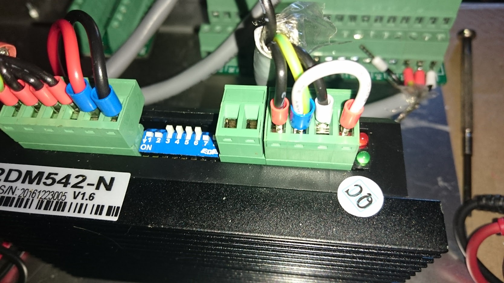

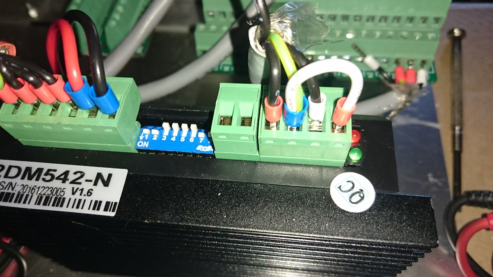

    Cheers Jazz. Earths to the shielding added:
    Have to get my head around wiring the other side of the drives now:
    PLS+
    PLS -
    DIR+
    DIR -

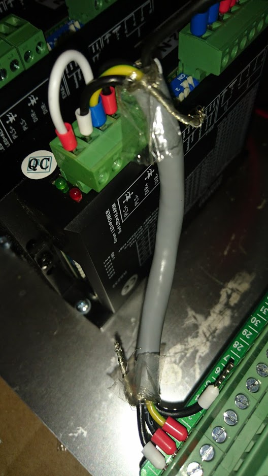

    Knocked a temporary cable up with a jumper from DIR+ to PLS +
    Can the DIR+ be daisy chained to each drive's DIR+?
    Of course.

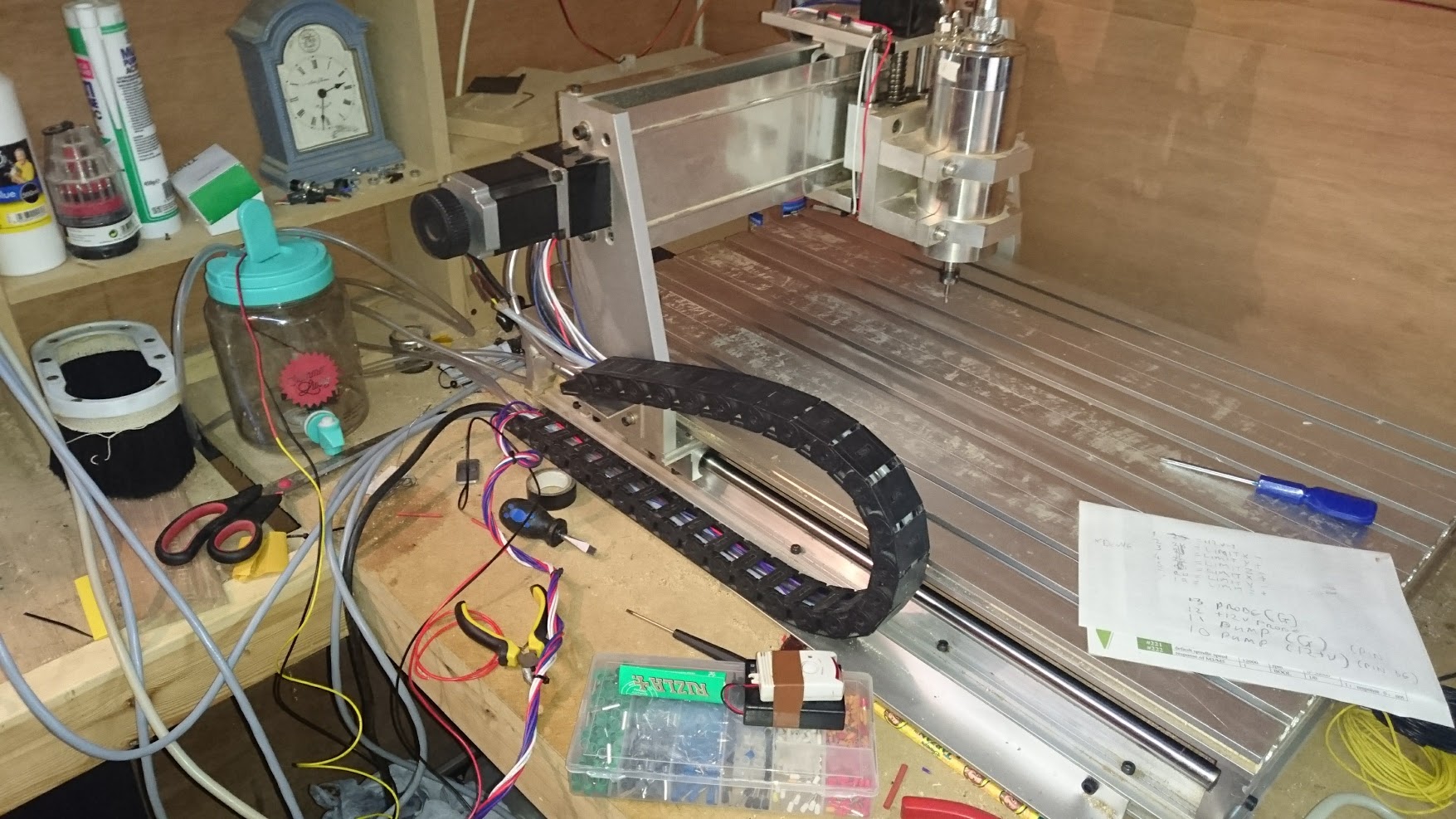

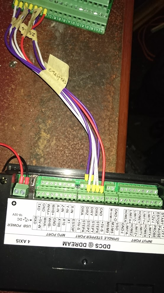

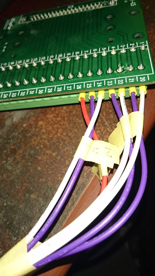

    Too cold to be in the shed cutting aluminium for the rest of the box, so I've made a start wiring the steppers on the DDCS:

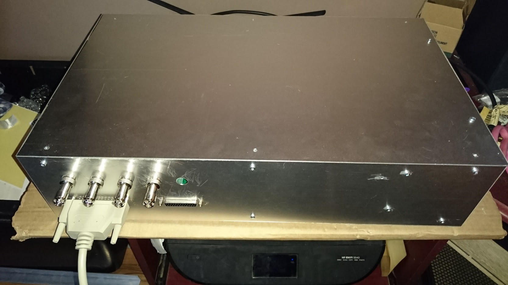

    Couldn't be bothered with soldering, so got me two 37pin D-Sub breakout boards: one for the main box, one for the DDCS box(when I get around to making it). Takes up more room, but easier than soldering 37 pins :)

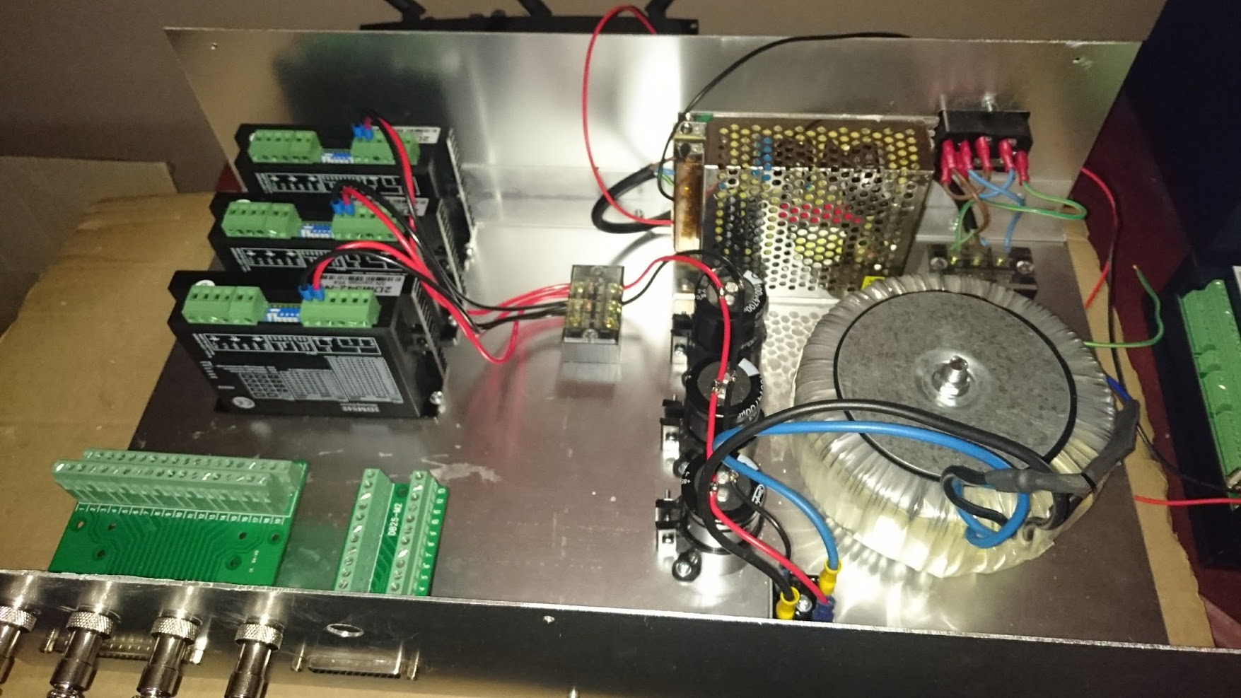

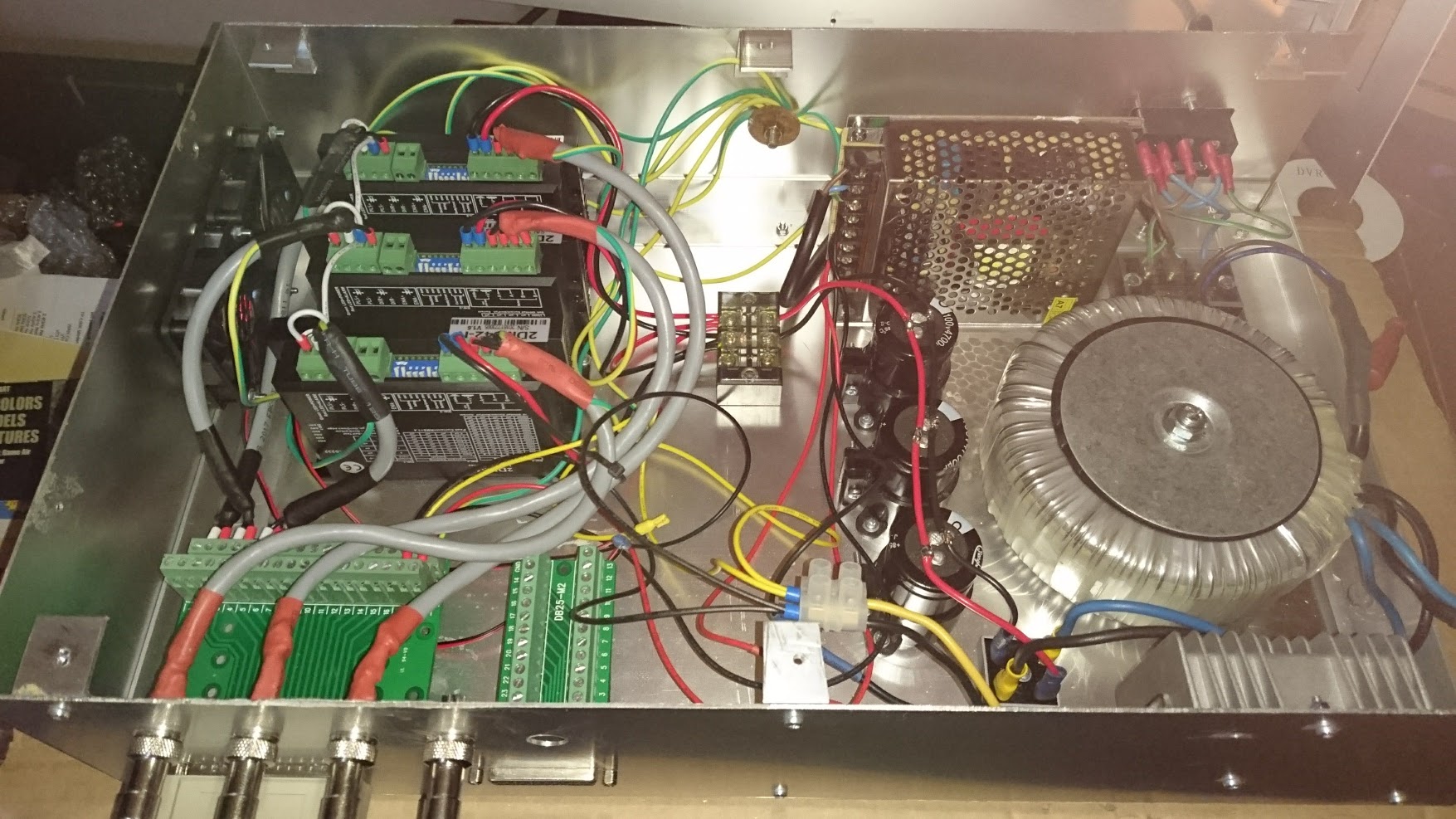

    Found a little time to continue with this. The main box is pretty much done. Admittedly, it's all a bit tatty and meccano..ish, but it'll do for the shed wall. All powers up fine, just need to tidy the wiring before I wire the D-Sub for the limit switches.

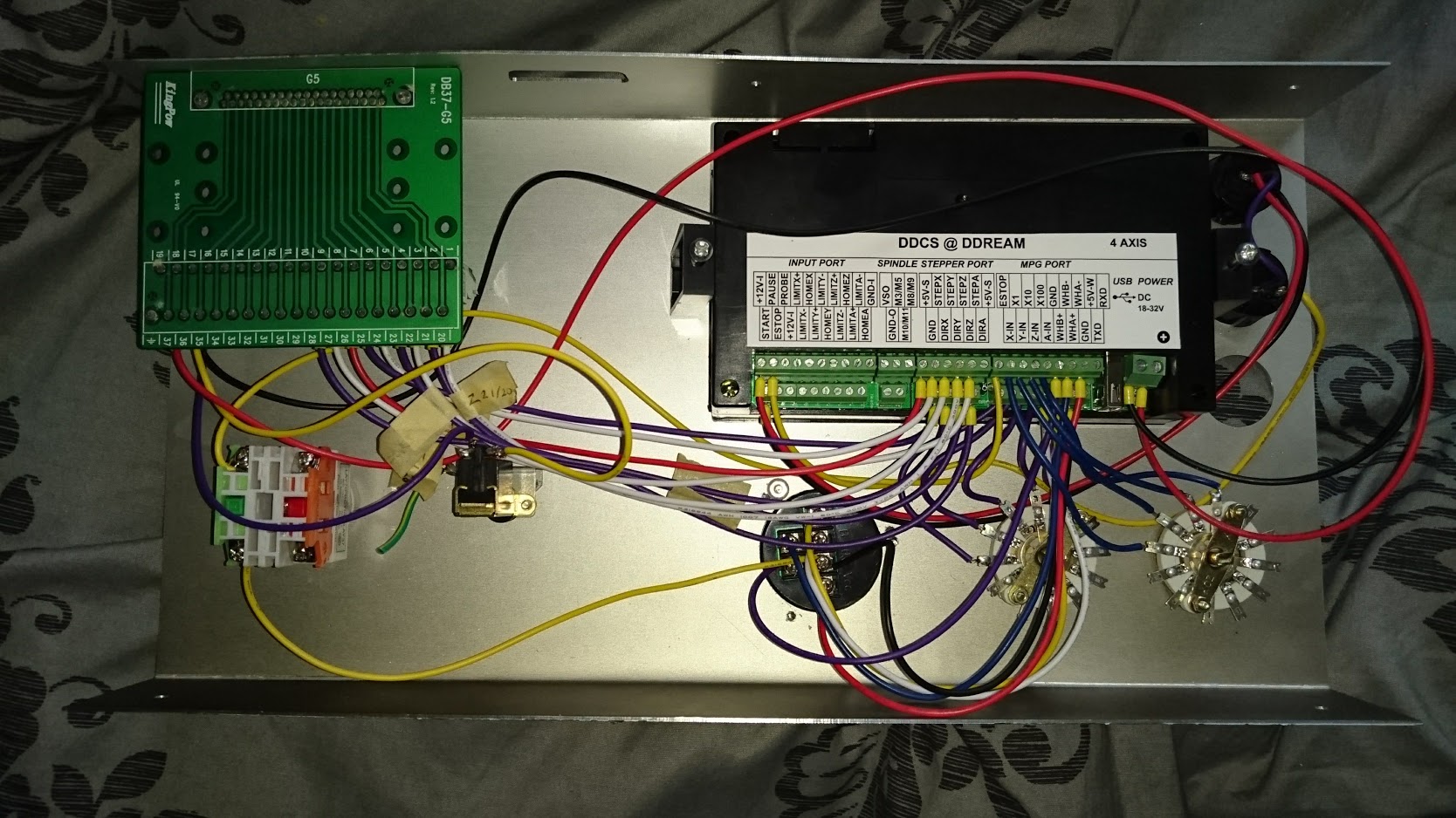

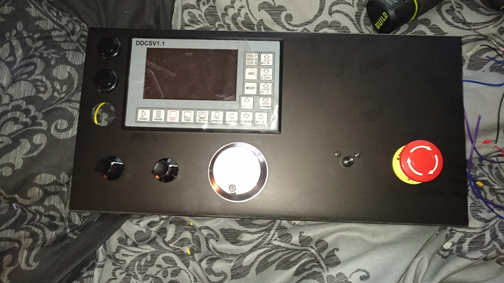

    Still need to make the box for the DDCS. The DDCS powers up, but have to wire the MPG/switches. estop, pump-switch and possibly one or two other things. Going to try wiring up first to see if it all works.
    Dang! Where do I start :(

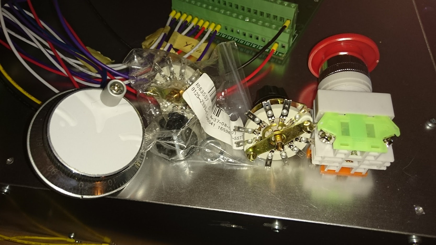

    Might need some help wiring the 5 position rotary switches for X,Y,Z and 1x, 10x, 100x on the MPG control.

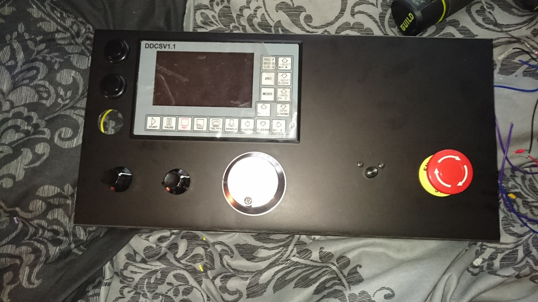

  11. #10
    Rye's Avatar
    Had a slight change of plans on the design for some of this, but the wiring and everything is coming together quite nicely.
