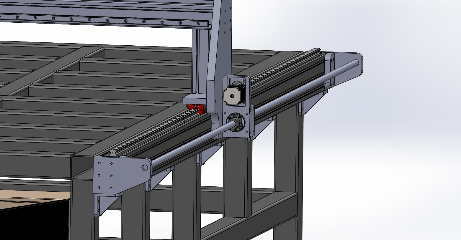

    I have some design ideas and have been working on a basic draft, mostly incorporating ideas I've seen (will post a couple of pics later, if necessary),
    but thought it best really if I get the advice from the pros. I've spent hours (days) trawling the forums and have read some great and useful stuff, the only problem is I've forgotten half of it and the other half is buried somewhere in fragments throughout different pages.
    FYI I am completely new to CNC, but have some experience coding and can draw (a little) in CAD. Can't be much different to building a computer, can it? Hardware and software.

    1. Hopefully the gantry won't be an issue as the design uses 50mm by 100mm mild steel side rails for the x axis, with 50mm support structures welded to the bottom. I'd seen somewhere that dropping the bed instead of raising the gantry makes the structure stronger, makes sense. 10mm aluminium plate for the gantry in an L shape. In theory, this is sound I think?
    2. Backlash, which sounds similar to slop in a drivetrain, was one of my worries here too. In my design I was looking at using ballscrews, I guess I need to keep reading some more on that issue. Are you saying that backlash can be eliminated by using those methods? I'm sure I've read somewhere it can. The structure itself I think should be ok, I tried uploading a picture from my phone a few tims but it failed.
    3) Most of the weight would be in the bed and support structure below made from mild steel, the only moving parts would be made from 10mm aluminium plate to keep the weight down.
    4.Again this is an area I need to look into more, but I'm thinking I need to finalise my design and see how much it's going to weigh before I decide.
    4. Hopefully this won't be an issue and is why I'm not even going to attempt to weld this myself. The lower supporting structure will be separate from the bed, bolting together so I can use shims to get the bed as level as possible. Not 100% decided on whether the resin route will be needed, probably, Hopefully someone else will come and clear this up.

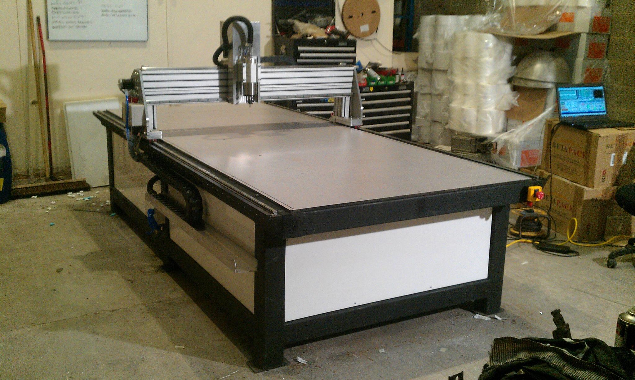

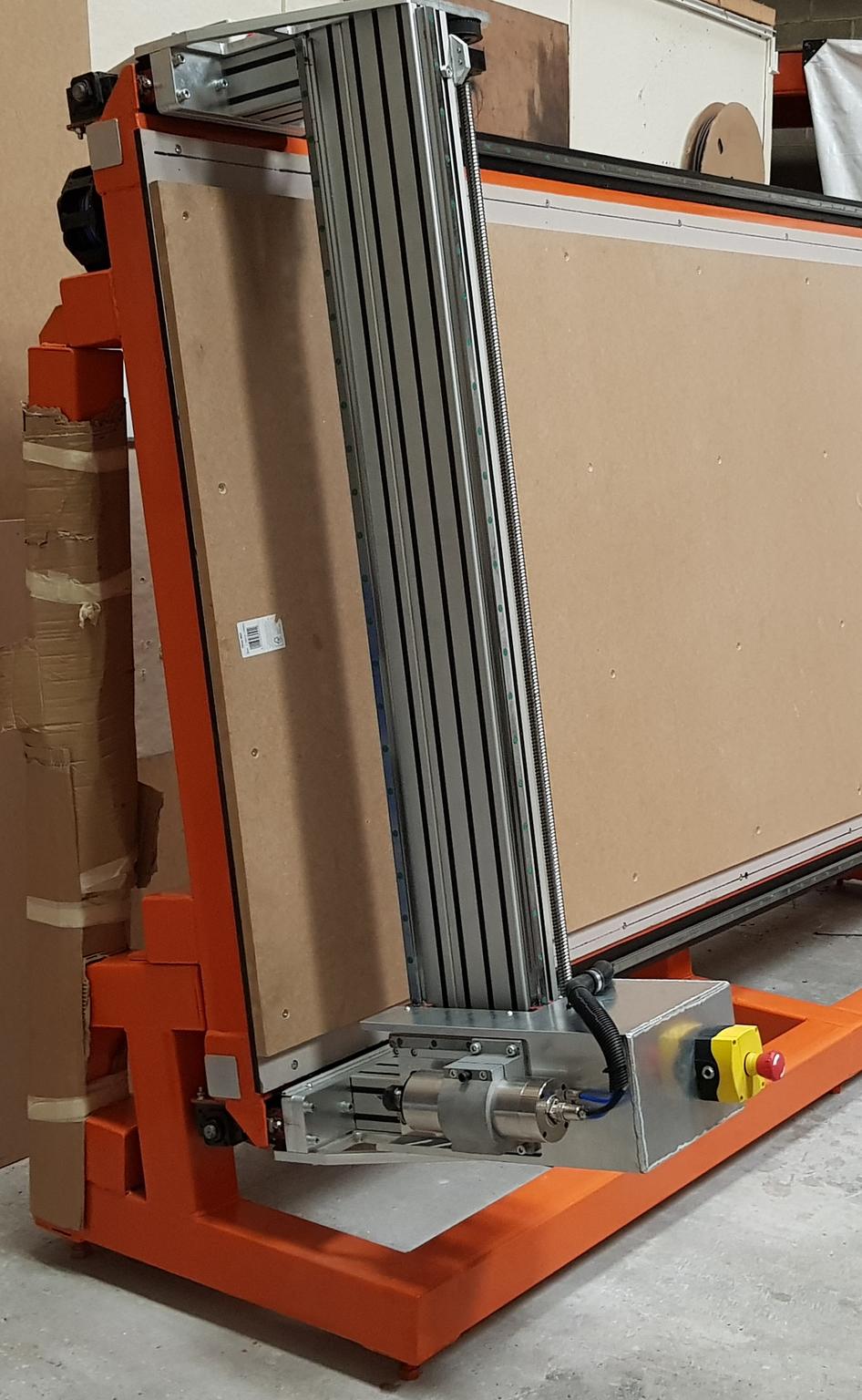

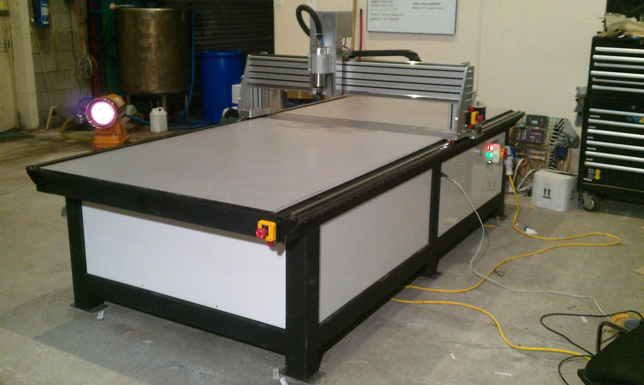

    To give some idea the last 8x4 I built which you'll see in pics uses 120x80 HD Aluminium Profile arranged in L shape and I consider that a Minimum for a machine this size.
    It's not just the weight it's carrying but got to also think about resonance/vibrations that will occur from the cutting. Resonance will give poor finish, cause excess tool wear and shorten component life.
    Next comes linear motion. If your wanting Ballscrews then you really need to know what you're doing and what to buy because when you get past 1500mm things get wobbly real quick.
    First, you have the obvious thing to deal with which is screw Whip from the long length. But you also have to think about alignment because long screws are merciless when comes to alignment. The slightest misalignment and they'll turn into gyrating skipping rope which will cripple the machine performance.
    Getting this right is a careful balance of selecting the correct ballscrew with regards pitch and diameter along with correct tensioning and alignment. Get anyone one wrong and your in for world of pain.
    This why Rotating ballnuts are often used for long lengths but this gets expensive and complicated unless you can make them your self.
    Rack & pinion is the common solution for machine this length but again this brings with it's own challenges and problems/costs.
    Coupled with all these solutions comes correct selection Motors/drives etc and is one of the reasons why you cannot build a machine this size for £3k.
    Long, large diameter screws require bigger motors which along with high power drives get expensive quickly.
    Ballscrew or R&P there is no difference really here because R&P is less efficient so still requires large motors to compensate. You also then have more backlash to deal with from R&P. Also R&P will require gearing to give you the Torque and resolution required which adds another layer of costs/complexitys.
    I Strongly advise you to think long and hard before you take this project one with No experience because it's very very easy to get it wrong and all the research in the world won't prepare you for just how much more of challenge it is building an 8x4 than say 4x4.
    The extra length really does change things that much and the slightest errors get magnified.
    But one thing I can 200% tell you is that cannot be done properly or legally for £3k.!!
    Here's two for you one with R&P and other with Ballscrews and mounted vertical.!
