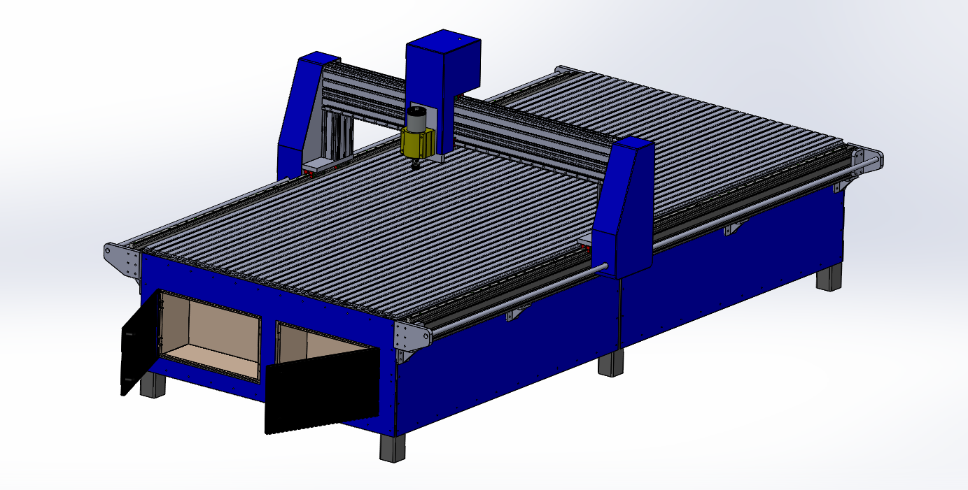

Here's design that will allow you to be more flexible with the frame. Although the base here is in one piece it could easily be made in 2 or 3 pieces and bolted together.
The important part is the full-length profile section running full length down each side. This will allow you some flexibility in adjustment so can get both rails on same plane without messing around epoxy resin etc. Must stress thou the accuracy will only really be good enough for cutting woods and softer materials. It will also take lot of setting up and tweaking until spot on.
In my experience profile is relatively flat and straight enough for wood router and does make fitting rails, ball screws etc much easier. The downside is cost so mixing steel and profile gives good balance of strength, costs and accuracy with ease of building which doesn't require too much machineing or timely and costly techniques for leveling etc.

Thanks for that, this is exactly the route I'm looking at now. Makes sense to use the profile for exactly those reasons.
