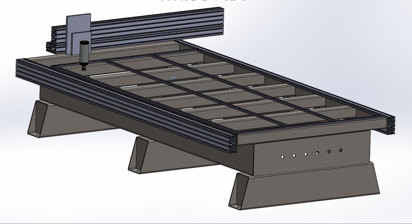

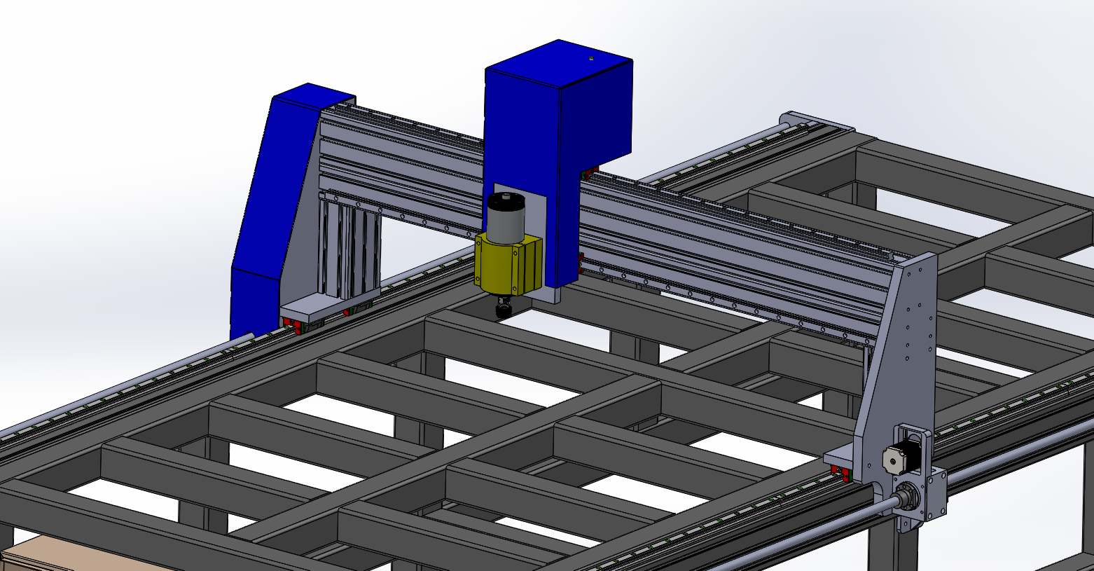

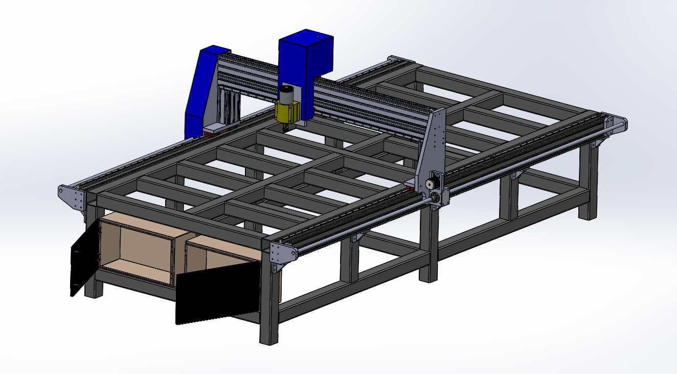

    If you was building a plasma machine I'd say that's perfect. But if you want a serious router then it needs lot more work.
    The Bottom Pic looks very much like Merchant Dice machine and just ask anyone about how well MD machine performs..
    Your gantry design is week and far too weedy for decent router this size.
    What would you recommend instead Dean? I keep thinking about the logistics of it, I don't have a forklift at home haha
    http://www.ukcnc.info/forums/showthr...-November-2014
    I was impressed by this one but haven't (can't) work out how much it'd cost.
    Sent from my SM-G935F using Tapatalk
    Well all can say is build it stronger or should say Stiffer. If your limited with logistics then build it sections so can be easily moved. It will add another level of complexity because still need to maintain accuracy which is harder to do with more pieces.
    Going to say this again because cannot stress enough. Your Gantry design is WEAK and if you build this it will show in the quality of finish.
    The Gantry and Z axis are key areas. Malcolm as already mentioned to his pain that Z axis is key area and soon shows any weakness in the cut.
    I don't agree that is Gantry is over built and changing to lighter Section profile wouldn't give any better performance really and could potentially cause other issues with resonance when cutting deep or hard materials.
    Better having strong gantry that is little heavier than light gantry that will flex when cutting hard. If higher feeds are required then better to size the screws or motors to suit rather than under build.
    Under building because of Logistics or weight is just going to compromise the machine performance. Better to think smarter and design around any restrictions.

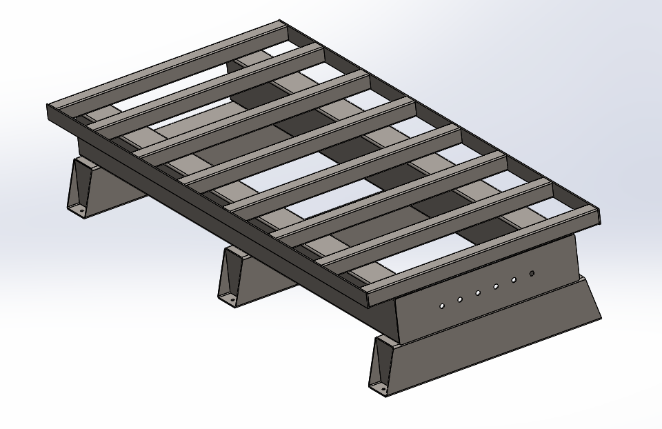

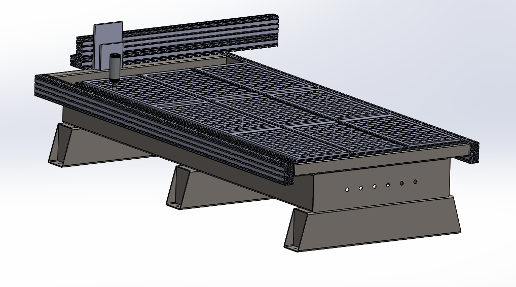

    Here's design that will allow you to be more flexible with the frame. Although the base here is in one piece it could easily be made in 2 or 3 pieces and bolted together.
    The important part is the full-length profile section running full length down each side. This will allow you some flexibility in adjustment so can get both rails on same plane without messing around epoxy resin etc. Must stress thou the accuracy will only really be good enough for cutting woods and softer materials. It will also take lot of setting up and tweaking until spot on.
    In my experience profile is relatively flat and straight enough for wood router and does make fitting rails, ball screws etc much easier. The downside is cost so mixing steel and profile gives good balance of strength, costs and accuracy with ease of building which doesn't require too much machineing or timely and costly techniques for leveling etc.
