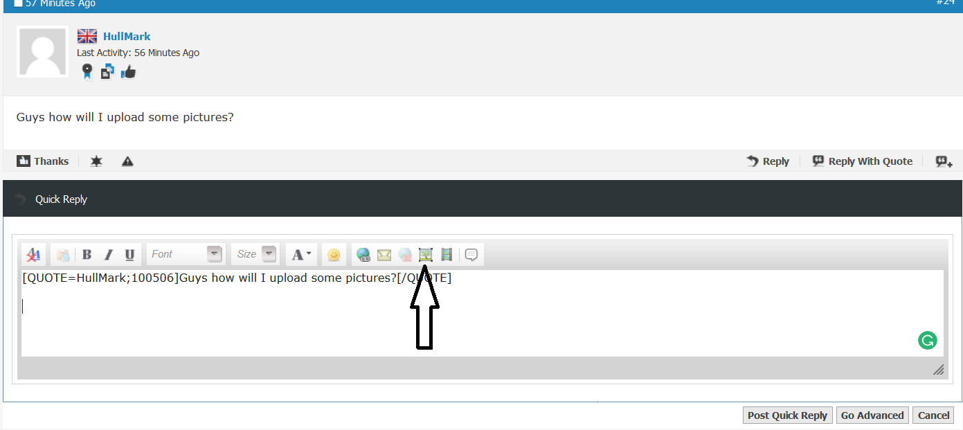

    Guys how will I upload some pictures?
  7. #25
    Quote Originally Posted by HullMark View Post
    The app has a wee photo symbol, click on it
  8. #26
    Quote Originally Posted by malcolm01 View Post
    Like so
  9. #27
    Start post Click on this icon in pic. Then on "From Computer Tab" Then "Browse" select pic then click on "Upload files" writing.
