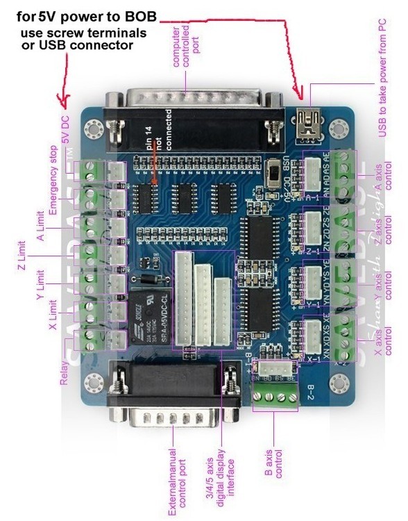

    the Chinese BOB can be powered 2 ways
    either via the USB connector or
    connecting a 5V power supply to the 5V input screw terminals
    the switch selects which powers the board

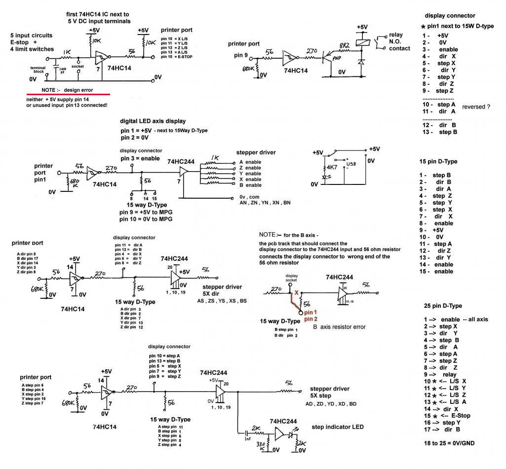

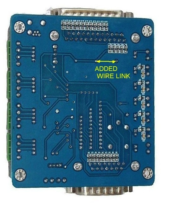

    note :-
    the input circuit for pins 10 to13 +15
    has an design error the 74HC14 is missing the 5V supply to pin 14 !!
    adding a wire link to pin 14 on the adjacent IC solves the problem
    John
