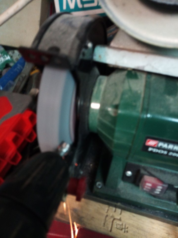

    I use the 20mm Hiwin rail and had to grind the allen bolt heads a little so they can sunk in the rails with out problem, I know it is time consuming but i couldn't find bolts with the proper head diameter to drop in there .If you look close at the photo, I place the bolt in the chock of a cordless drill and spin it, while I push it on the grinding wheel, this make the bolt head diameter to be evenly grind.

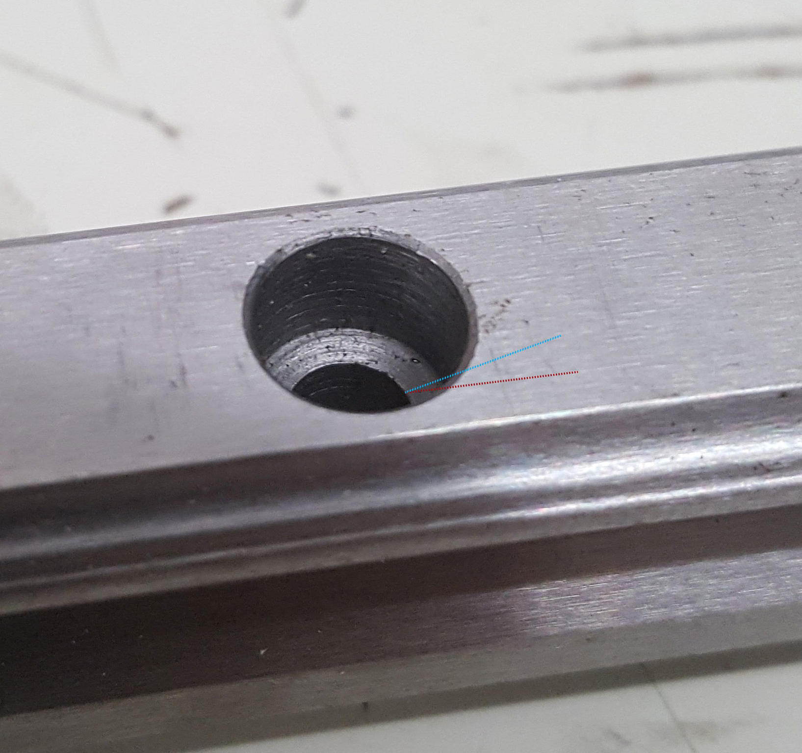

    Here is a photo of one rail (click to biggy). I don't know if you can tell that the bottom of the hole is not 100% flat, it has a very gentle chamfer, like it was drilled rather than milled out with a flat bottom end-mill. I think it is less steep than a standard screw countersink, but also not 100% flat.
    I think what I'll do is just use a soft washer under the screw head to allow it to seat nicely.

    The holes are not countersunk. Use standard 4mm socket head cap screws.
