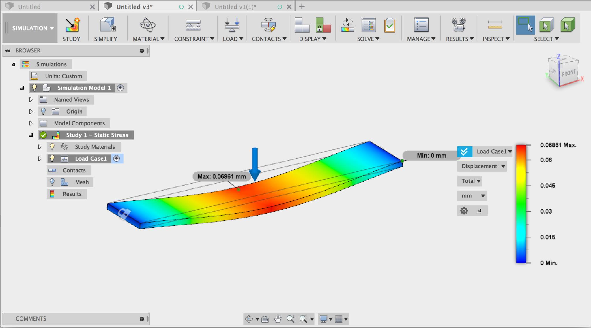

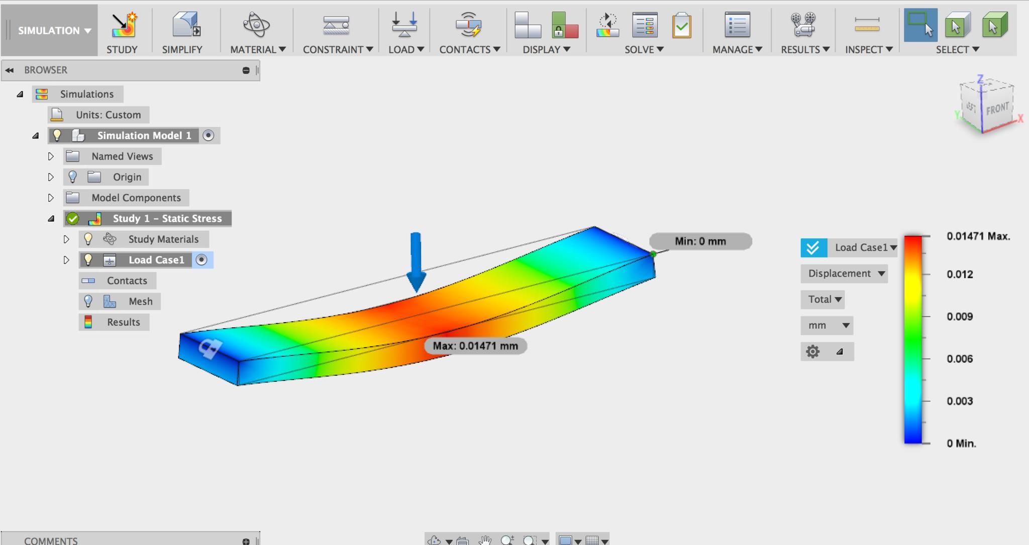

    Just out of interest, took your dimensions and applied a load of 200N to mild steel and 6061 alu:
Name:	Screen Shot 2017-12-17 at 20.14.15.jpg
Name:	Screen Shot 2017-12-17 at 20.14.00.jpg
    10mm Steel deflection = 0.06861 mm
    25mm Alu deflection = 0.01471 mm
    So according to that simulation, the 25mm alu would deflect less.

    That is amazing! Totally opposite from what I thoughtModulus of Elasticity. I have the 25mm aluminium, but thought I'd be better buying steel. Excellent news. Thanks for you efforts- totally appreciated.
