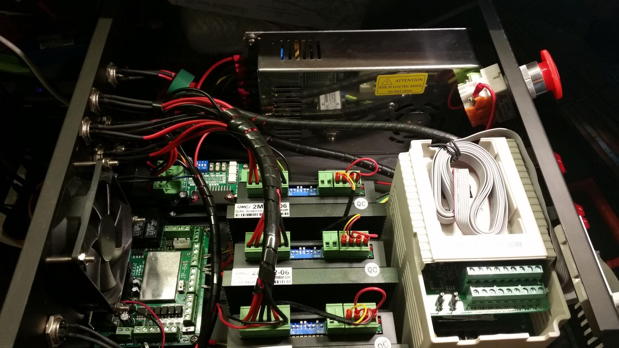

    I have a 6040Z 4 axis machine, which has worked well for the past year or so. I decided it was time I controlled the spindle via Mach3, but am having problems.
    The control box has JMC 2M542-06 drivers for the X,Y and Z axis and a small generic one for the A axis, with a JP-845 four axis control board. All four axis work great, no problems there, and a Nowforever EN100S2R2B VFD.

    The VFD connections I would use are X1 - Fwd control, AN1 - 0-10V for speed contol and COM

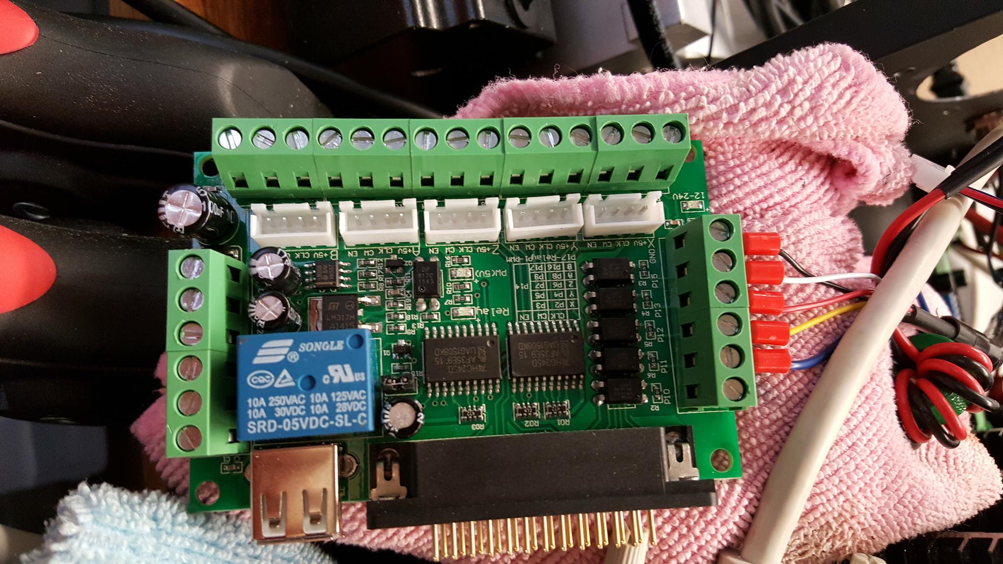

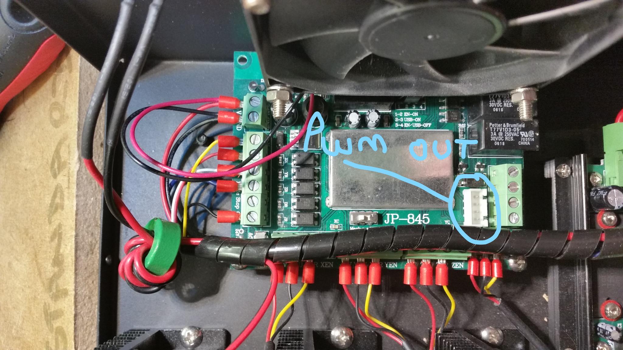

    I have two different BoB's that I could use;
    The JP-845 (image attached) has an unused PWM out socket on the board and what appear to be two relay outputs. The PWM pins are unmarked, and with a DMM I have found two of the pins have a constant 5V across them, while the other two don't seem to do anything. The relay pins are marked No.1, COM, No.2, COM.
    No matter how I connect the pins up, I cannot get this to work - the speed of the spindle is not controlled by inputs from Mach3, and the spindle is constantly energised.
    I cannot find any info regarding this Bob on the net.

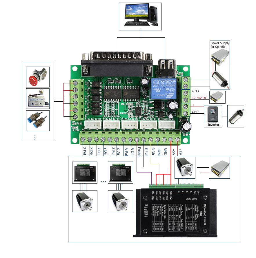

    The other is a generic 5 axis BoB (image attached). I have connected this up, and everything works except the spindle control. I have the AN1 0-10V connected to the + pin on the board and the COM to the GND. The X1 (FWD) pin is connected to pin 17 on the board.
    Now, this is where I am stuck, and probably being really bone - I don't know if I need the relay jumper on or not and, in fact, whether this is the correct way to do it. I have read several posts where people have linked to this second board, saying they use them, but there are no connection details/
    Could someone help me out with this please, I'm going nuts!

    Thanks for that, it has a lot more info than the manual I had.
    I'm still not entirely sure if I have it connected correctly or not
Name:	Screen Shot 2017-01-14 at 19.55.57.png
    I have the X1 (FWD) wire from the VFD connected to pin 17
    I have the COM wire connected to the GND port on the board
    I have the 0 - 10V wire connected to the + port on the board

    Second board has a bug, Ou need to have both power supplies to use all functions. I used diode bridge and condensator to get 12 volts and phone charger to get power to usb port :)
