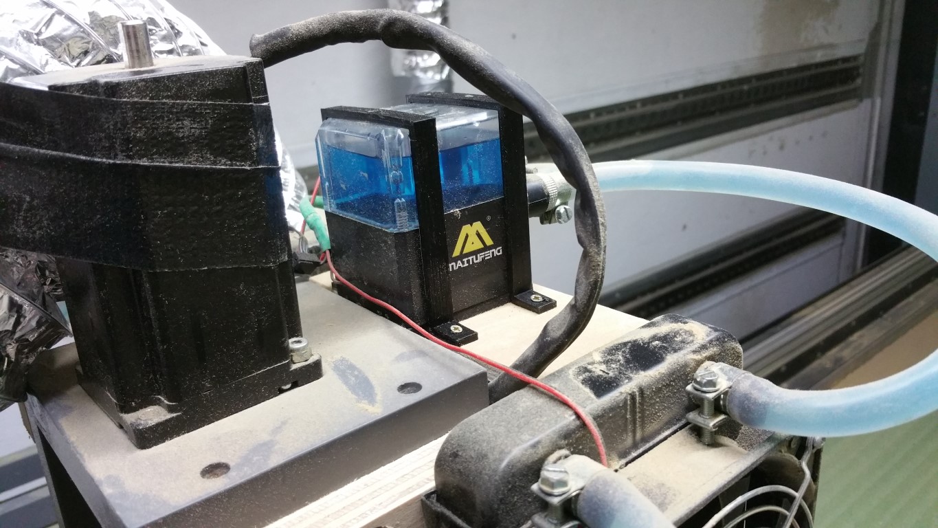

    So radiator cooling is on and working :) and limit stops printed and fitted.

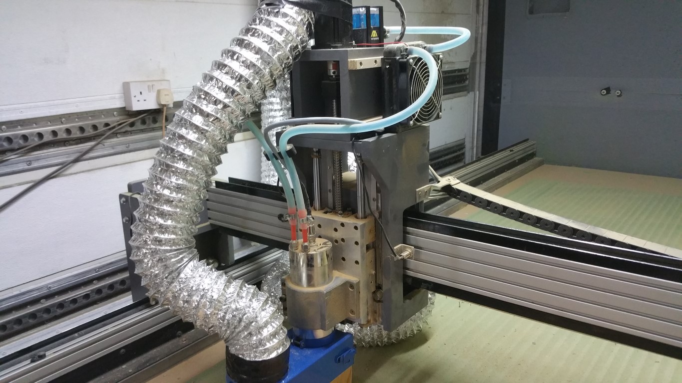

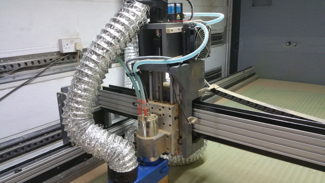

    Well I've not posted for a while and now i think i'm finally finished!
    Got rid of the masking tape holding various wires and also 3d printed some mounts to hold the water pump:)
    Wasn't impressed with my dust shoe so just bought one in the end and for £20 it catches all the dust so job done!
    One other thing I've added is another breakout board as i ran out of inputs to add an auto Z touch off plate- so ticked that off as well- also means i can add another 5 axis if i should ever need to! lol (although a 4th axis seems fun!!)
    Just an arm left to make to carry the dust hose
    So here are a few pics of it now.

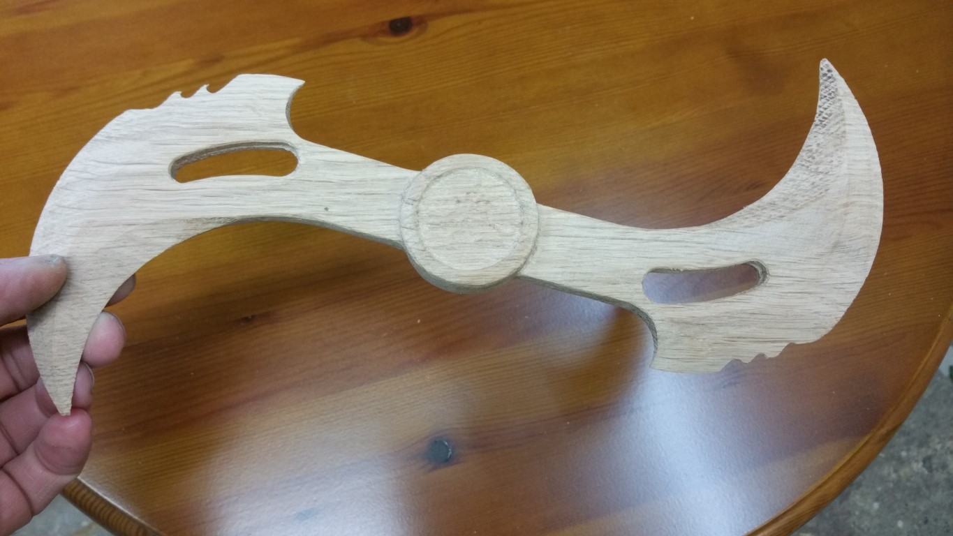

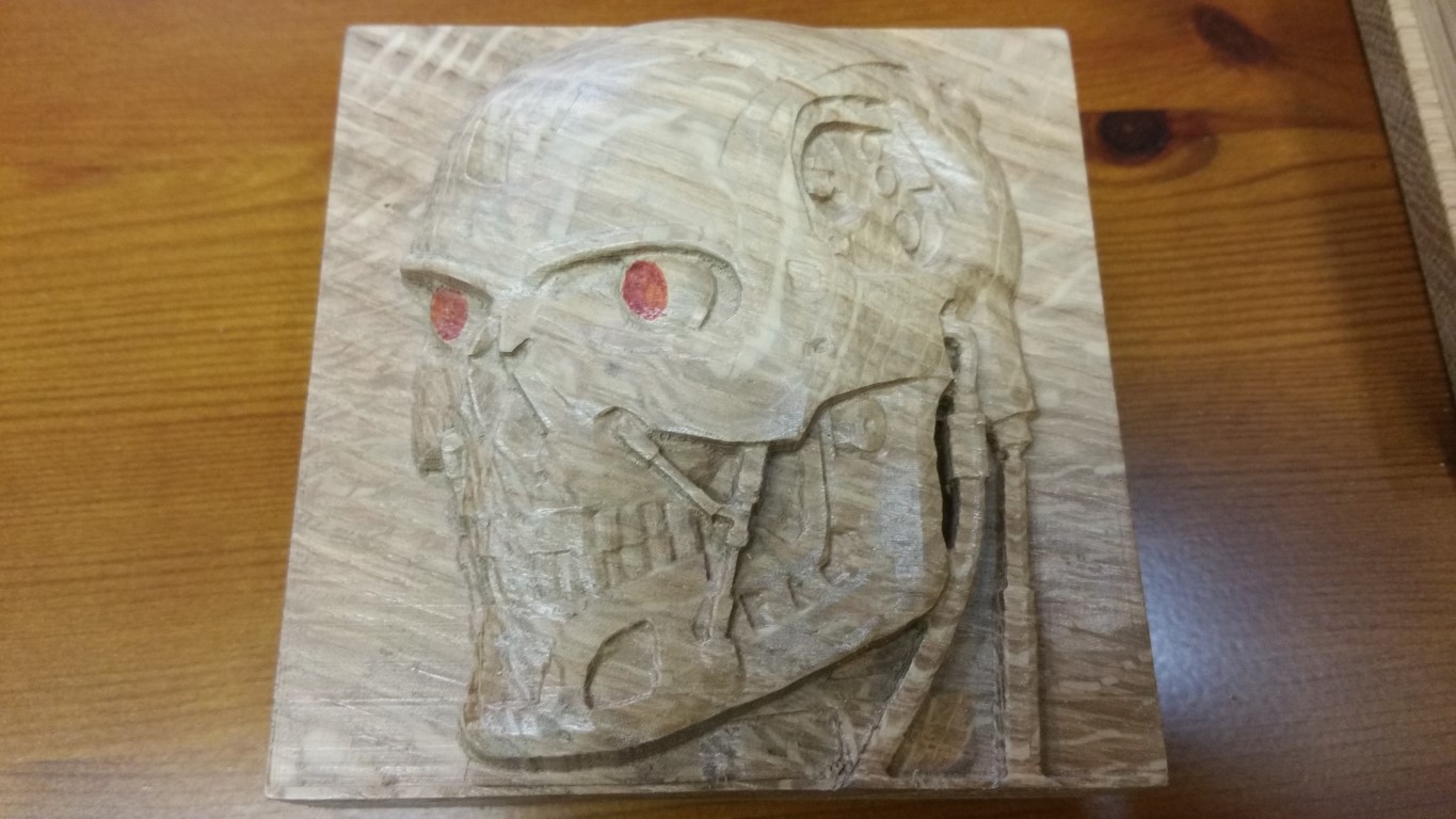

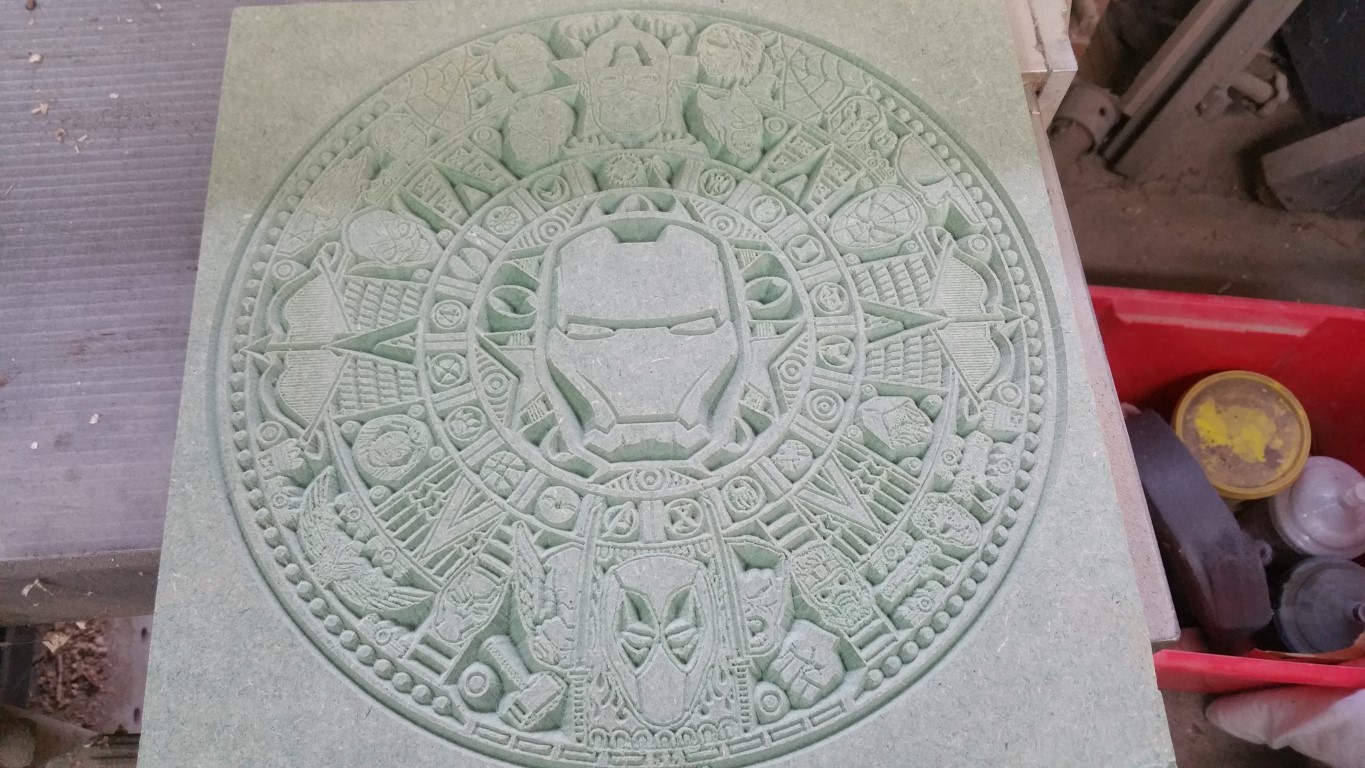

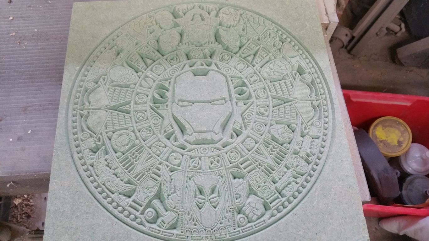

    just a few things I've made so far -still learning ...or playing:)
    thanks for everyones help up til now :)
