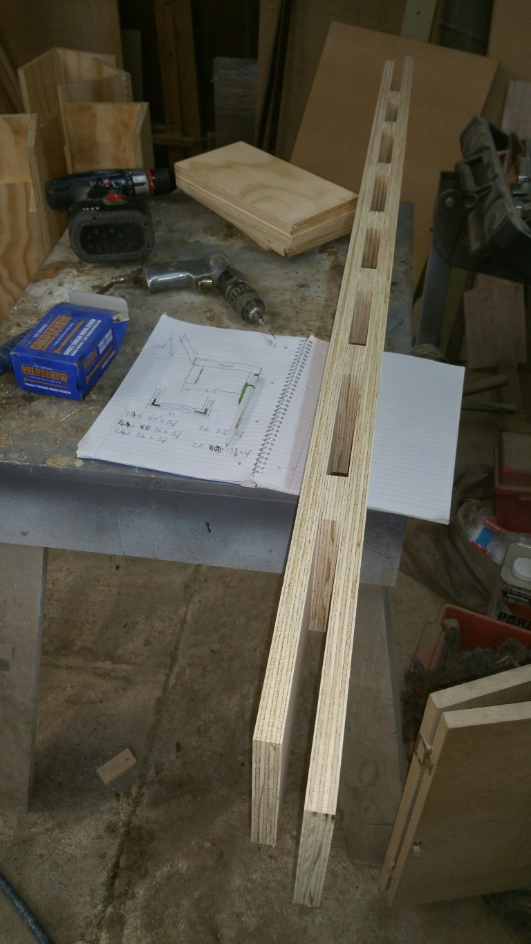

    The plans suggest a welded steel box frame base ,but as I don't weld I opted for a timber base.
    Constructed out of structural 18mm ply ready to take the aluminium rails when they arrive.

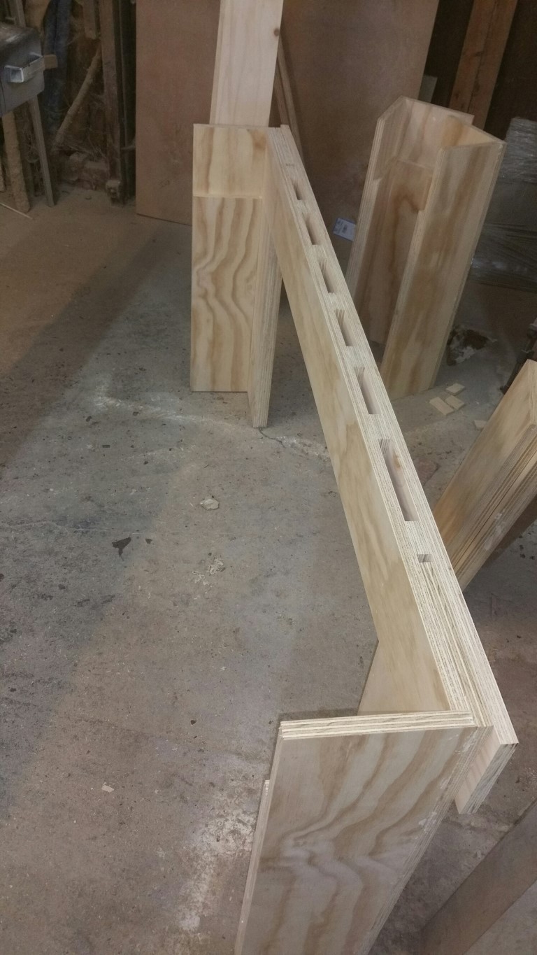

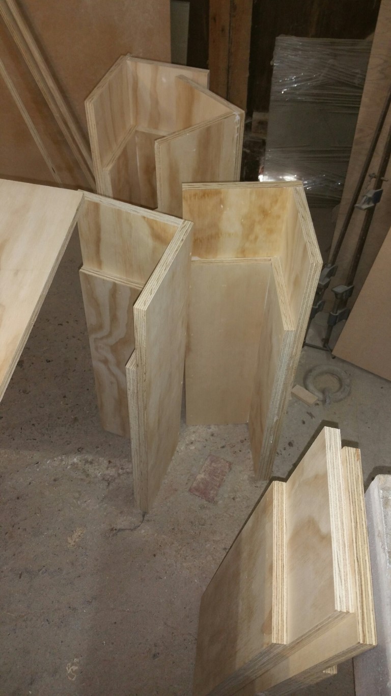

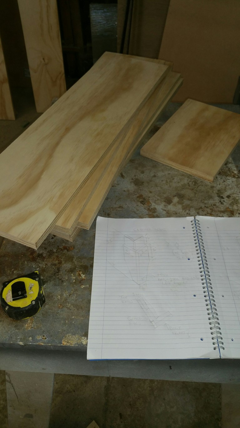

    As you can see I doubled up on the ply thickness and the box section rails really improved the stability and strength.
    The rails fit together like mortice and tenon joints, the long sides are glued to the legs.

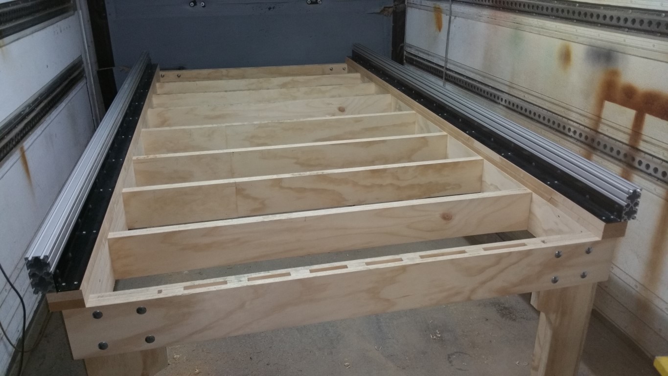

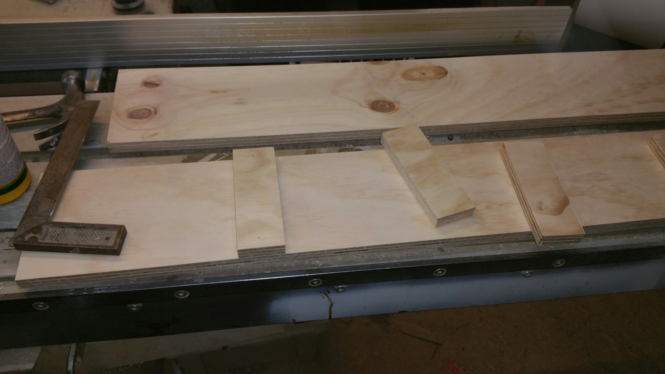

    The side rails are 10ft long so I extended them on opposite sides at the ends.
    The width is 5ft.

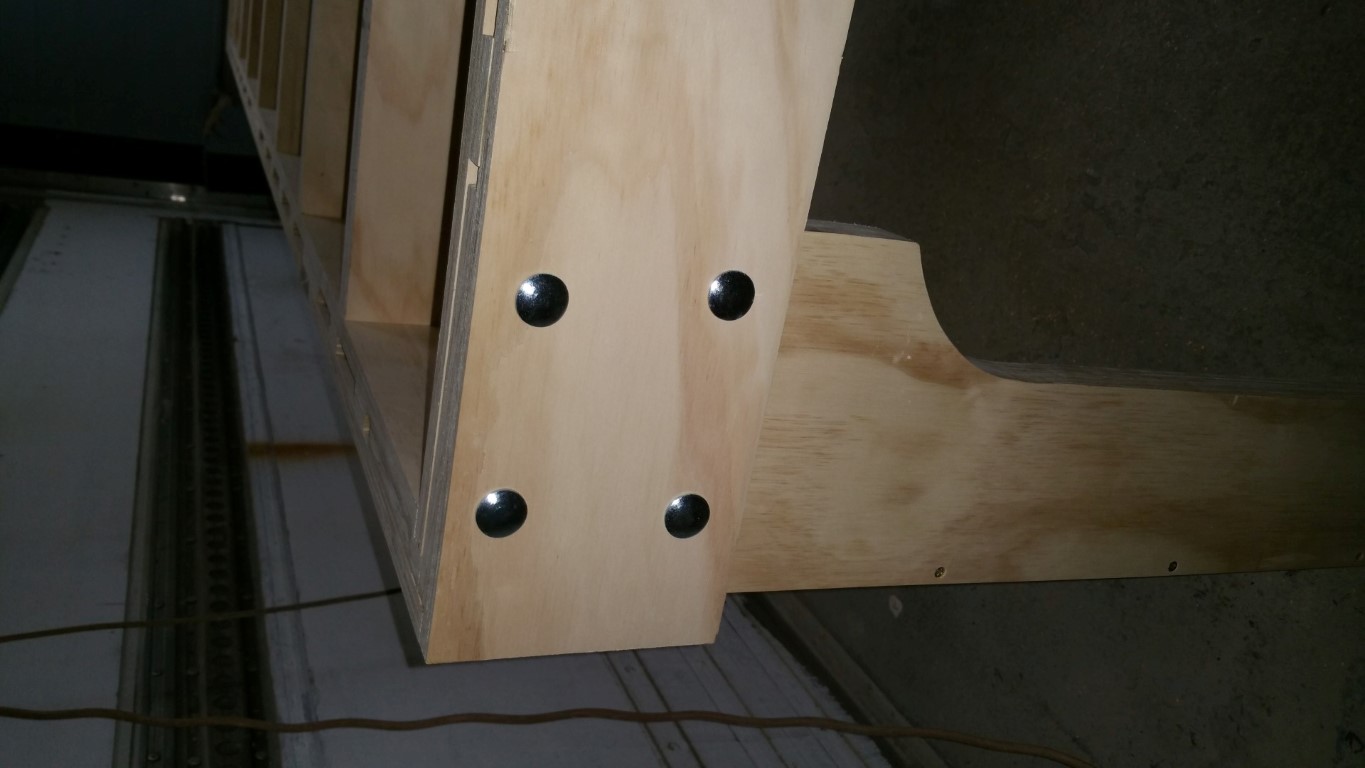

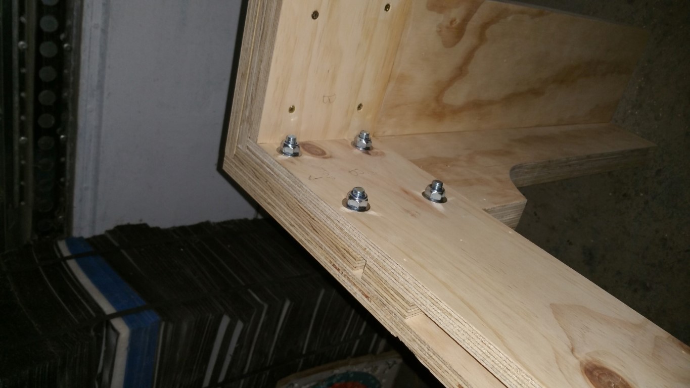

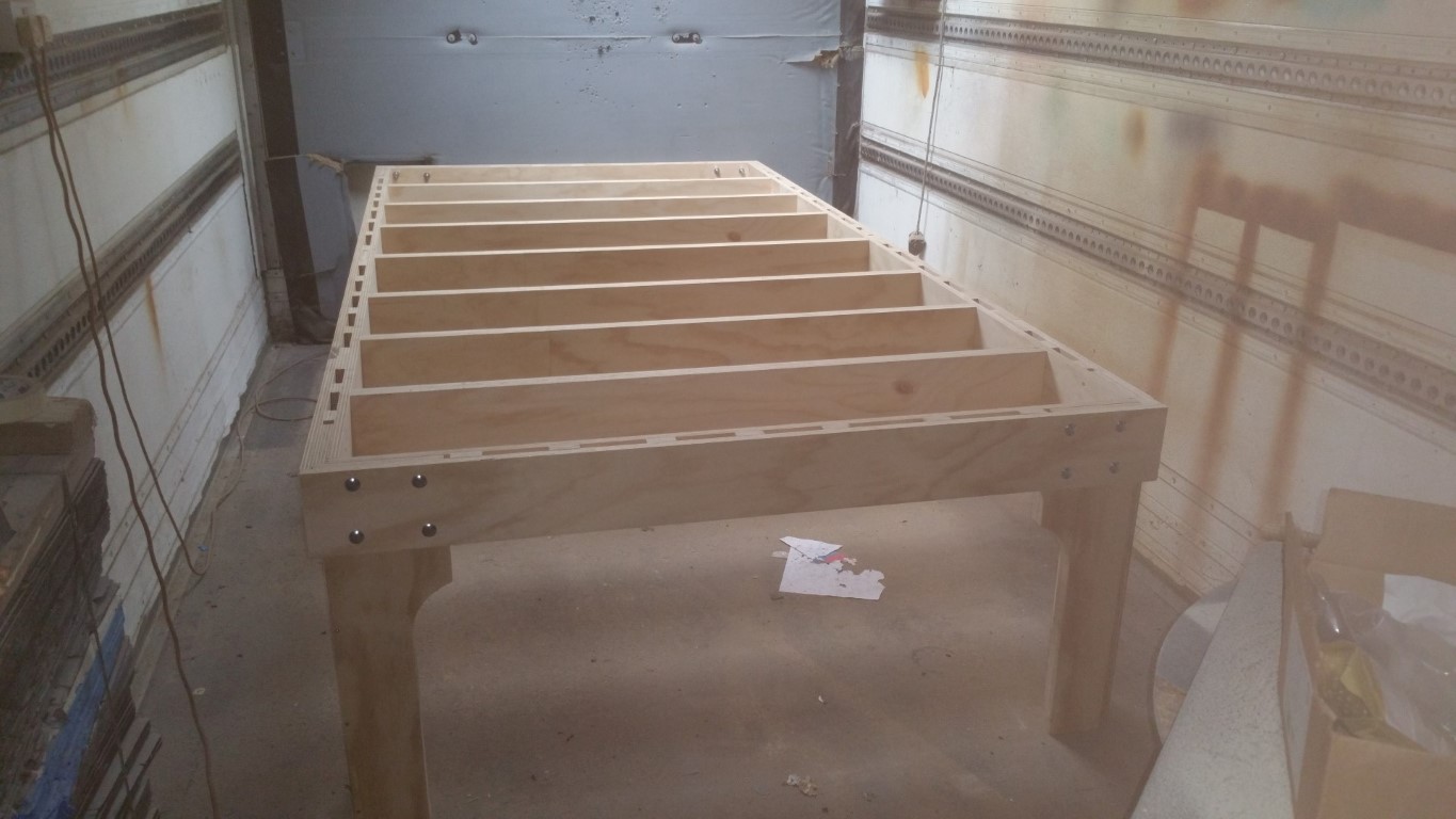

    I again doubled the ply for the cross rails and screwed them in dry so take down is possible for relocation if needed.

    The front rails are bolted with nylock nuts.
    I also scooped the front rails to allow an 8x4 board to go between the legs for storage, still need to add some rails yet.
    With a few sheets stored under there is should add some considerable weight.
    The legs have screw adjusters on them for levelling.
    So that's where I'm at now, I have some aluminium profile on order which I'm hoping will be with me soon.

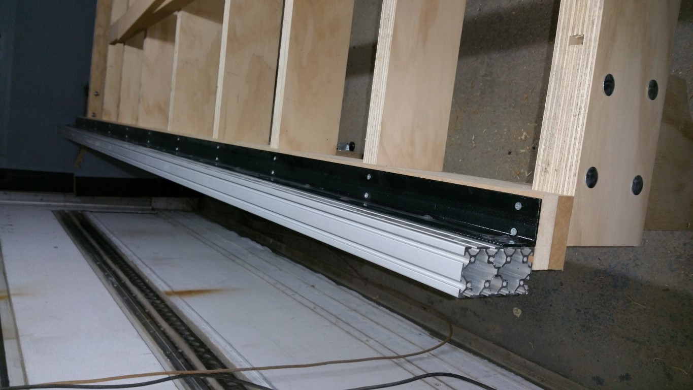

    So after my rails apparently having had a tour around England before reaching my supplier, I finally managed to pick them up Wednesday ... a 9 3/4hr round trip:(
    So busy day today fitting them:)
