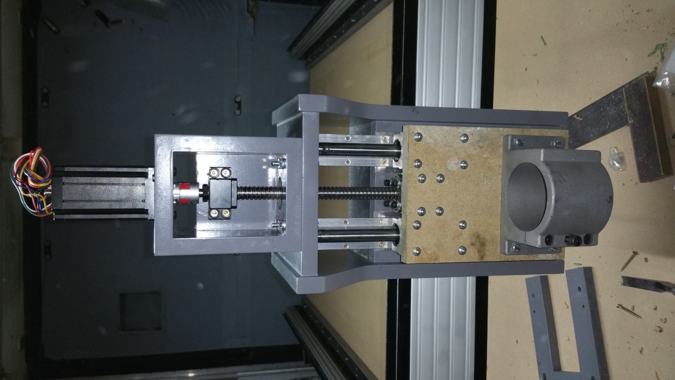

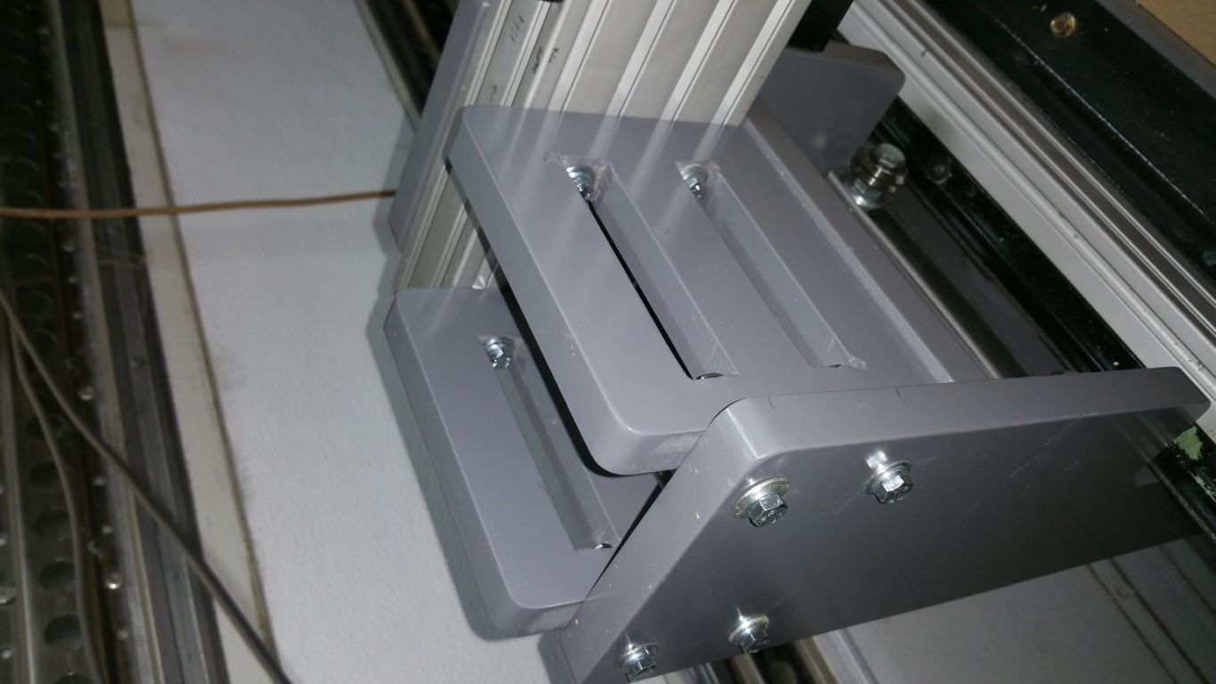

  2. #42
    So I finally got my Z axis done
    Will probably swap out the MDF that the spindle is mounted on for some Ali plate at some point.
    Added end supports to the x axis mount points for added stability.

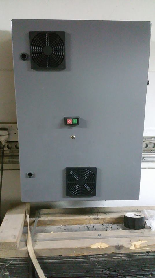

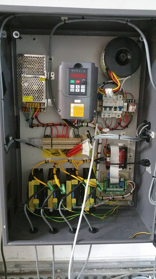

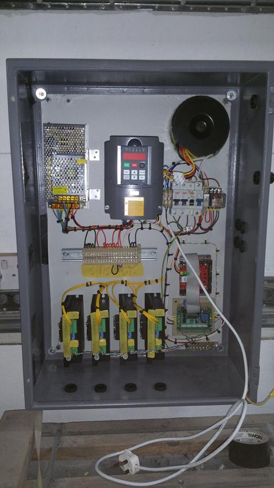

  4. #44
    So panel is back and thanks to Jazz for the wiring diagram, my mate sorted it out a treat- a million miles better than my effort would have achieved !!
    Mounted on the wall and fitted the fans to the front panel.
    I added a start/stop button by mistake -actually not needed- so i'll probably turn it into a window so I can see the VFD front.
    I've been told I can wire up the other things but I'm not allowed to turn it on! lol or even plug it in!!
Name:	panel front.jpg
ID:	24437Click image for larger version.
Name:	panel inside.jpg

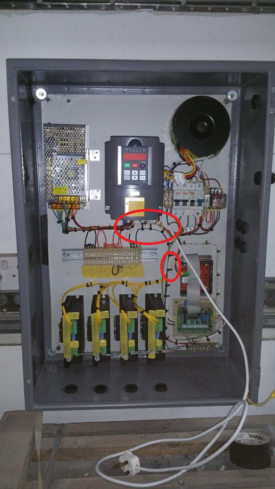

  5. #45
    Hi Graham your mates made a nice job of the wiring etc but you need to re-route and separate some of the wires otherwise your probably going to get false E-stops etc from back EMF.
    If he's general sparky he'll not be used to dealing with machine controls where tieing or routing together signal wires with high voltage wires is a BIG No-no.
    I've circled the picture where I see potential trouble areas because signal wires are tie wrapped to high voltage or too close to VFD which gives off high EMF.

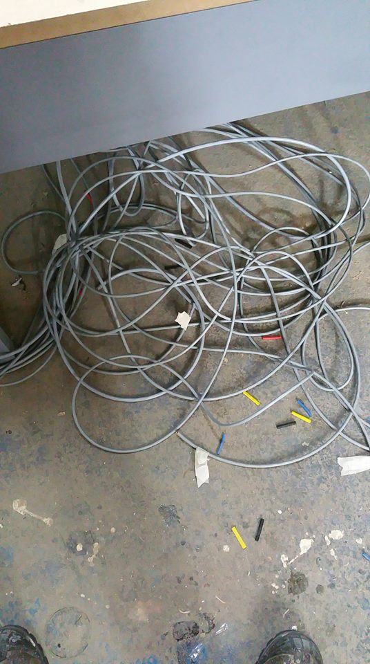

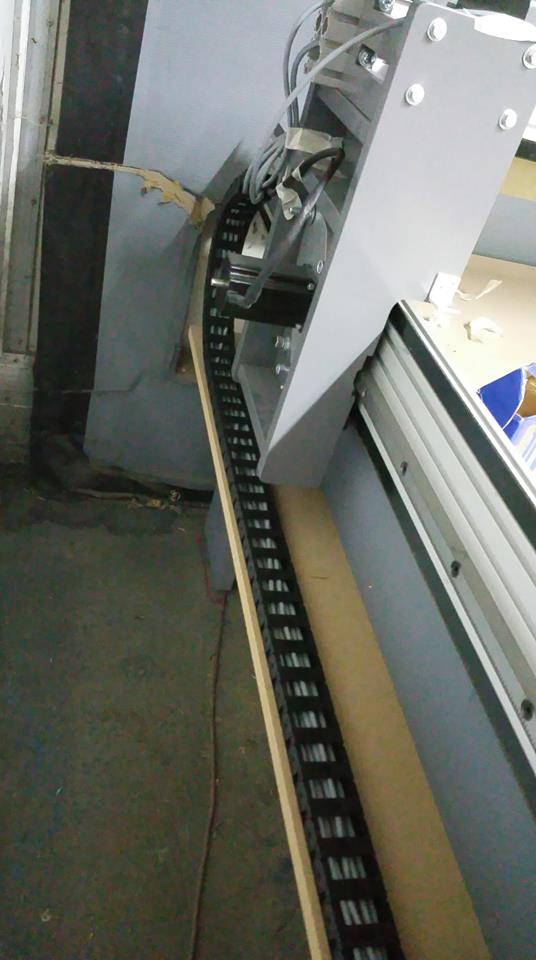

  7. #46
    So a bit more work done on the electrics
    Drag chains fitted
    Leaves a nice pile to sort out :)
    A quick route to the control box
    And then some cutting, soldering and attaching...
    Still have the drives unplugged as not had the nerve to plug it in yet, need a quick recheck first.
    Whats the next step ? attach to computer and switch it on ? or are there some other steps first ?
    Still got to re-route some wires in case it causes issues.
