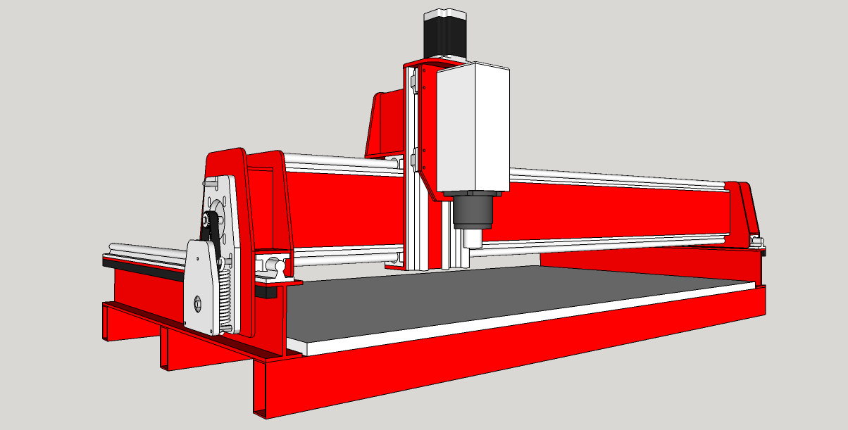

    Planning to build a gantry type machine. Before the construction goes on, would like to know the opinion of specialists. My machine has a beam of 2 meters long. What would be the most appropriate profile when you consider that the spindle weighs 12kg.It should be fast sheet cutting machine - the cutting speed of about 10000 mm/min.
    Thanks,
    Kalle
    I use TBR20 rails.
    There's a spreadsheet here that might help, you need to study it for a while first.
    http://www.mycncuk.com/threads/2023-...3797#post13797
    You don't want to be using the C channel, it twists too easy.

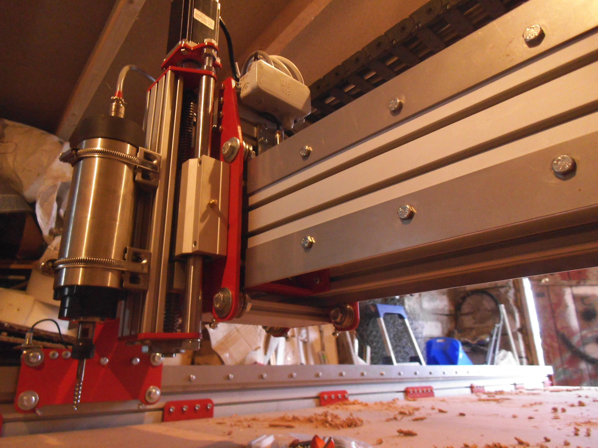

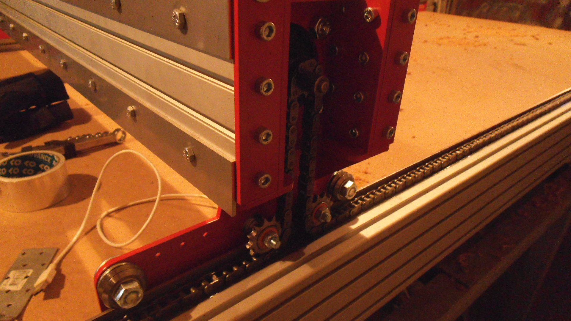

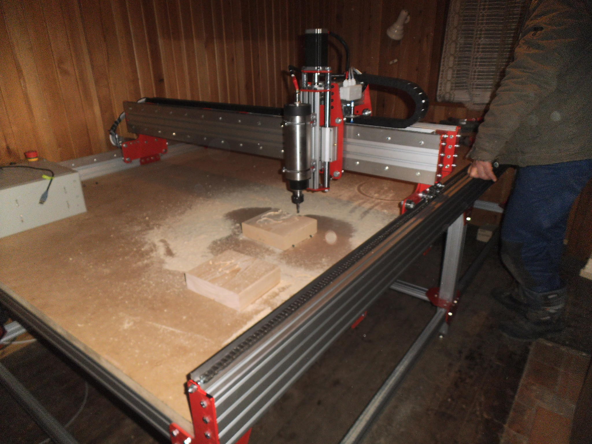

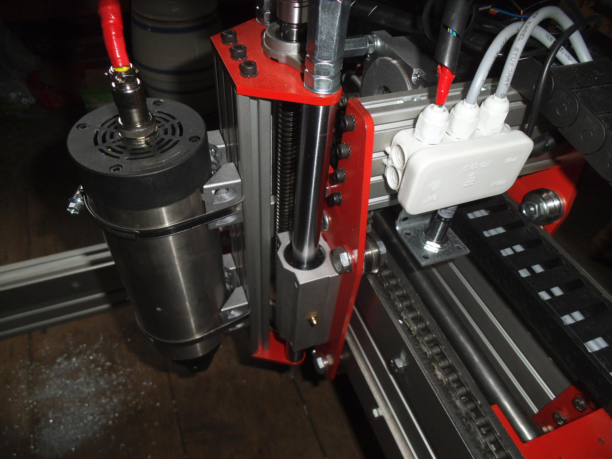

    After 3 year testing, building im find best solution. Simple, light and not overpowered. Cutting area 1250x2500.
