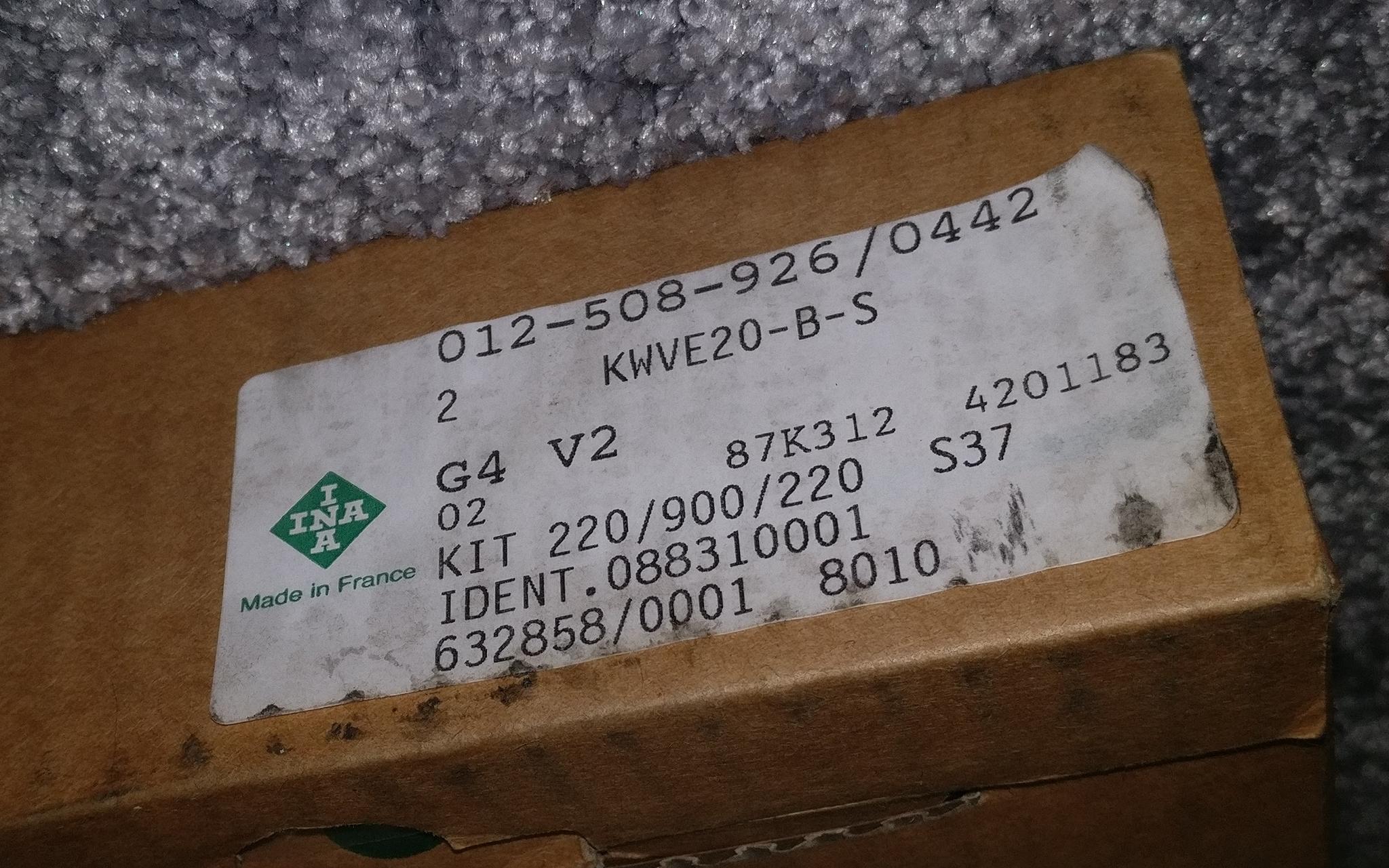

    Thirdly I recently had a machine decommissioned at work sad part is I wasn't able to take parts for myself but was able to take the spares, the main part that I was able to source from this was.
    Now does anyone know where I can get the rails to suit them and I have 6 is that enough to do the x and y-axis?

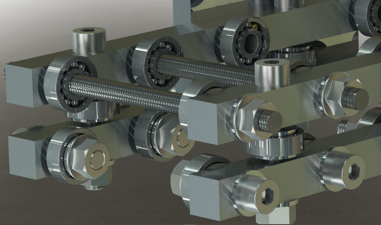

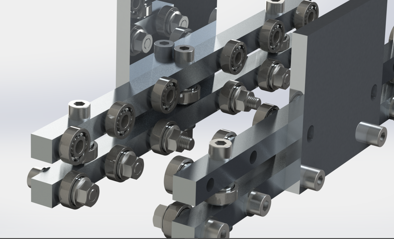

    alternatively, I have designed my own.

    I know people have made linear bearing like these but to what success.

    Q3: what's in the box? Linear rail carriages? I've not found someone who will supply rail to match someone else's carriages.
    In the past I used bearings for guides similar to your sketch but they were not the best and needed adjustment and TLC. Supported round rail will be much better or most people end up with proper linear as this is a real fit and forget solution. Get a quote from Fred at BST automation on Aliexpress.
