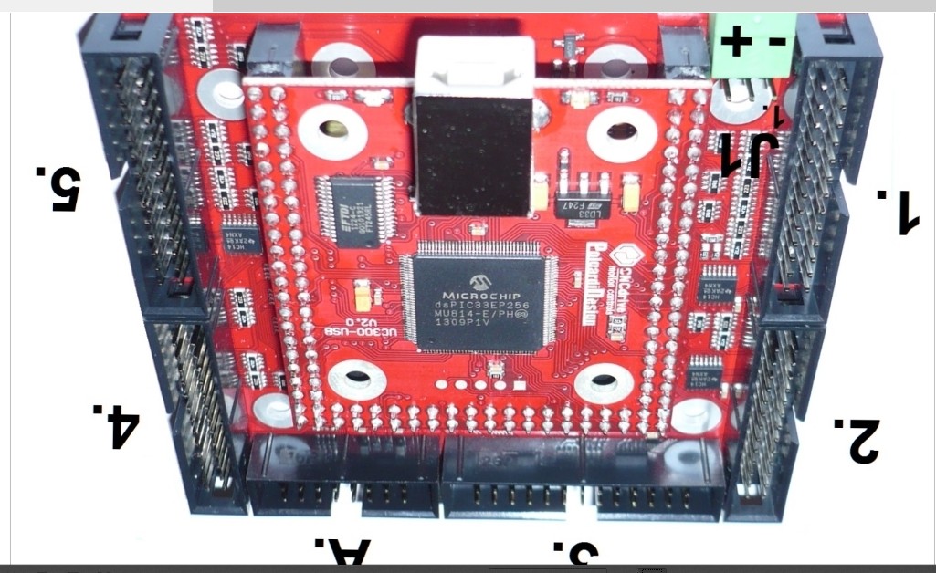

    any one know which micro controller has been used for the UC300ETH ?

    I would guess the UC300 is using some form of ARM chip, regardless I'd guess whatever chip will be running at 3.3V. Even a few years ago, the vast majority of microcontrollers were running at 3.3V max, with 5V capable ones being a dying breed.
  5. #65
    m_c
    your correct the micro controller is a 3.3V device
    looking at a photo of the UC300 it has a
    MICROCHIP dsPIC33EP256
Name:	UC300 PIC chip.jpg
    from the MICROCHIP web site
    Operating Voltage Range (V)
    3 to 3.6
    the dsPIC33EP256 Input/Output
    • Sink/Source 10 mA on All Pins
    • 5V Tolerant Pins
    • Selectable Open-Drain, Pull-ups and Pull-Downs
    • Up to 5 mA Overvoltage Clamp Current
    • External Interrupts on All I/O pins
    the UC300 board has a 5V supply connector
    so the surface mount device between the 5V supply and PIC
    must be a low drop out 3.3V regulator
    John
