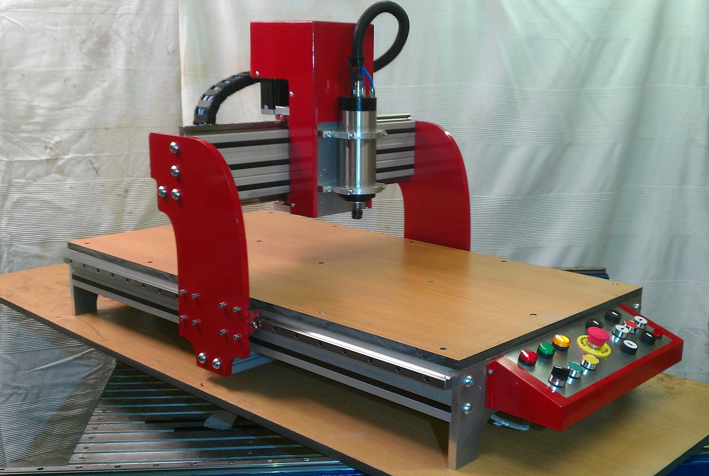

    They where never intended to be informative but purely to show difference Digital drives made compared to Analog. The spec is irrelavant in this case because nothing changed other than Analog drives where swapped for Digital.
    However there was little more to it than just that.?
    The machine was Originally built as favor to help new forum member who had very very tight budget. It was actually mostly built by Clive S using my design and little help from me regards machining etc and with spare component's we had laying around left over from previous builds. However the member Hit hard times and pulled out leaving Clive S with the machine which I then took over and upgraded to pass on to a customer. Hence why the videos are in different locations. This was the end result See pic.
    The Original control box used the parallel port (Mach3) because of budget and was also housed in MDF box to save money. Obviously I couldn't sell it like this and won't use PP on anything I sell so new Control box was built. This gave me the perfect opertunity to see what difference individual components made.
    So Orginal spec was 35Khz PP thru cheap BOB with leadshine M752 Copies(400Ms) spinning 3.1Nm 4.2a steppers with aprox 55-60Vdc. 10mm pitch screws.
    This setup actually struggled to reach much past 4700mm/min.
    So the first change was to swap out the PP for Cslabs IP-M 100Khz controller. This allowed the same setup to reach just over 6000mm/min before the drives couldn't handle the resonance and went into melt down. Next change was to adjust the Micro steps with the intent to move the resonance around, 800ms gave best performance of little over 8000mm/min before stalling occured.
    The next change was the Am882 with 1600Ms which instantly transformed the machine into an Animal. The Max Rapid velocity with 1000s/s Acceleration was actually well in excess of 20mtr.min but it ran stable at 15000mm/min and would cut at this if required in certain materials, it happily surfaced the bed at this speed. The Actual Velocity and accelration was dropped to sensible 10M/min with 1500s/s acceleration for the customer who was new user.
    Hopefully this level of detail meets your approval.
    Note on the letters DM.!!. . Just because some Chinese Ripoff shop sticks DM on the front doesn't make them the same DM drives sold by leadshine nor does it mean they have same technology in them.
    Leadshine DM are lower range of Digital drives the D identifies this. There Analog drives just used M. ie: M542 or M752. You will see loads of cheap knock off drives with DM or DQ before numbers but most are Analog not digital.
    The AM and EM series are more advanced Digital drive and the AM have been superceeded by EM series and are just now becoming harder to find but still about. The EM are current and to be honest having used many sets there is very little difference between them. EM are Slightly smoother at lower RPM's but other than that no difference. So much so I've even mixed AM and EM on same machine, my own, and see no difference when using.
    Whether you want to accept it of not the real truth is that Digital drives like the AM or EM are massive improvements on analog drives which transfers directly to very respectable performance gains even on the most well built machine with huge improvements in some cases because of there advanced resonance handling when using motors that are not exactly best quality.

    Yes, I am using 5mm screws and I am not sure you are right about me being far from the speed limit. Perhaps it is possible to drive them a bit faster, but 10m/min is a very good speed, no doubt about that.
    Yes for Analog drives I agree that's very good speed, mostly made possible by fact small machine and well made by your self. But just for the record my very first machine which used 5mm pitch screws would spin well above 10,000mm/min and that was with 1500mm length screws and Gecko Analog drives so your little machine still as lot left in it trust me.!
    I KNOW that most eBay and DIY machines are not as fast as mine, even if I am not into the speed race and don't care much about bragging, but it is a fact that majority of DIY and eBay machines end up in the 4-5m/min maximum speed.
    Yes build quality makes big difference but your observations are not a good indicator because it could be just case that the machine is dumbed down lower and doesn't mean it couldn't go much faster if required.
    I've built many machine which could easily be tuned to travel at twice the speed I supply the user with, hence above machine, but in truth most are frighted to Jog or travel at these speeds and rarely can they cut at these feeds because they cannot clear chips fast enough.
    That's me done with this topic now but to all those looking for drives then stay away from Analog drives, Even the cheapest Digital drives are better than Analog and the price difference is nothing.
