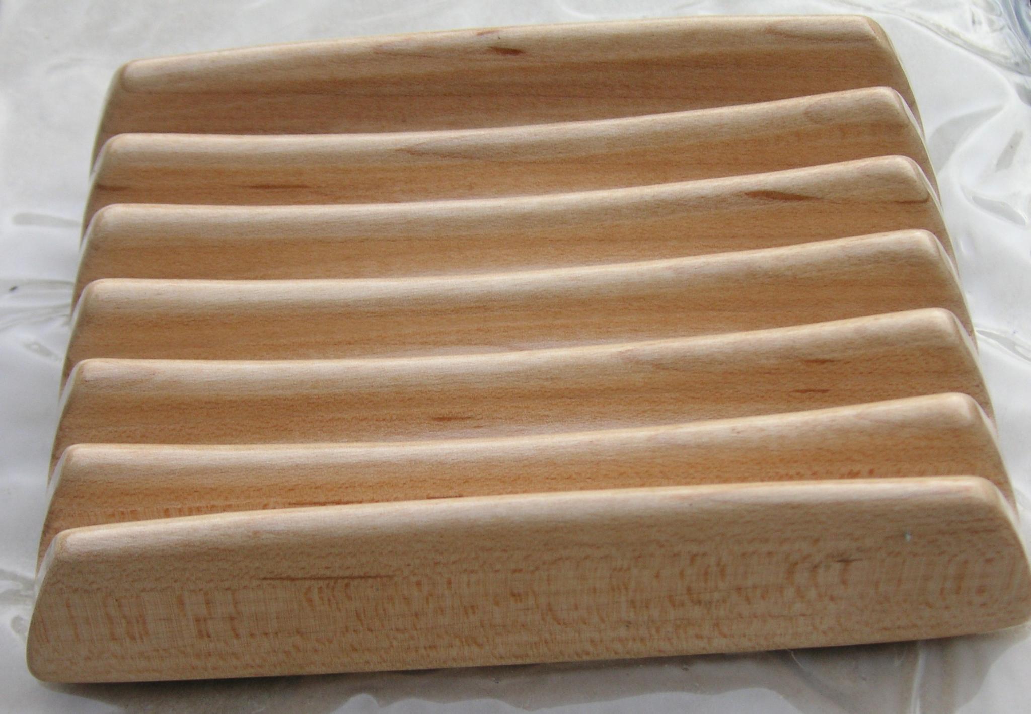

    Will you be making your newer model available to us, a bit of taper would help with the cutter choice and perhaps the look.
    Only got a 5mm ball nose long enough at the moment so will have to get a couple of long 3mm ones.
    I cut the Grunblau soap stand a couple of years ago.

  8. #7

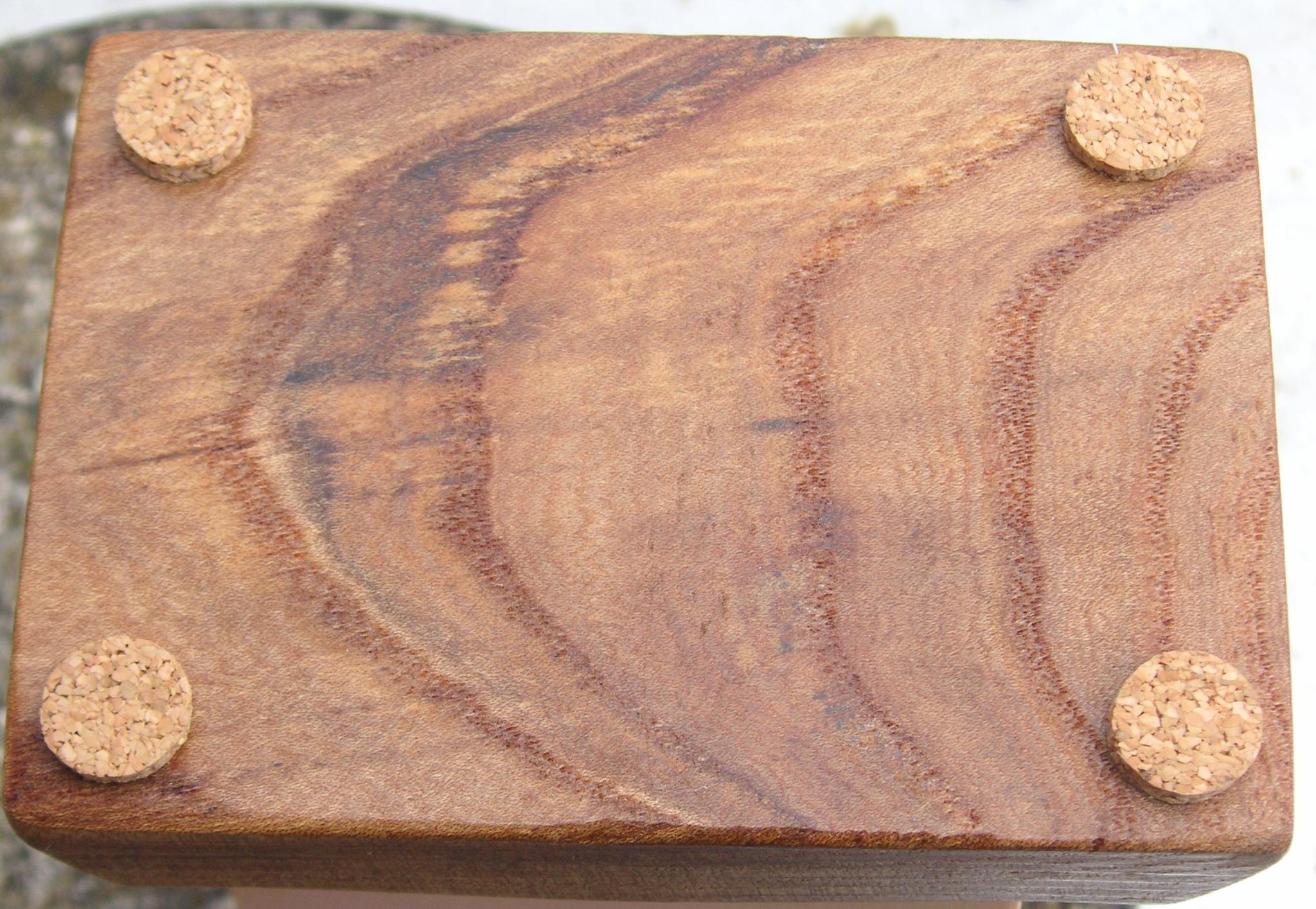

    Cut a pair in a bit of yew
ID:	24021Click image for larger version.
ID:	24022Click image for larger version.

  11. #10
    Left one, right one needs a bit of filling of exposed wormholes
    Attachment 24029Click image for larger version.
