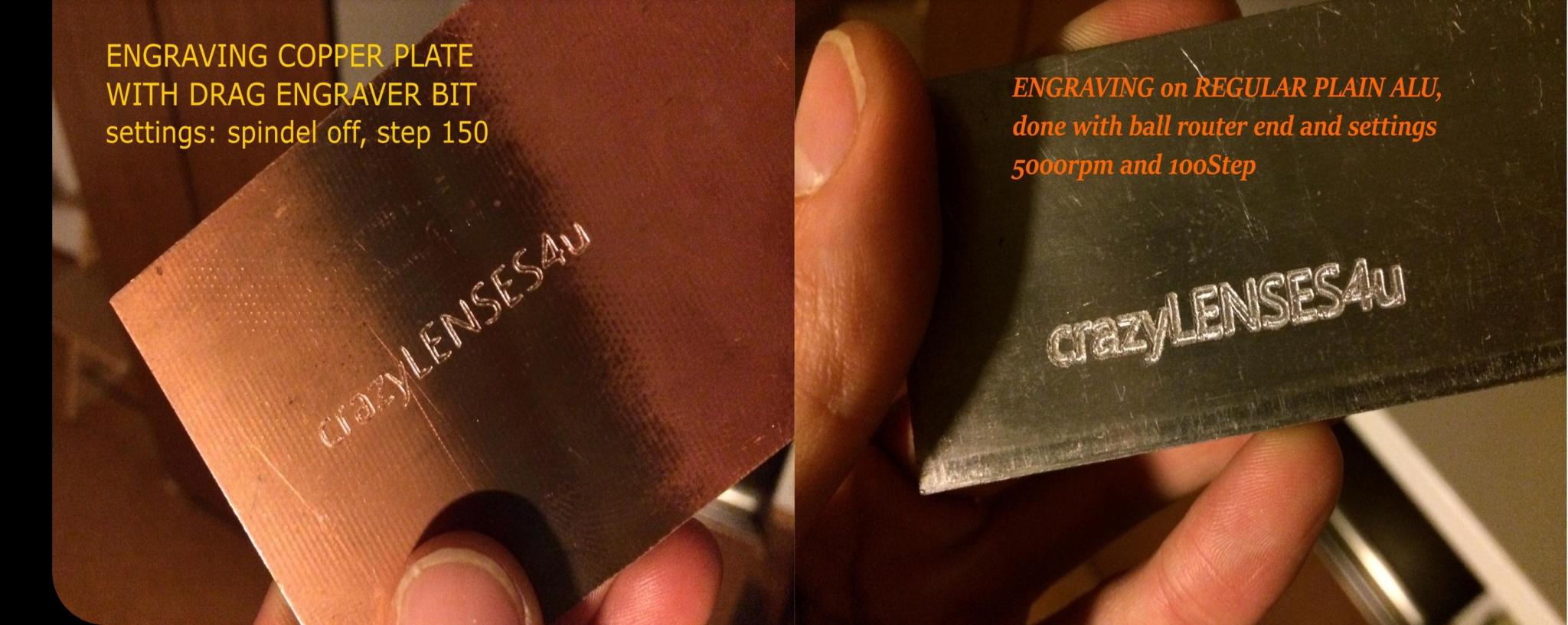

    Sorry to raise this thread from the dead, but it's 2022 and the links are mostly dead. dragengraving.com still functions but after emailing the contact address and getting no response I'm a little reluctant to order from them for fear of throwing money down a black hole. Any more recent suggestions?
  3. #23
    Well as would luck would have it: https://www.ebay.co.uk/itm/143161401121
    Send him a message as he doesn't have any listed at the mo, his are known to be good, he has options for both Diamond PCD and another type he prefers (cant remember what it was called now) that are much harder tips...
    or make your own holder/spring and order the Diamond insert tips only :), the eBay link above will show you other sellers selling they same sort of thing as well...

  5. #25
    Thanks Lee - been following up your suggestions although haven't succeeded yet. There are some that have appeared on eBay for about £35 so I might just take a punt on one of those to get me started.
  6. #26
    Info from his listing:
    This is my solution:
    It is a separate 3D printed tool holder, and in my case it takes any sort of tip up to 6mm shaft diameter. It works very well on any surface, including steel plates.
