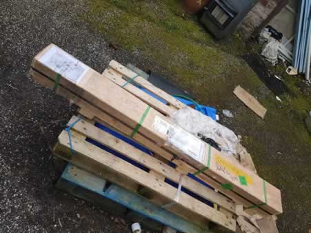

    So i've changed my mind and now aiming at just 4x4 foot cutting area for now.
    Ordered my rails n bits
  8. #7
    So they arrived eventually
    all looked good!

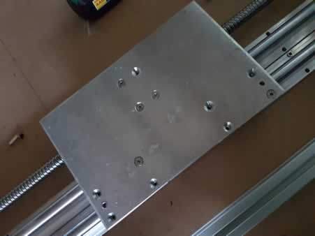

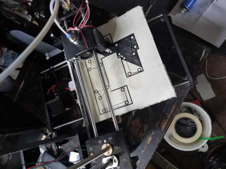

  9. #8
    Then after some dicking about i eventually purchased some sheet ali and made some plates.
    No not out of the 3d printer but i did use it to make my guide.
    what a fit!

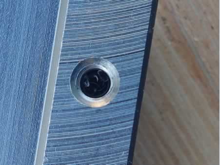

    so whats the 2 empty holes about??

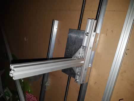

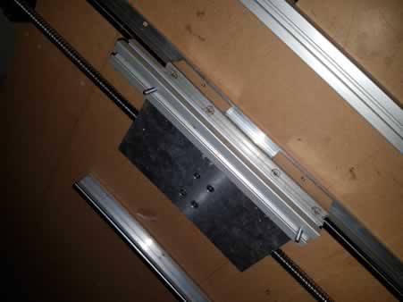

    attaching the ali profile!
