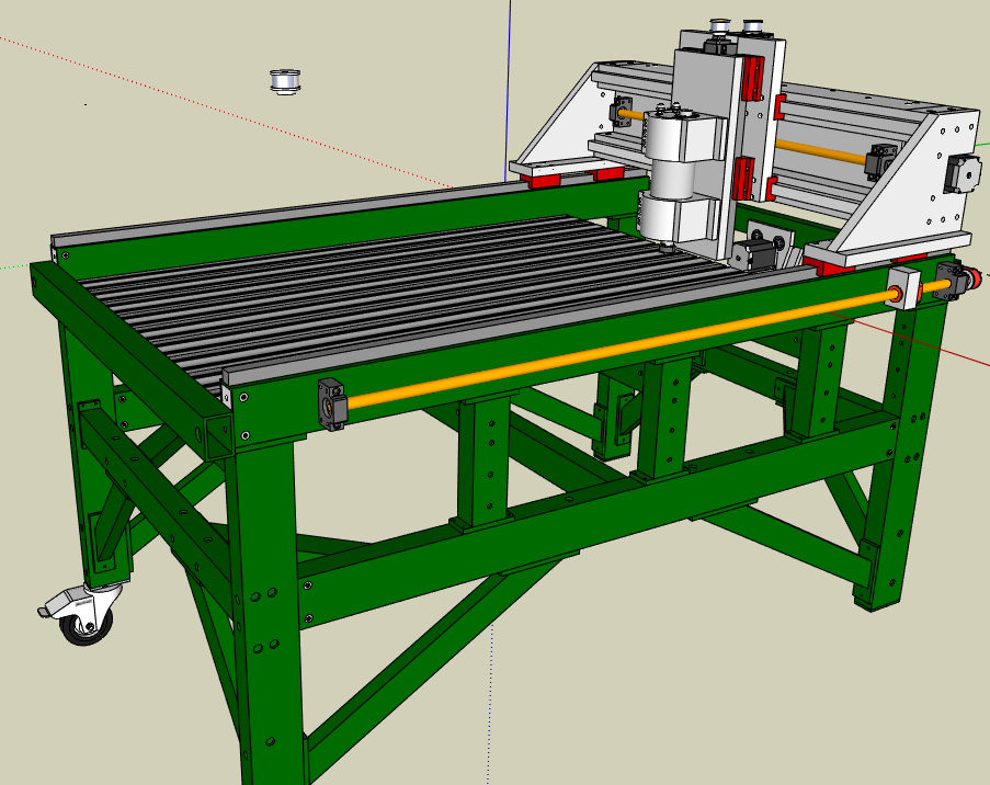

Hi Guys,
Where do you all buy the West systems Epoxy and hardener from and is there a handy calculator for how much I need? I have looked in the manual but it mentions volume with use of fillers which I wont be using. I just want to make sure I order the right amount as this stuff ain't cheap.

One more thing...... Can you check my calculations to make sure I'm right
2 rails 135cm x 4cm wide + 2 bridges @ 77.5cm x 4cm with depth of 6mm
(135+135+77.5+77.5)X4X0.6 = 1020cm3 = 1.02 Litres
1.02 Litres / 4 = 0.255 Litres 209 Hardener
@3:1 ratio by volume = 0.765 Litres of Resin.
Seems the weights are not quite 1 litre to 1 Kg as the manual states the ratio is 3.5:1 by weight.
Regards,
Charlie
